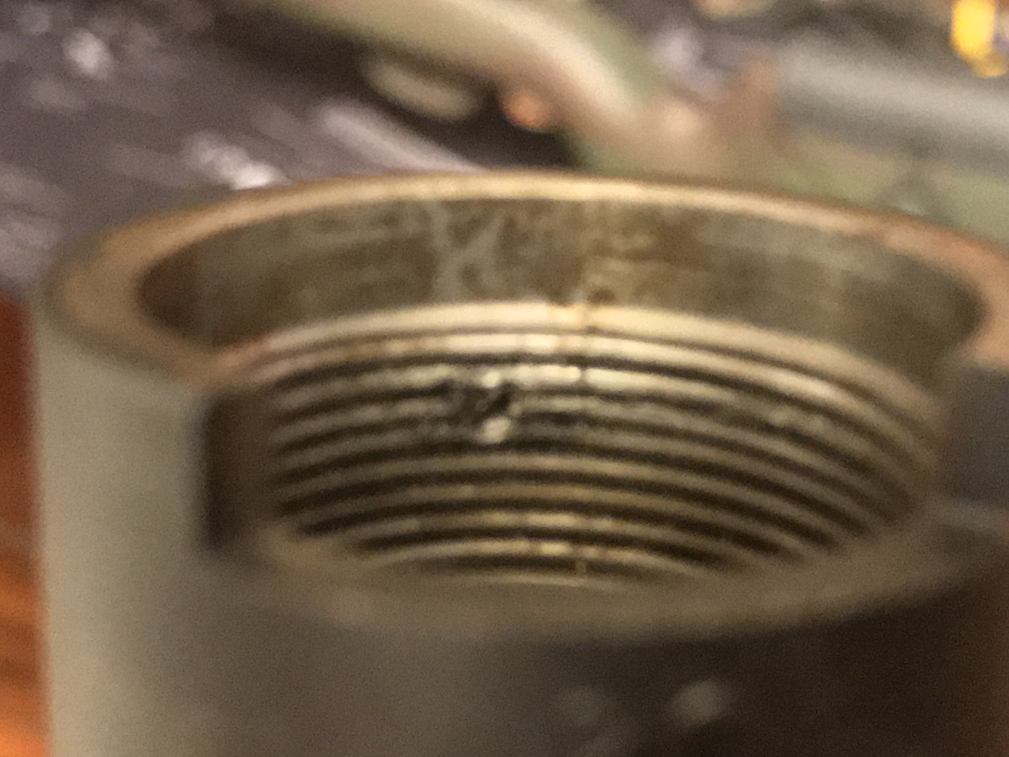

Regrettably I have to chase the threads a little bit before rebarreling the action. When the last person added a scope base rail, it came with two shorter screws that are supposed to go above the barrel shank. Well that’s not how they did it. One long screw up front, one in back. The one up front gacked the threads up a little when they removed the barrel, so have to touch that up a bit. I’ll attach a picture to show the damage, it isn’t real bad but could've been avoided with a little attention to detail. Also I apologize in advance for the photo quality.

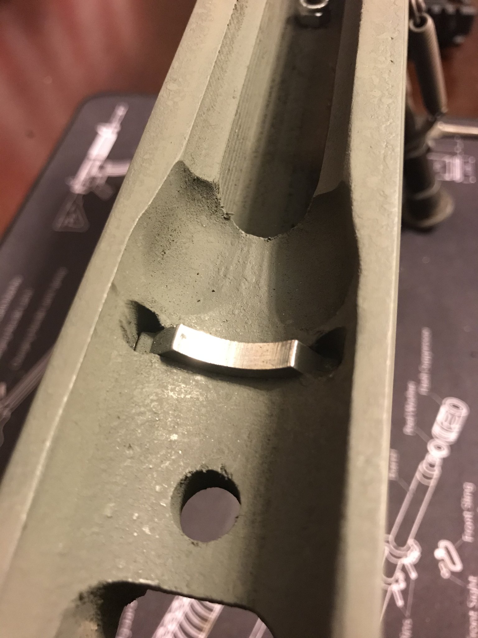

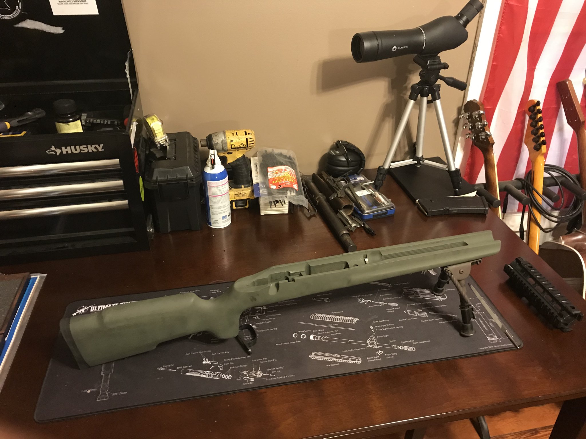

Been working on the stock a little more than anything, it had a weird color OD so I sprayed it with something to make it a more uniform and darker version of its former self.
After spraying it a couple coats I cleaned the recoil lug up with some steel wool and have been pondering if it’s as good as it can get or if it’s worth bedding.
Don’t be judgemental of my cluttered work space. This is where my old lady has cornered me until our new house with my basement is finished (God, how I’m waiting for that basement.)

I haven't had any issue with the recoil lug in the tuperware stocks, but you could bed/glue it in and help with possible cold bore wandering.
