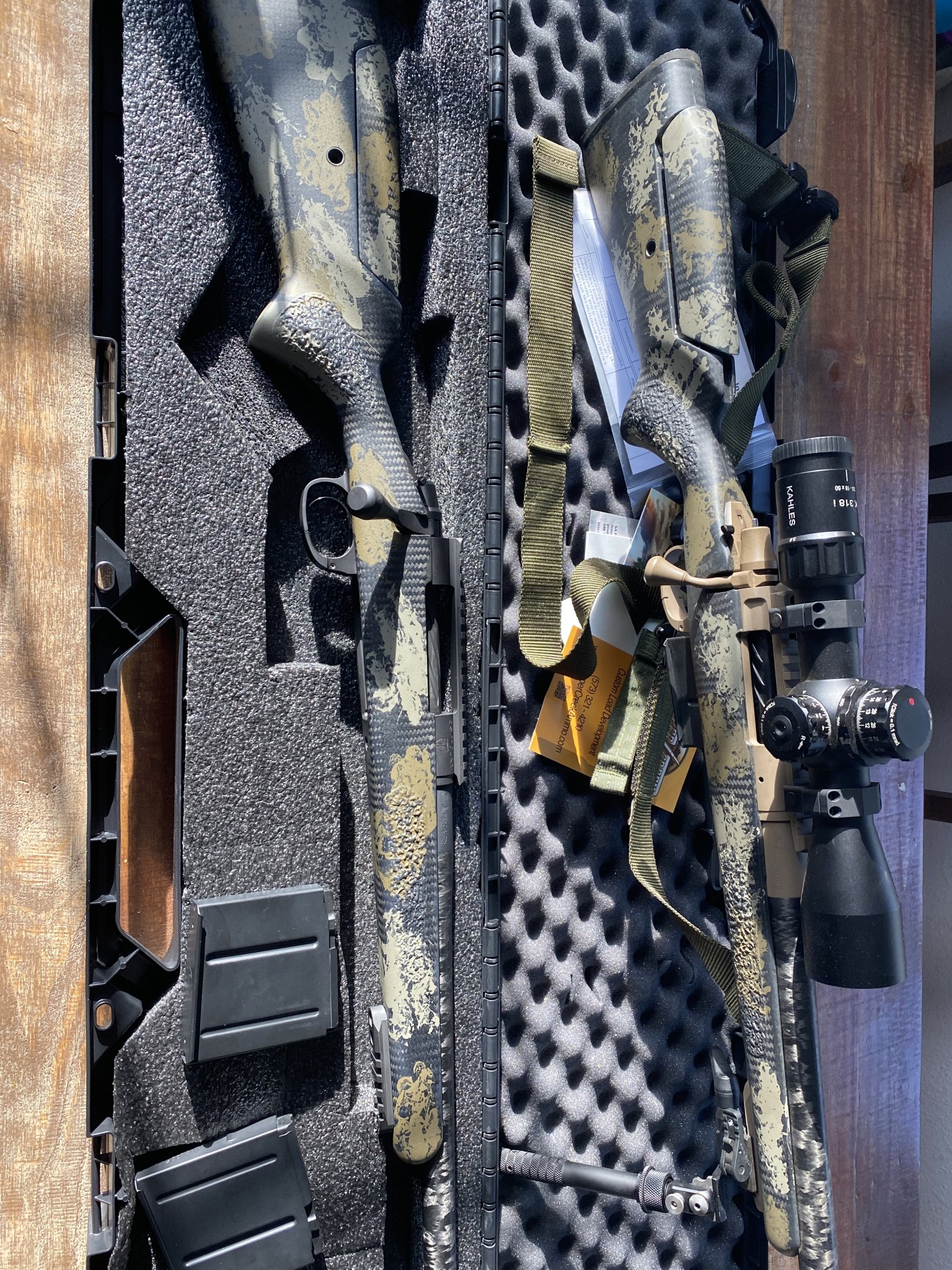

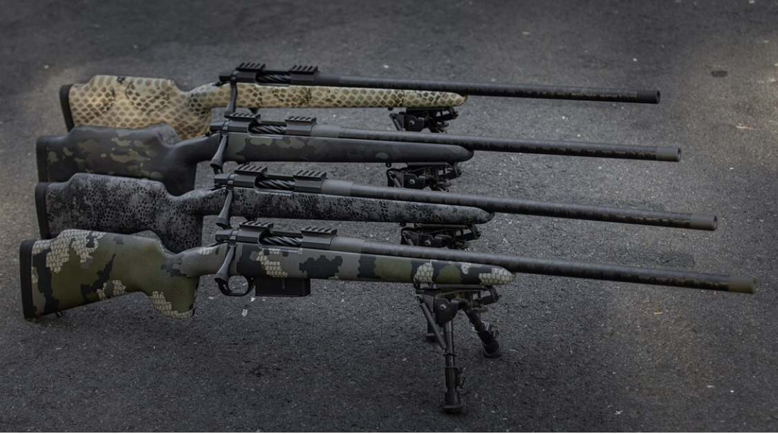

I put together 4 6.5 PRC's built by Spartan Precision for a couple buddies. Lone Peak Razor Ti, Mesa precision stock, trigger tech primary, 24in Bartlein Carbon. The group on the left is shots 3,4,5 down the barrel. The group on the left is shots 2,3,4 all using factory eldX. To say the came out perfect is an understatement.... big shout out to CS Tatical for the help gathering parts so quickly and Marc at Spartan is unreal!!

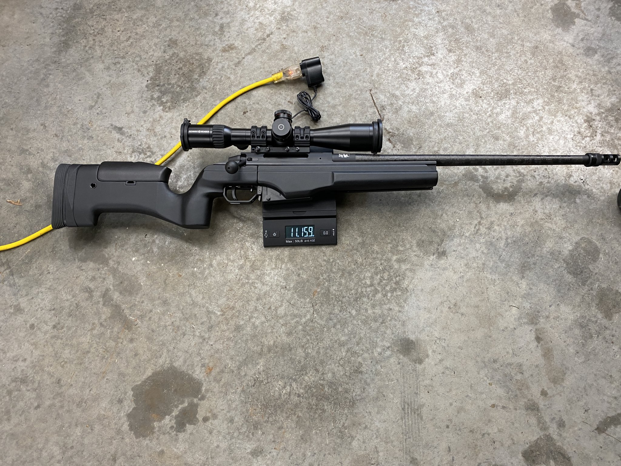

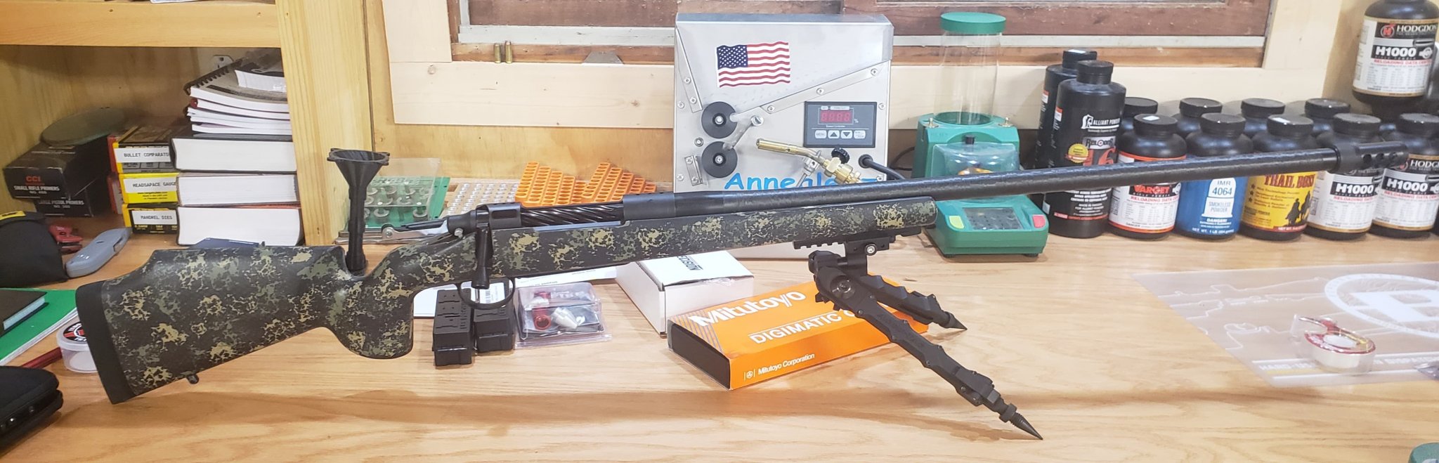

Just Picked my 28 Nosler up from 5x5 percision. Chad did and amazing job. Was so excited to get it in a stock i pulled my 300 win mag and test fit it in that stock while i wait for the Mcmillian i ordered to come in. the Weight was with out the bipod

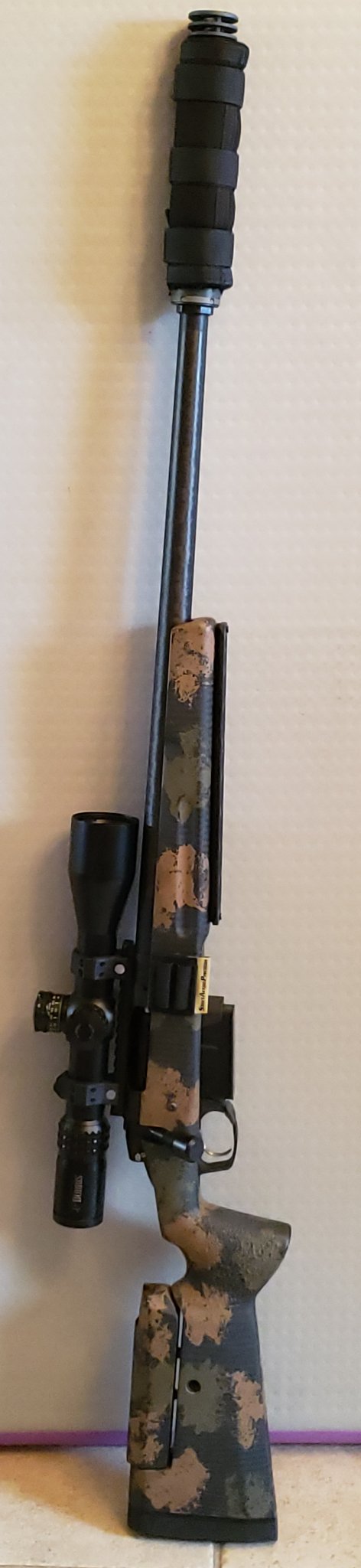

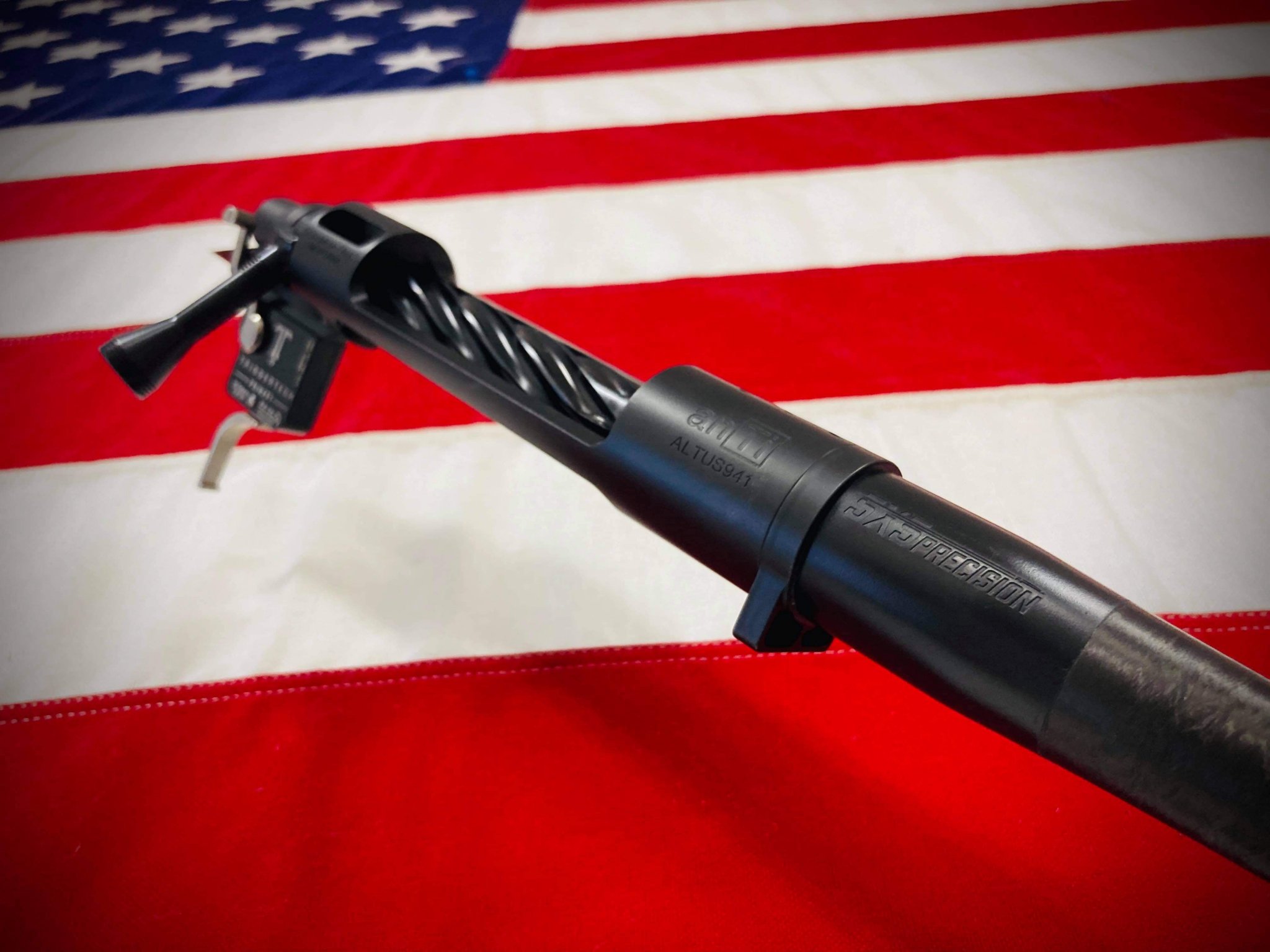

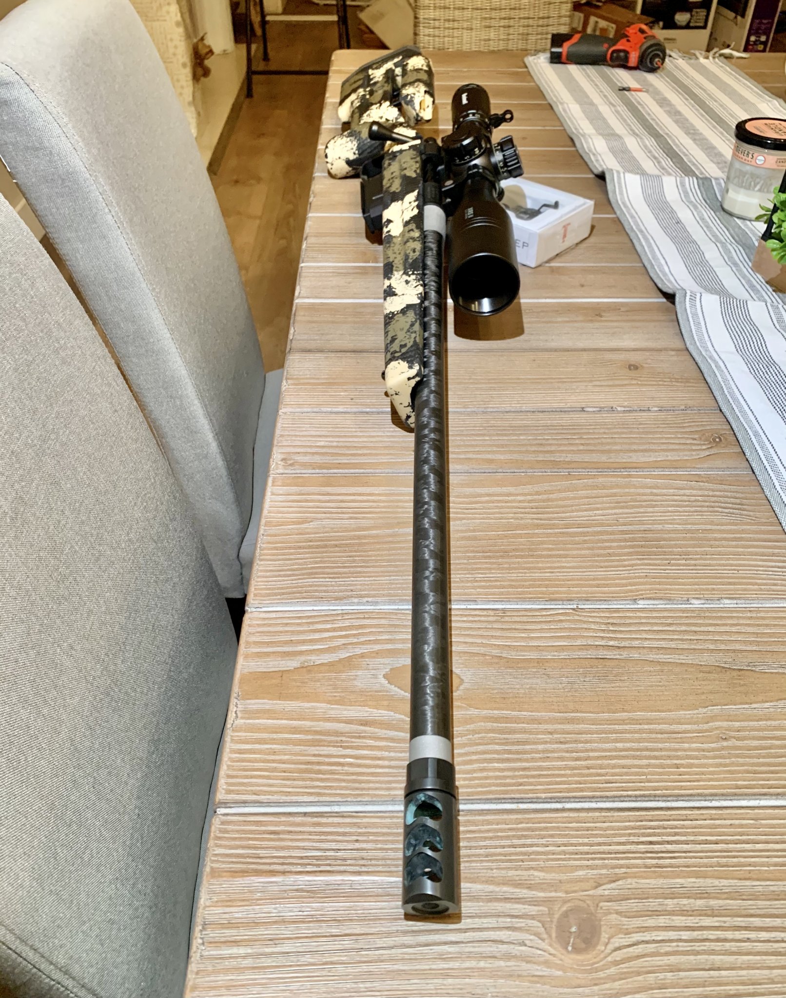

Just got my rifle done with a 24” 1:7.5tw varmint contour chambered in 6.5prc from Spartan Precision Rifles. Going to have the action, barrel shank, muzzle and brake cerakoted tomorrow and then put some rounds down range next weekend. Barrel is gorgeous. A bit heavier than expected but it’s a pleasant surprise as I’ll put a decent amount of rounds through it so hopefully there’s no heat issues.

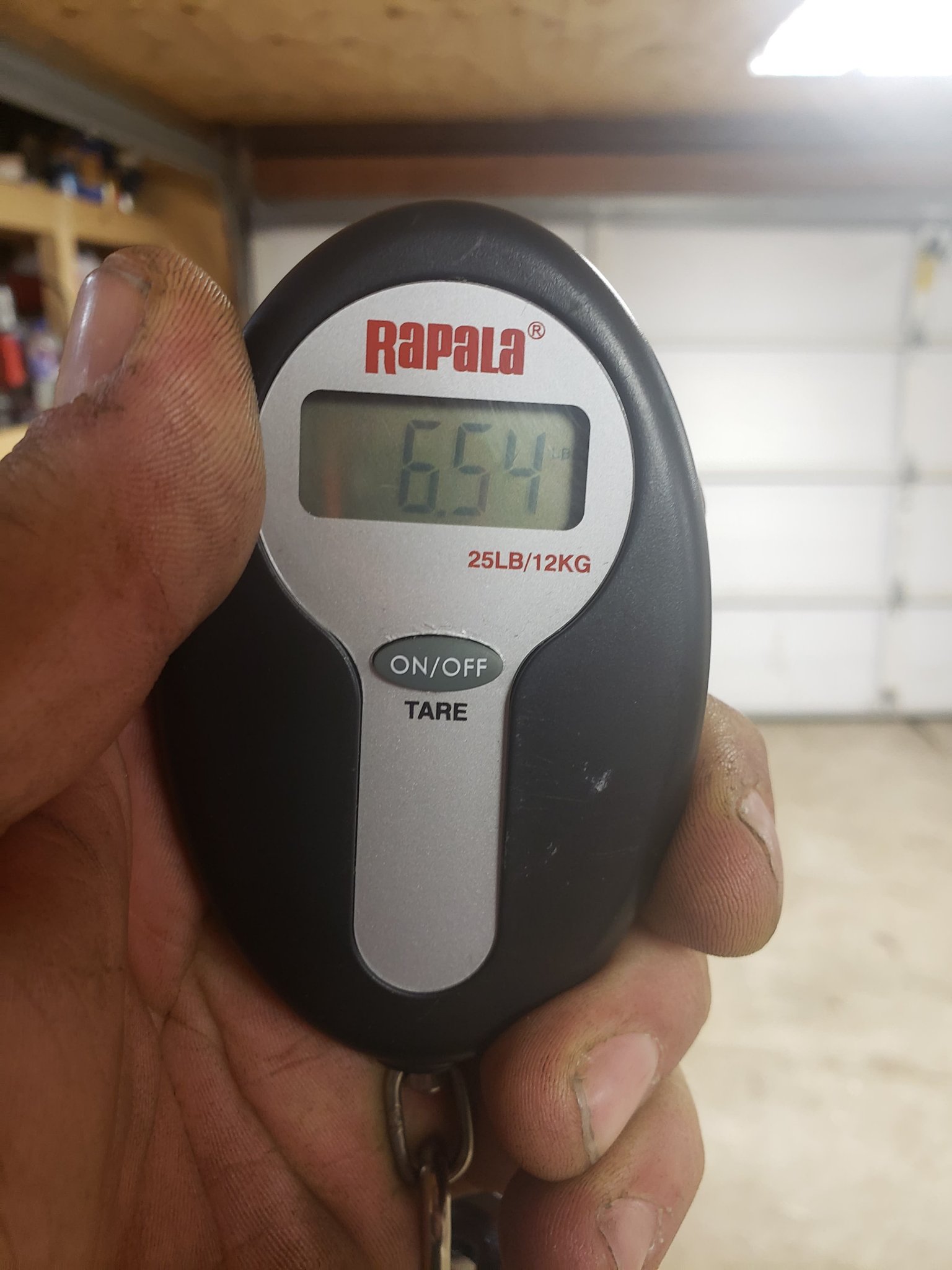

XLR Element 4.0 magnesium chassis, carbon stock/grip, folder
3 rd AICS mag
Bat Vampire mag bolt face
Vortex precision (Seekins) rings
March 2.5-25x52
Jewel HVR
All together minus barrel, is 6 lbs even. Will also have a Silencerco harvester can on it, so add 11 oz to that. Figuring the barrel around 2 lbs 6ish oz once all the machining is finished, so all up with the can, 9 lbs +- a couple ounces. Should be a sweet pack rifle.
