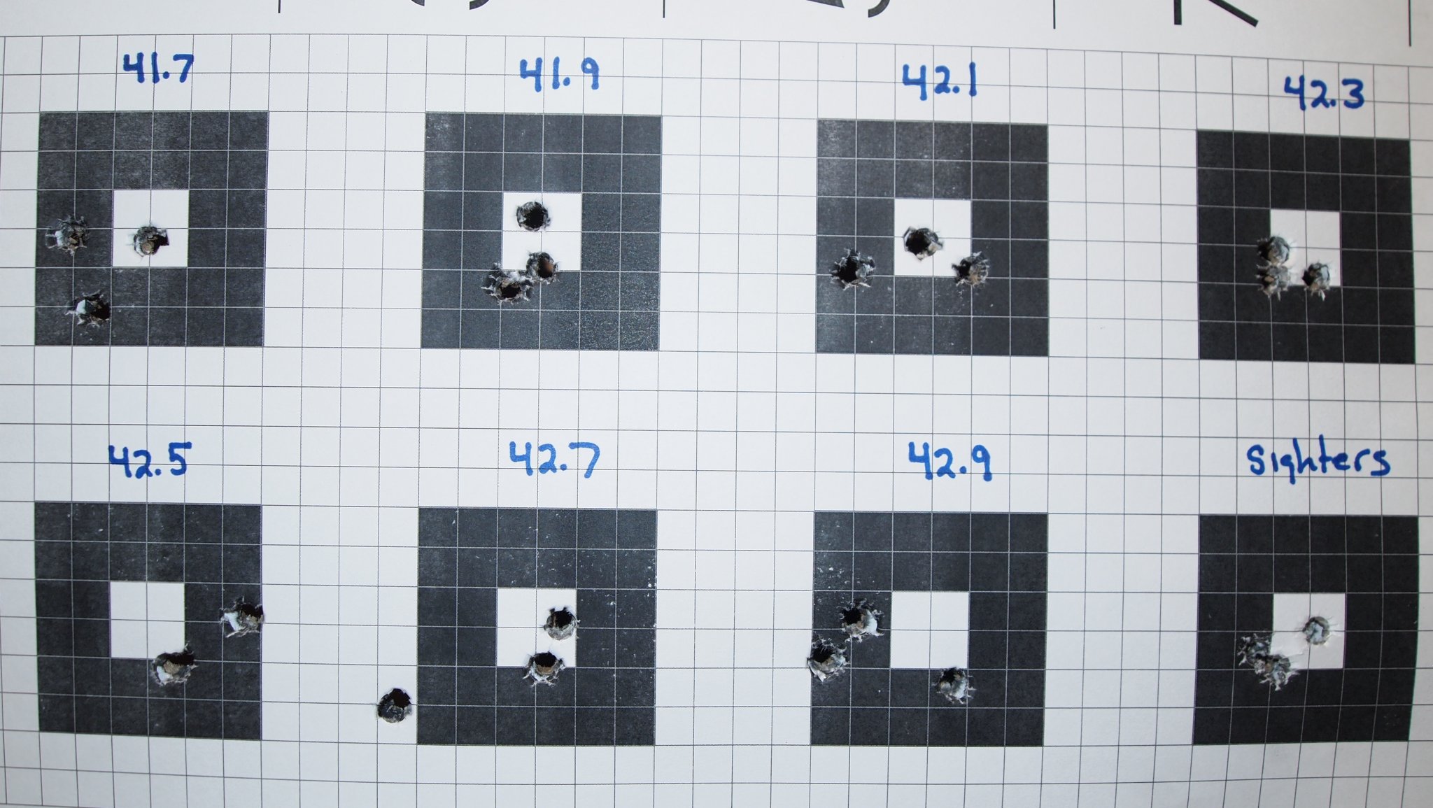

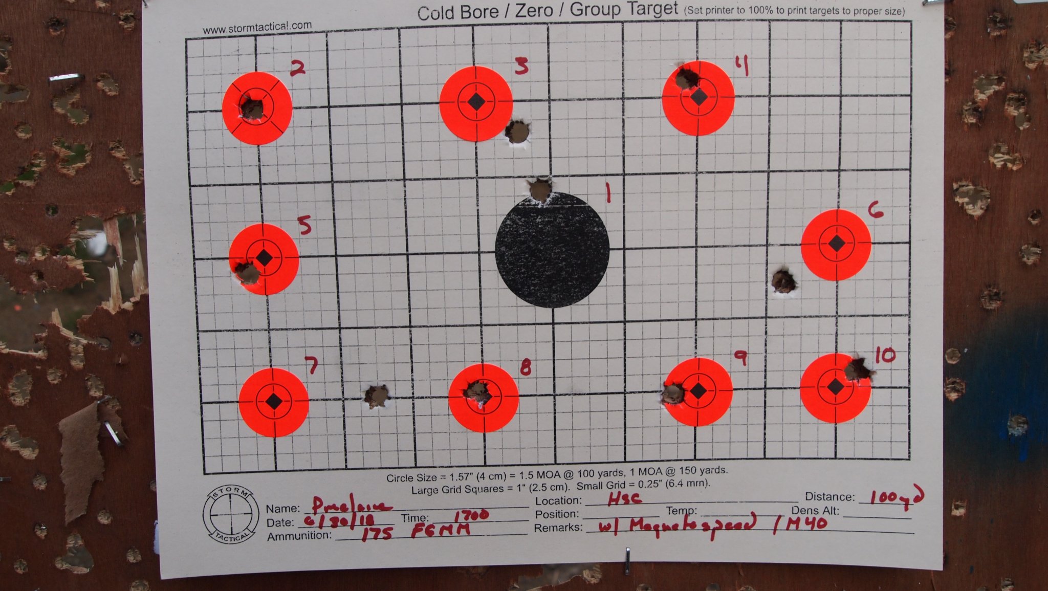

    Todays target.
    I was using 42.1 as the middle and going lower and higher. All groups are 3 shots. I screwed up and shot one of my 42.9 rounds into my sighter target Take the middle of the sighter group and move it over to 42.9.
    Going to 42.9 was an afterthought. I only loaded them because I wanted to keep the shell plate full for consistency as I was loading the final 42.7s. 42.9 had a stiffer bolt lift and its not where I think this rifle wants to be.
    Ill be investigating 42.3 a bit more.....

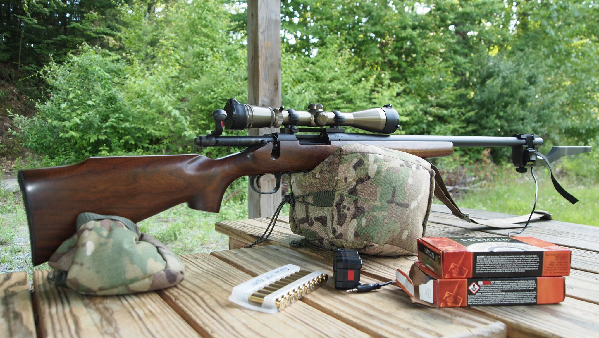

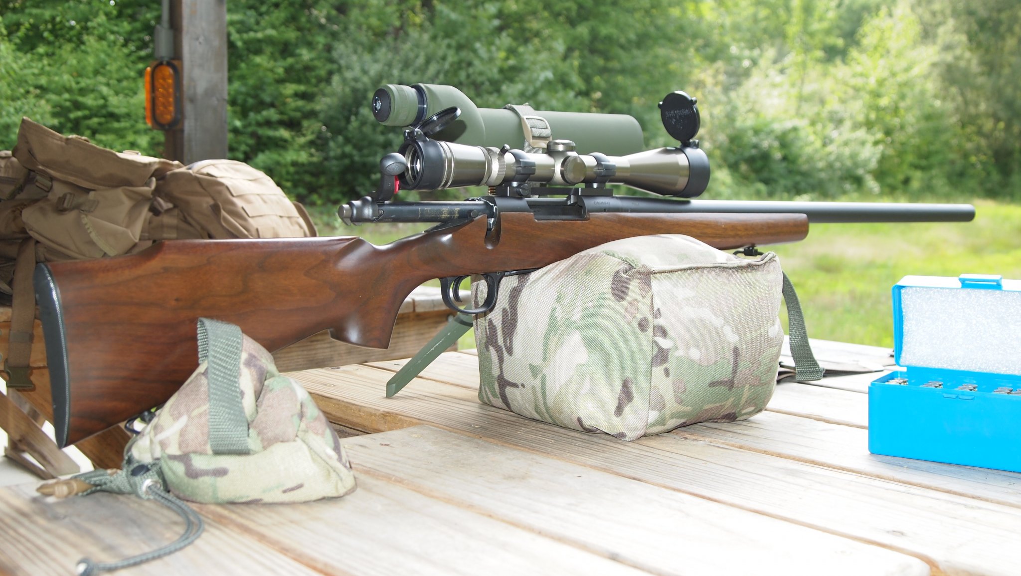

    A gratuitous shot of rifle porn......

    I like what I see from the 41.9 and 42.3 loads. I have used 42.2 for the 175 for going on decades, so I think the 42.3 could be productive, and the 41.9 could be a great practice load. Clearly, that's a rough incrementation and the adjacent tenths, etc., would be worth exploration.

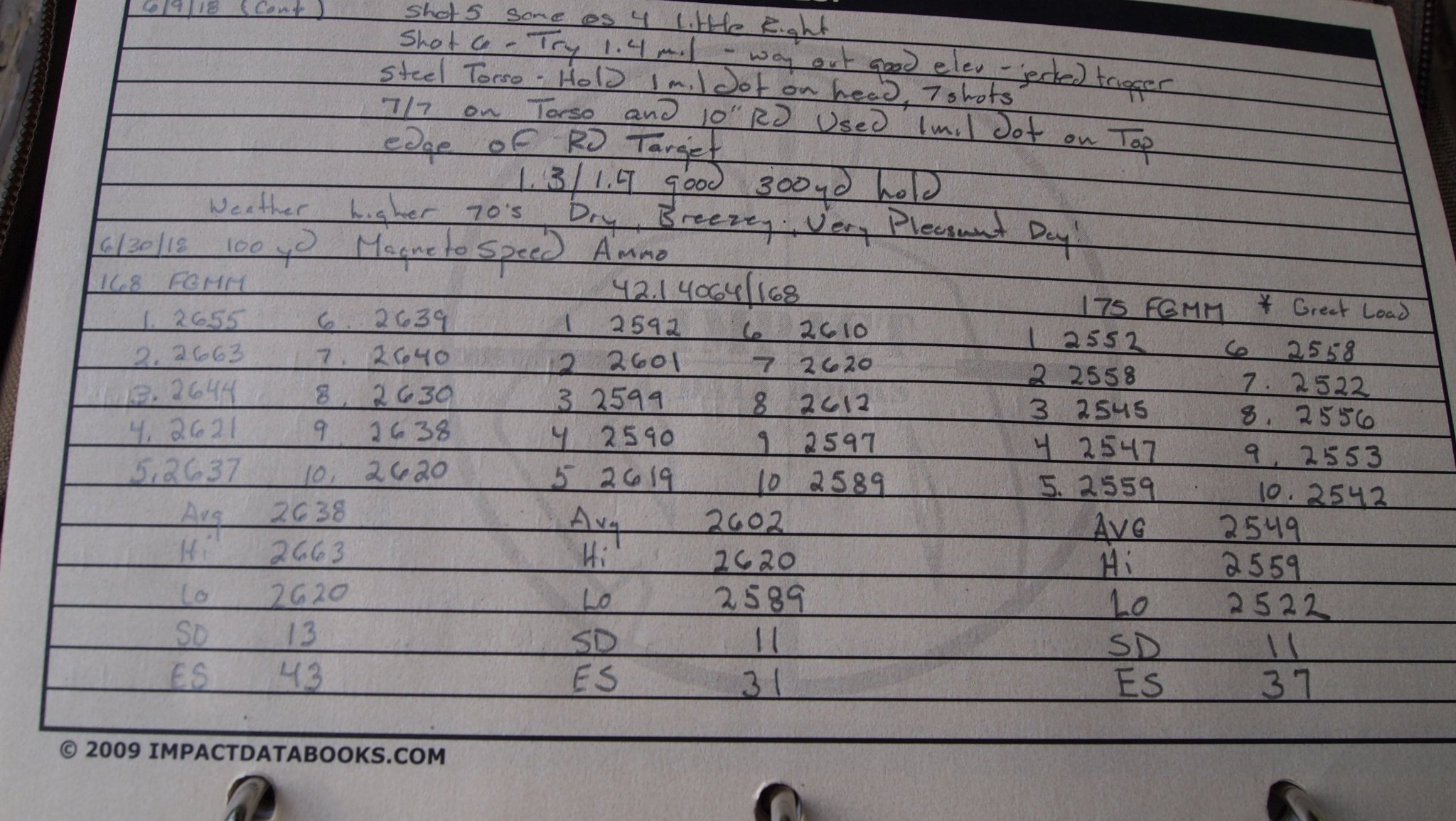

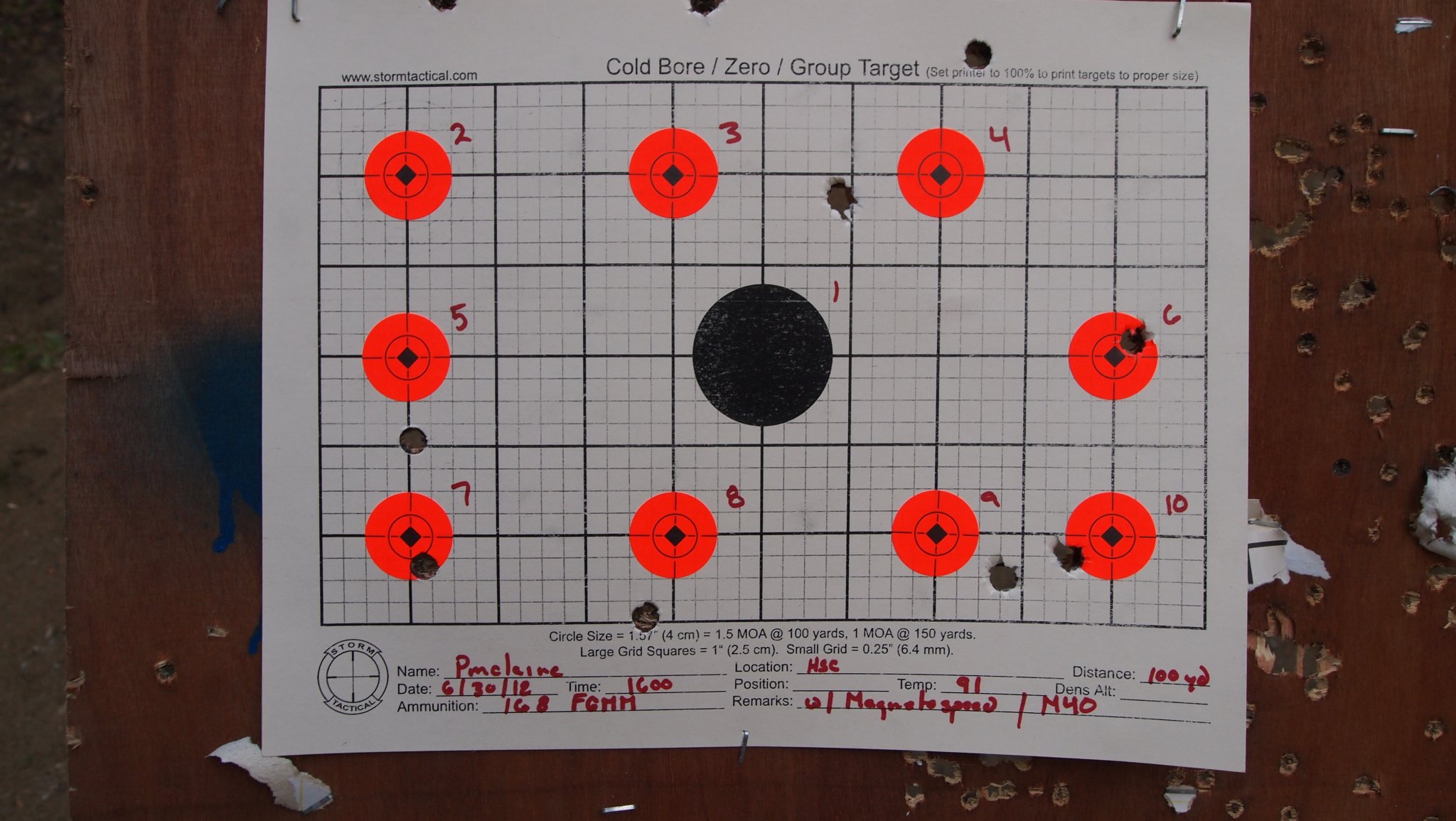

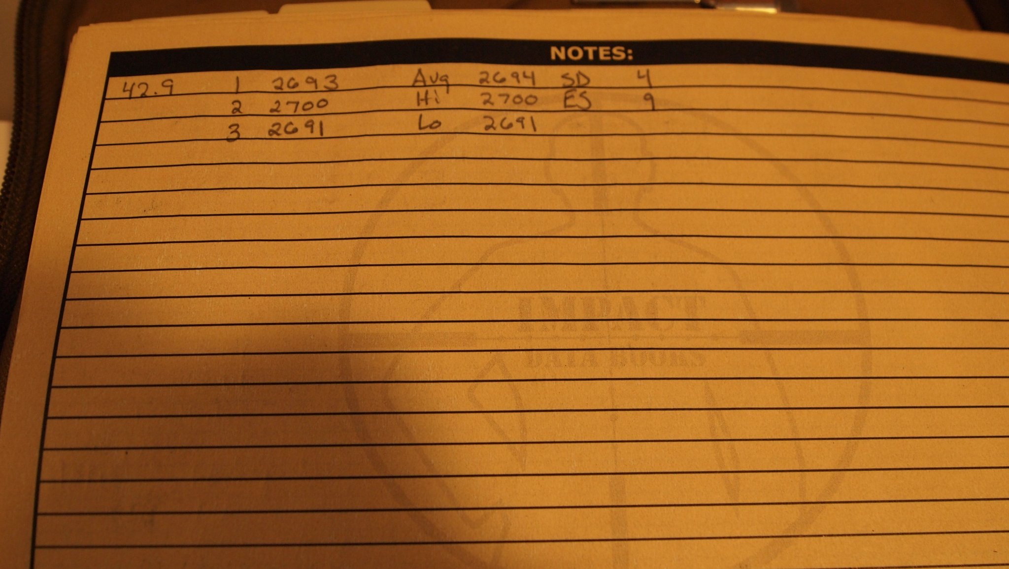

    Just to understand the baseline Im working from.
    Some more info of my Magnetospeed data check of my 42.1 load compared to FGMM 168 and 175.
    Wasnt really worried about impact. I was holding mildots as my 100 yard zero really seemed to "float" on this day...
    Looking at your velocities and considering the 44.0 load is within published limits, I'm changing my mind about pulling that test batch.
    Great notes, BTW. I have to get my act back together.
    I'd not be too troubled by the floating zero using the Magnetospeed. Now that your have your velocity data, taking it off should tighten up the zero again.

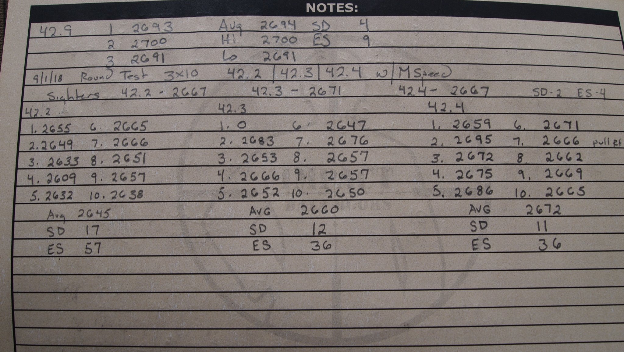

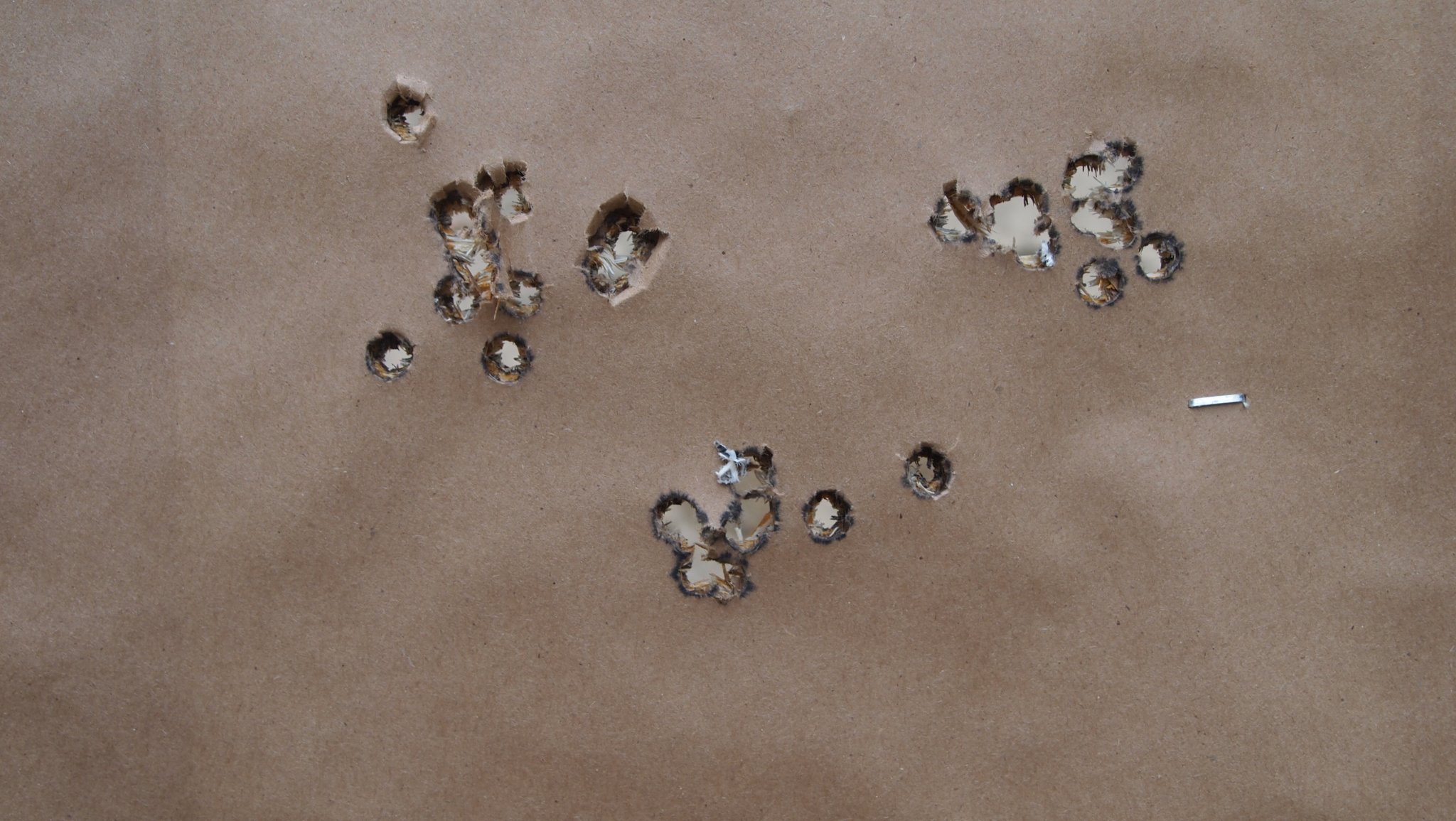

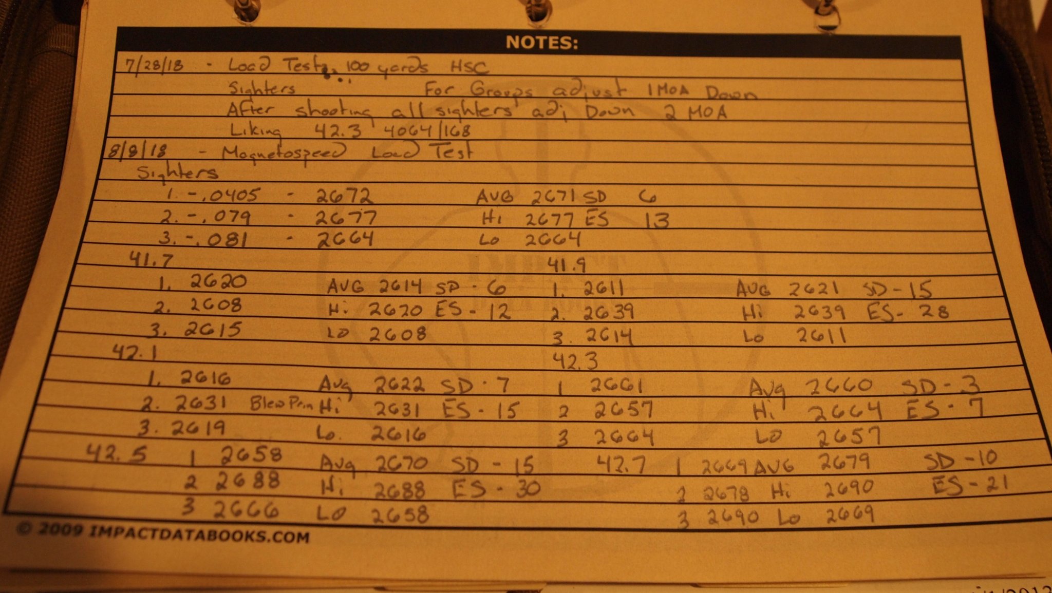

    Same loads with a Magnetospeed under the bore.....
    Data.
    I dont know how statistically significant three rounds of data represents but Im feeling pretty good about 42.3.
    Im guessing its a low node which for the intended use for that rifle probably wont hurt me too much.
    The high node for that combo is 43.6 but you’ll loosen FC primer pockets quickly and gain only 70 or so FPS.
    Yep no need to subject rifle or I to that.
    What did you find for low node?
    My next step will be to load 5 each of 42.2, 42.3, and 42.4 over a Magnetospeed and take the one with best numbers.
    Guessing thats probably unnecessary as 42.3 looks better than I can shoot.

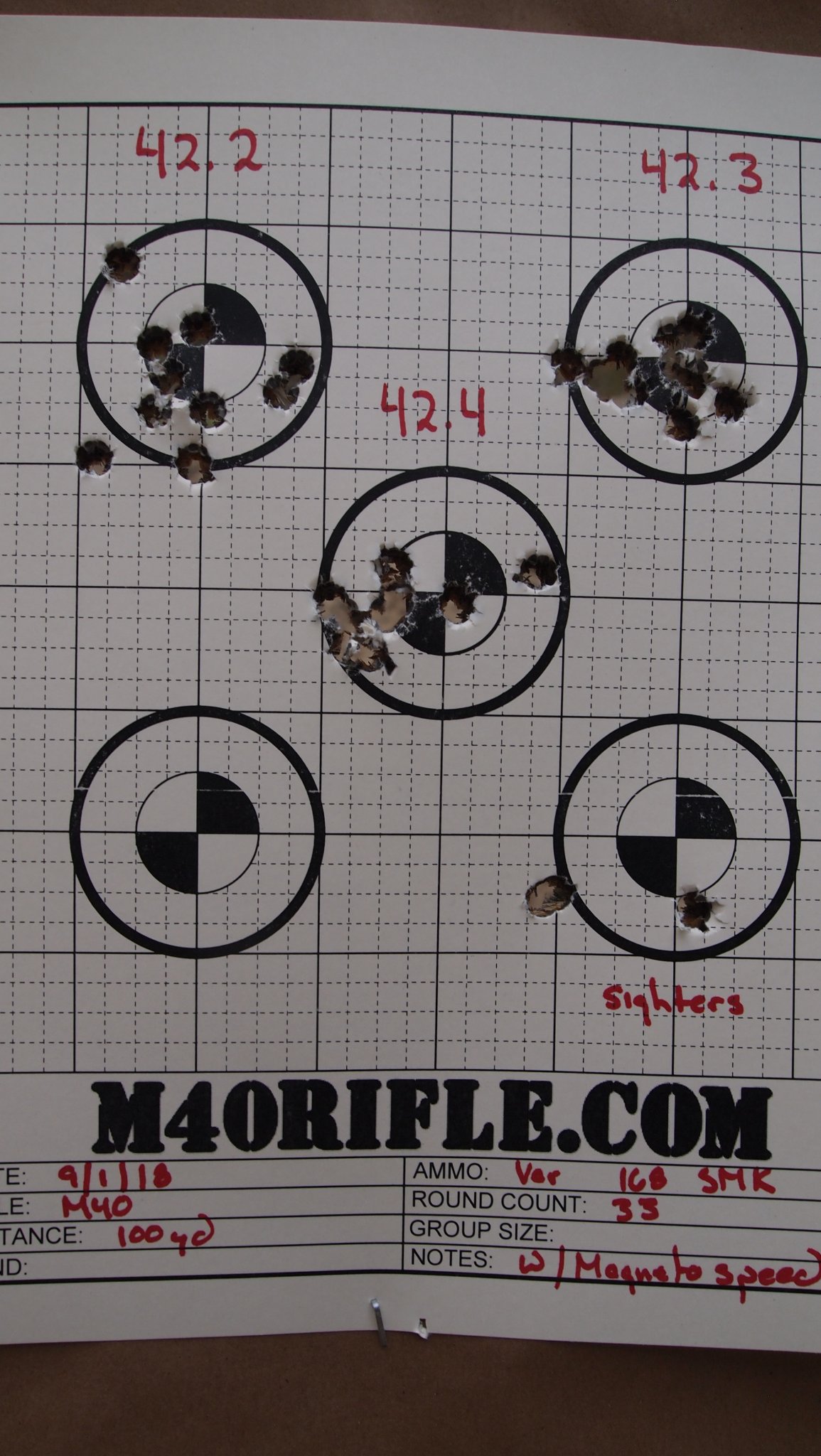

    Back at it tonight finishing up a load for my M40...
    A picture with the target removed shows a better story....
    42.4 has a group of eight and two flyers, the far right one which I called. 42.3 shows a four round group and a 6 round group.
    Data looks good. for my sighters in the first picture 43.3 and 42.4 landed basically on top of each other. Prior data for 42.5 was decent and that three round group was nicely triangulated. I think 42.4 gets me in the middle of a good spot...

    Besides based on those 8 together at 42.4 - Ill take that error.
