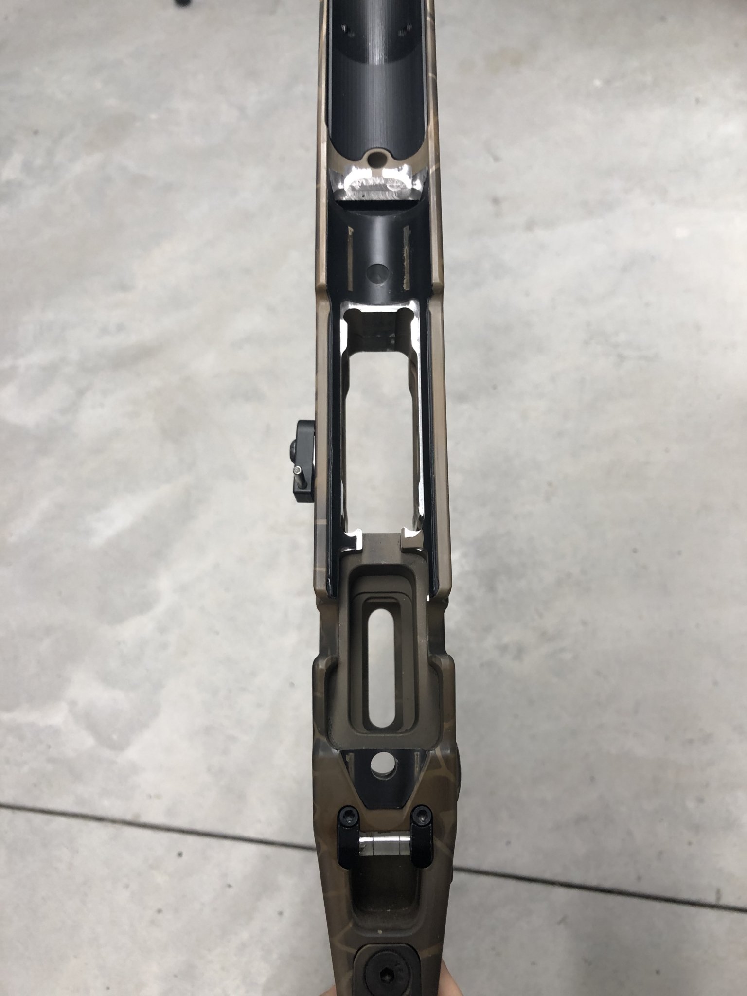

I epoxy bed a lot of MPA Chassis because receiver fit can be an issue. It will fix issues with vertical and horizontal stringing as well as give you consistent return to zero after removing barreled action for maintenance.

Gray. Thank you for your advice and the picture. I bought a wheeler kit from Midway a few years ago but could not see where to put the bedding because of the v blocks or felt it would not help. I can't tell you how much trouble I've had and how many different combinations I have tried. I'm gonna try this today. Thanks
Richard

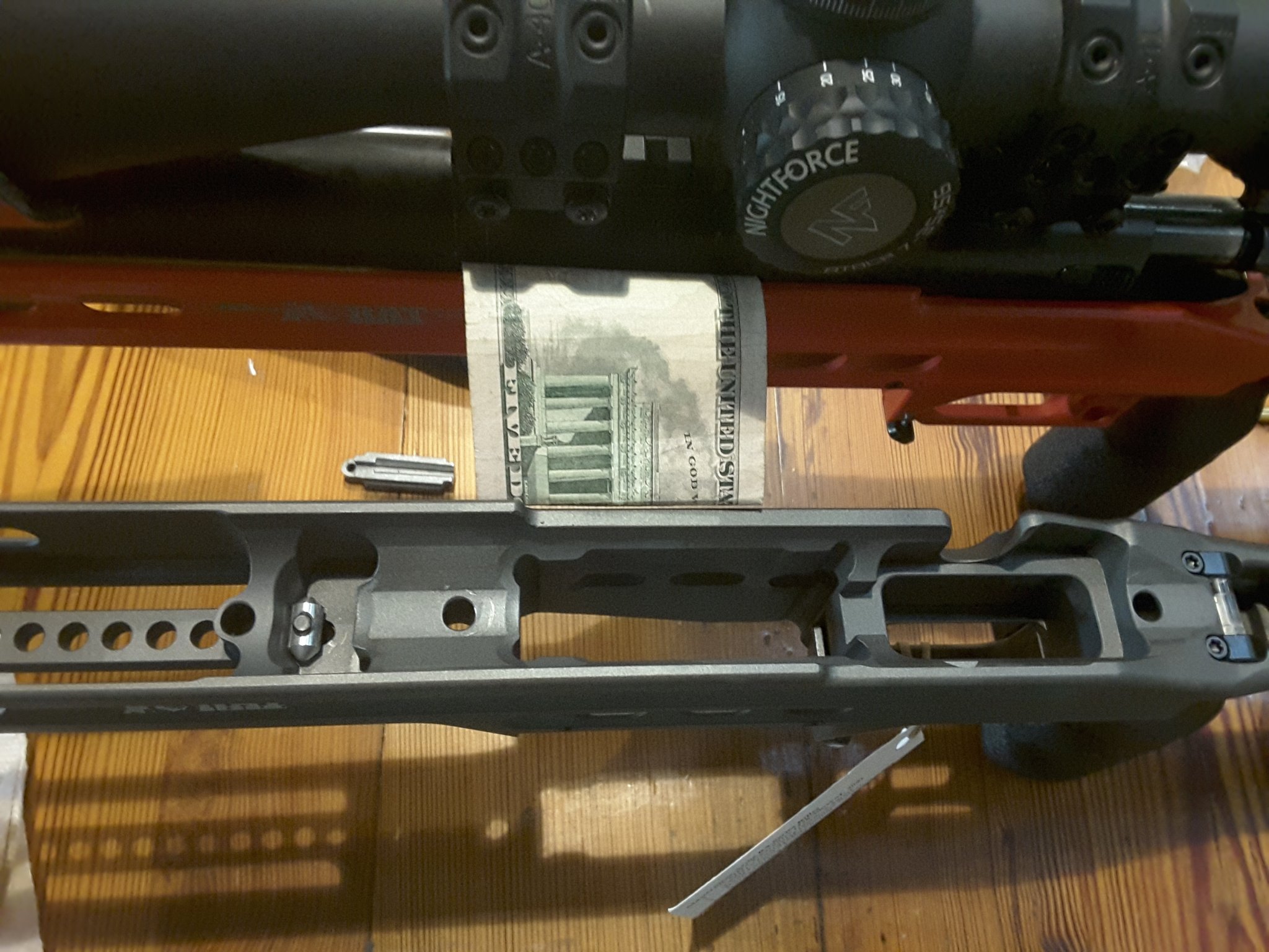

HEY Gray! Looks like you put the bedding down the sides too? This is my Vudoo receiver and I can barely get a dollar bill down the side. Should the bedding touch the receiver there? And the front of your lug looks different too? I thank you in advance!

I fully bed the action all the way around on a chassis, not just the lug area. A dollar bill will fit because the v block is contacting a small portion of the action. Epoxy will fill that portion in and support the action 100%.

Thanks Gray. I had a gunsmith do it because i was a little concerned about doing my benchrest rifle for a first time. I was disappointed that he told me when I dropped it off that he only does the lug area and the rear. Its shooting a lot better so I'll go with it for now.
