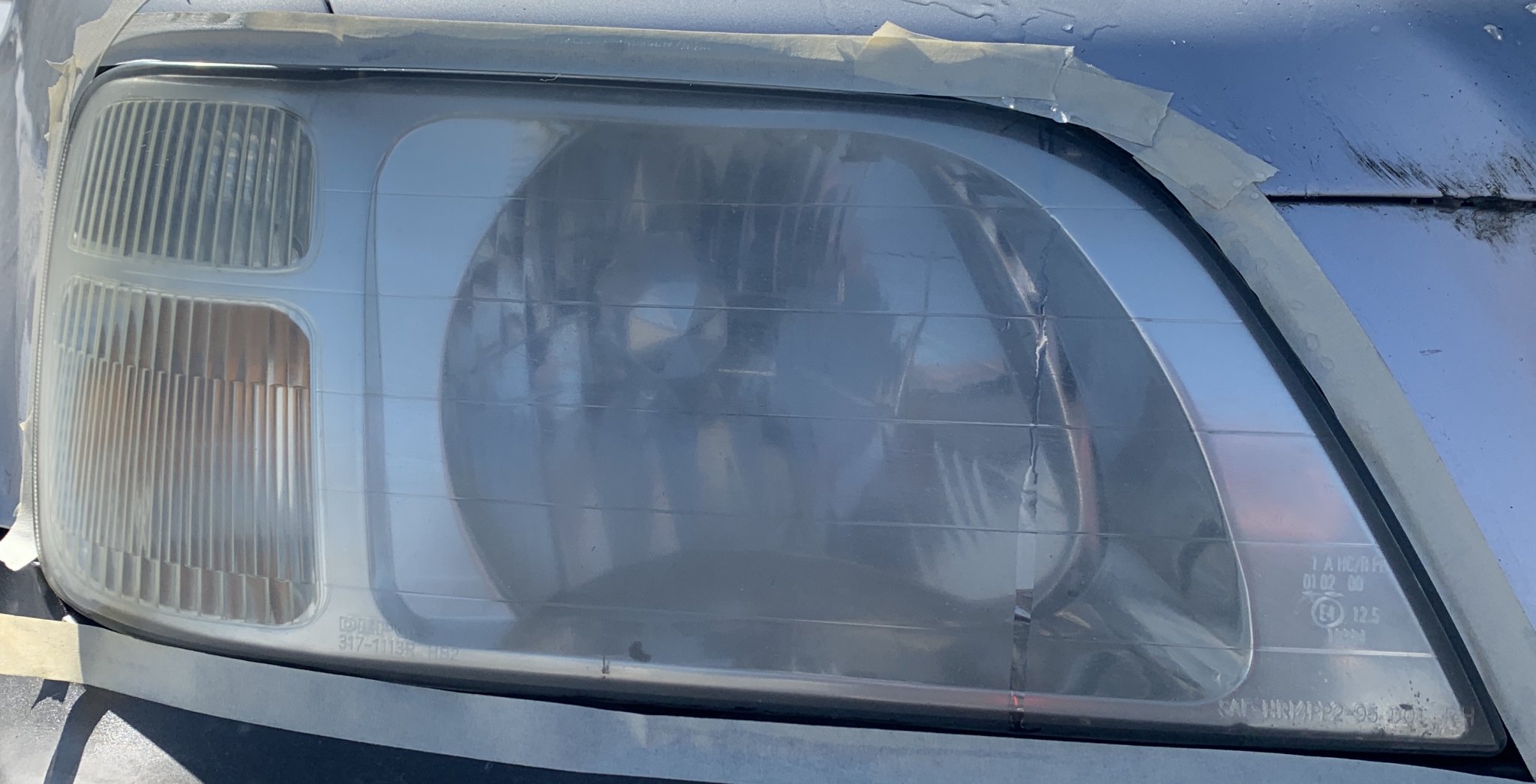

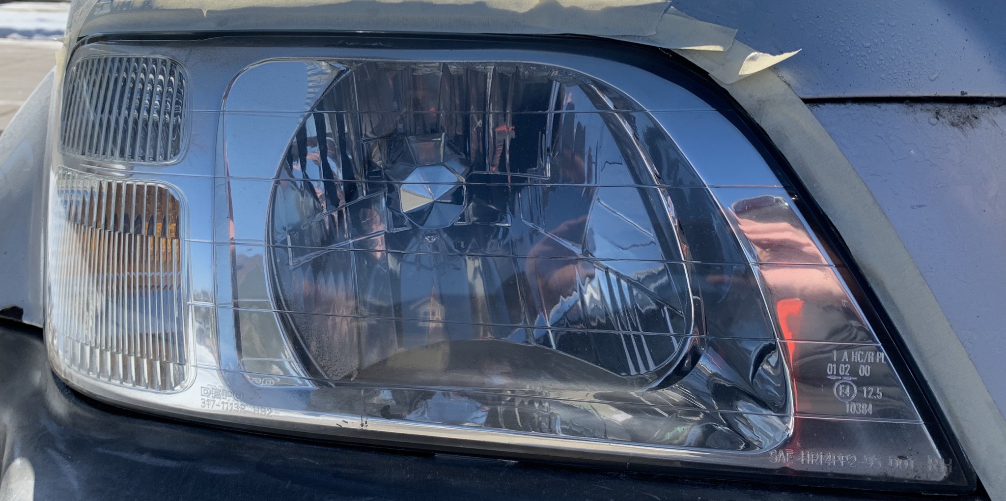

    Just finished polishing the headlights on my daughter's 2001 CRV.
    3M Headlight Restoration System. Have never tried this before. Never had a car for more than 3 years. :geek:
    Before:
    After:

    I used the 3M restoration kit myself on my 2009 Silverado late last year, based on a recommendation from a coworker. My were heavily yellowed and awful looking before. Afterwards, they looked as clear and bright as your after picture. I was honestly surprised and didn’t expect it to work so well.
    The trick is to follow the directions carefully and make sure you get all of the original clear coat off with the first sandpaper grade. Then take your time with each of the two subsequent polish grades to completely get the scratches from the previous grade out before moving on. Then use the provided clear coat to seal the deal.
    Totally worth the price and time in my opinion.
