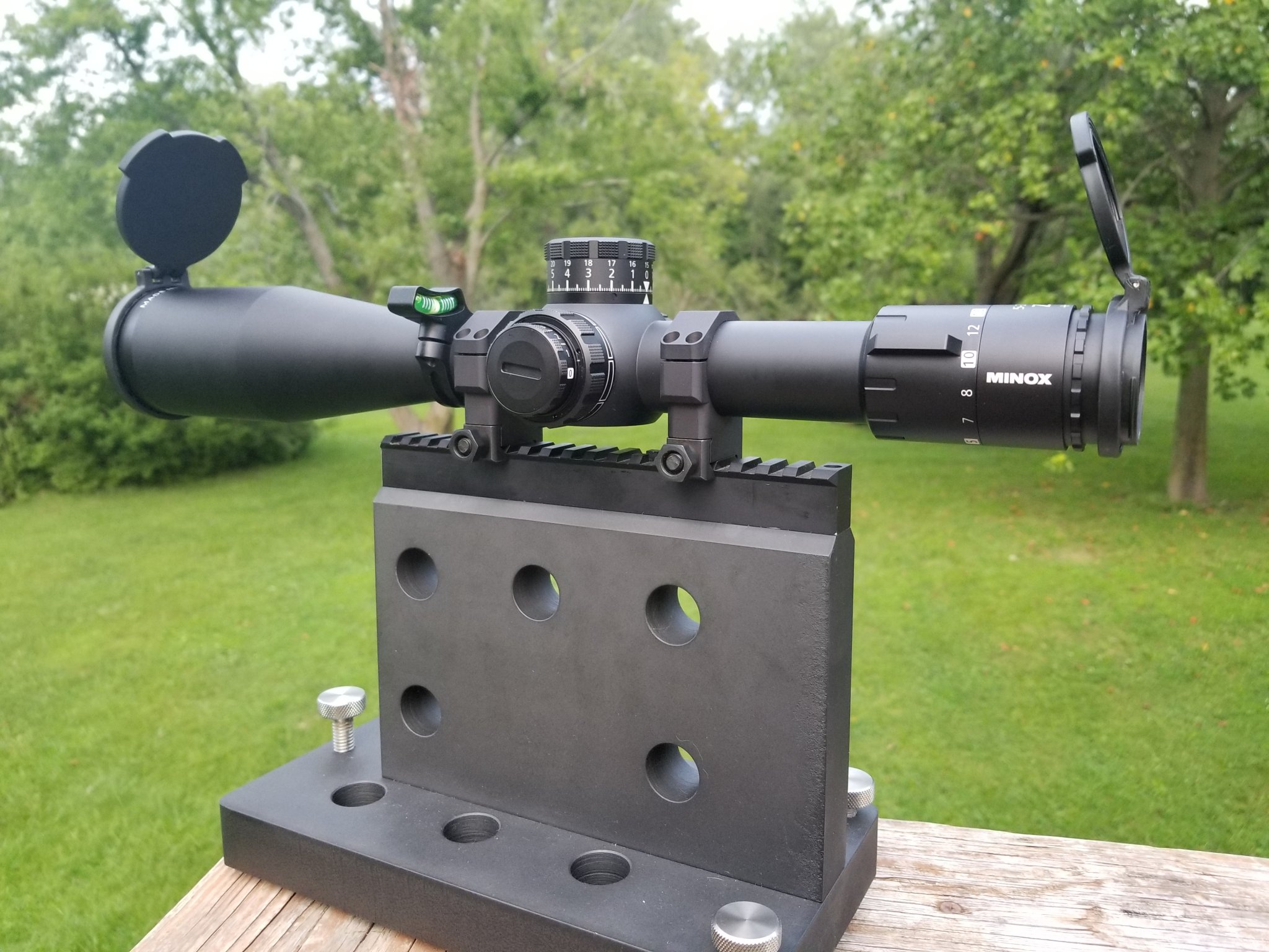

When mounting scope to rings, I use a fixture I built to check a scopes tracking.
I level the rail on the fixture, then shine a flashlight through the object and use a plumbbob to level the reticle. I use feeler guages to ensure the ring cap is the same on both sides of the scope ring.
