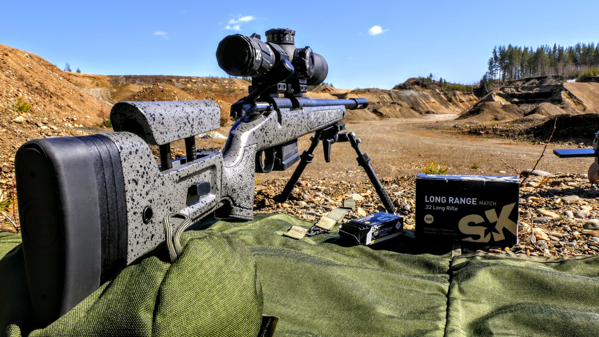

300-meters with SK long range match and ZCO 420.

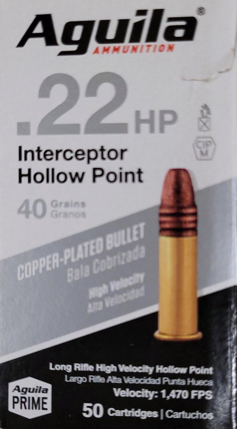

Ramdom: I tried a number of different Aguila 22lr varieties and found all to be fairly consistent with the B14R really liking:

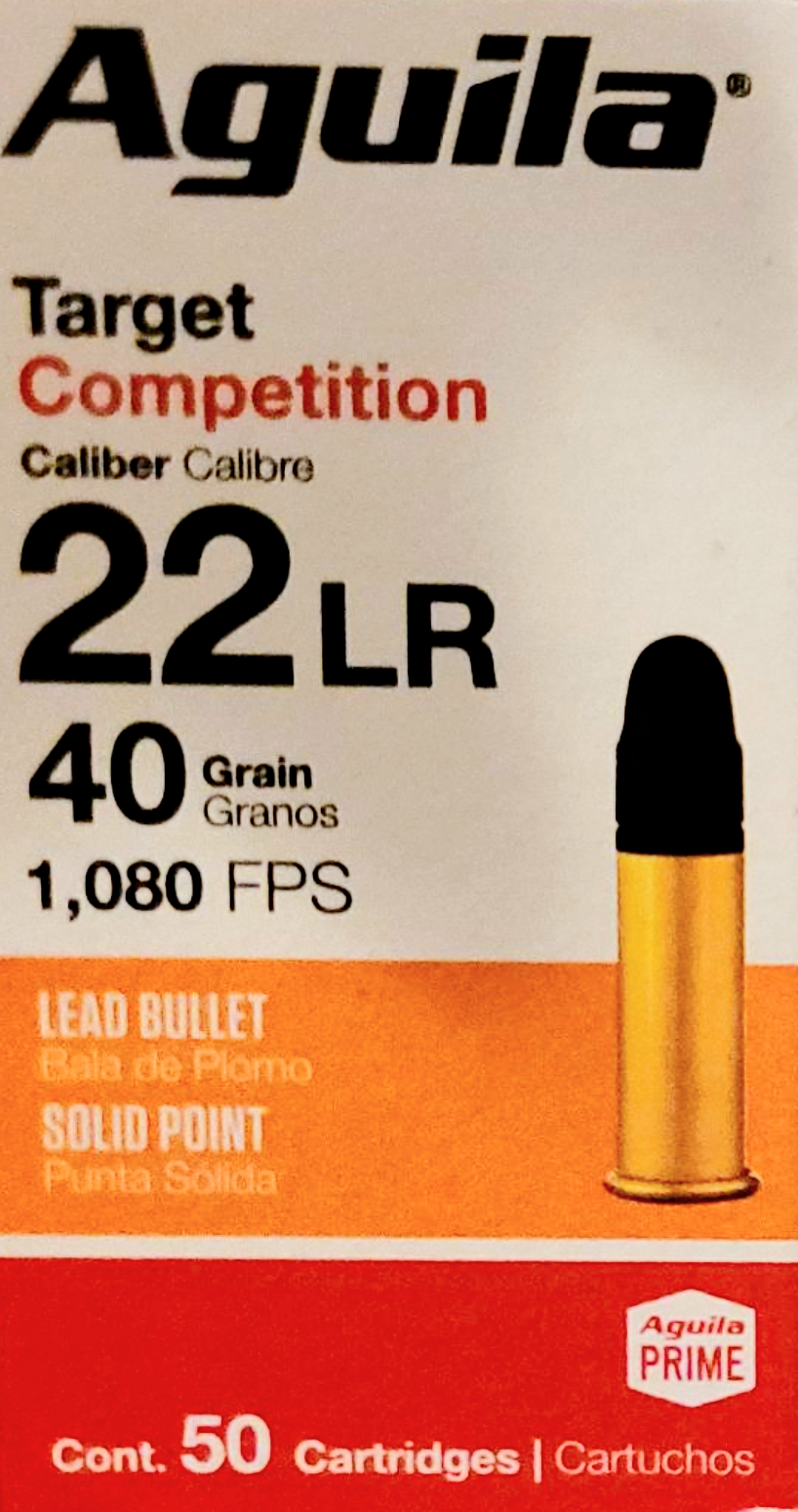

Tried the Aguila Competition variety, below, and loading into the chamber was VERY resistant; most likely due to a slight overbore courtesy of a wax(?) coating Aguila puts on them:

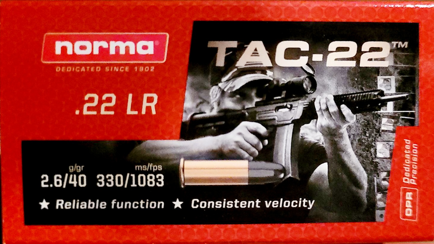

Tried Norma TAC-22 (below) which has a light sticky vaseline-like grease layer on the bullet. Never had a misfeed, but other non-greasy ammo (basically anything other than Norma) had trouble with multiple failures to extract after encountering the Norma grease in the chamber. Once chamber was cleaned, issues resolved:
