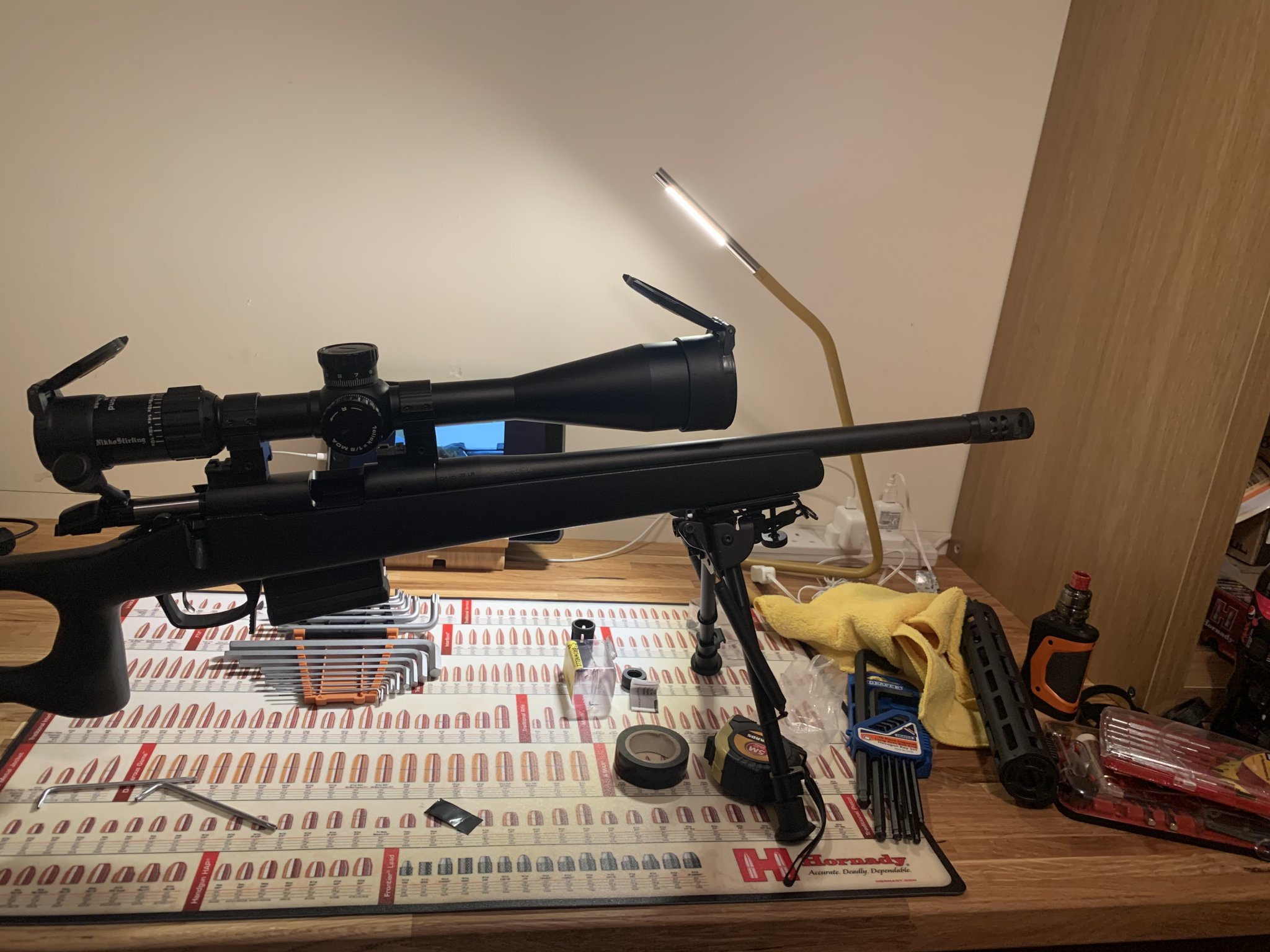

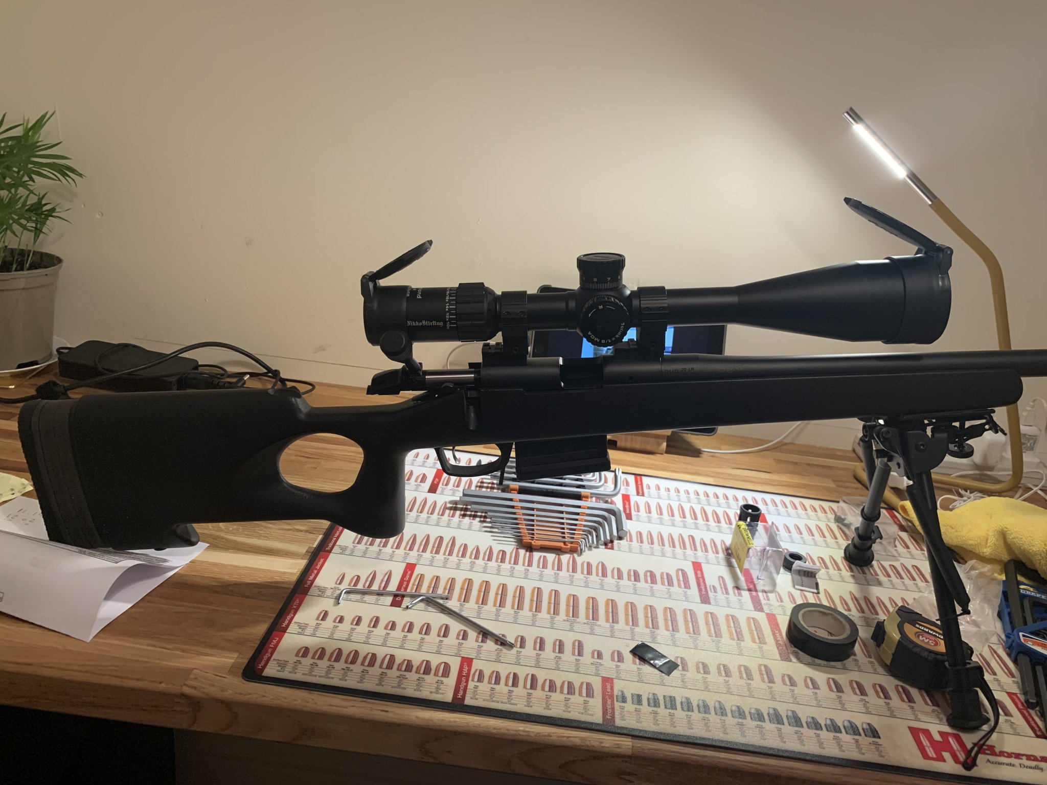

I thought I’d up date this thread,I’m still waiting for my TAC21 to arrive in the uk,but I picked up my action and I’ve been lent a stock,chucked a few bits I had spare on it and it already looks great

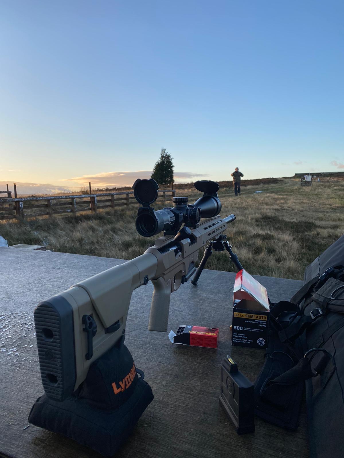

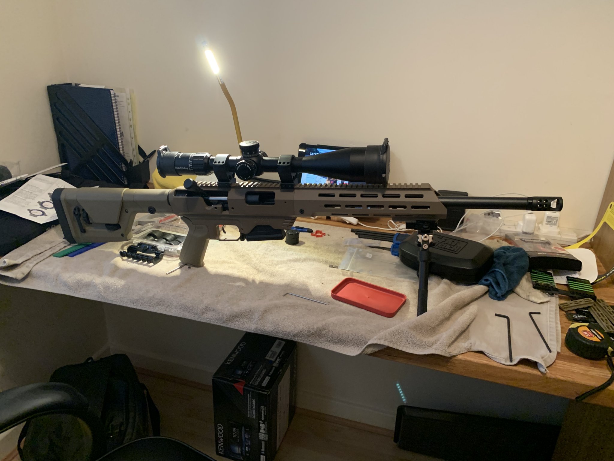

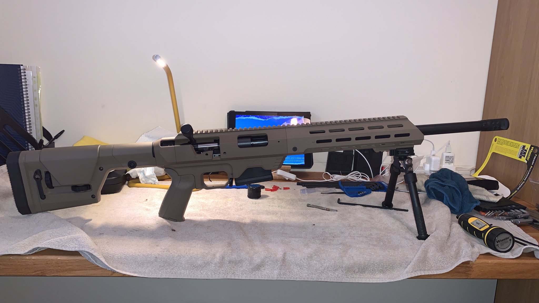

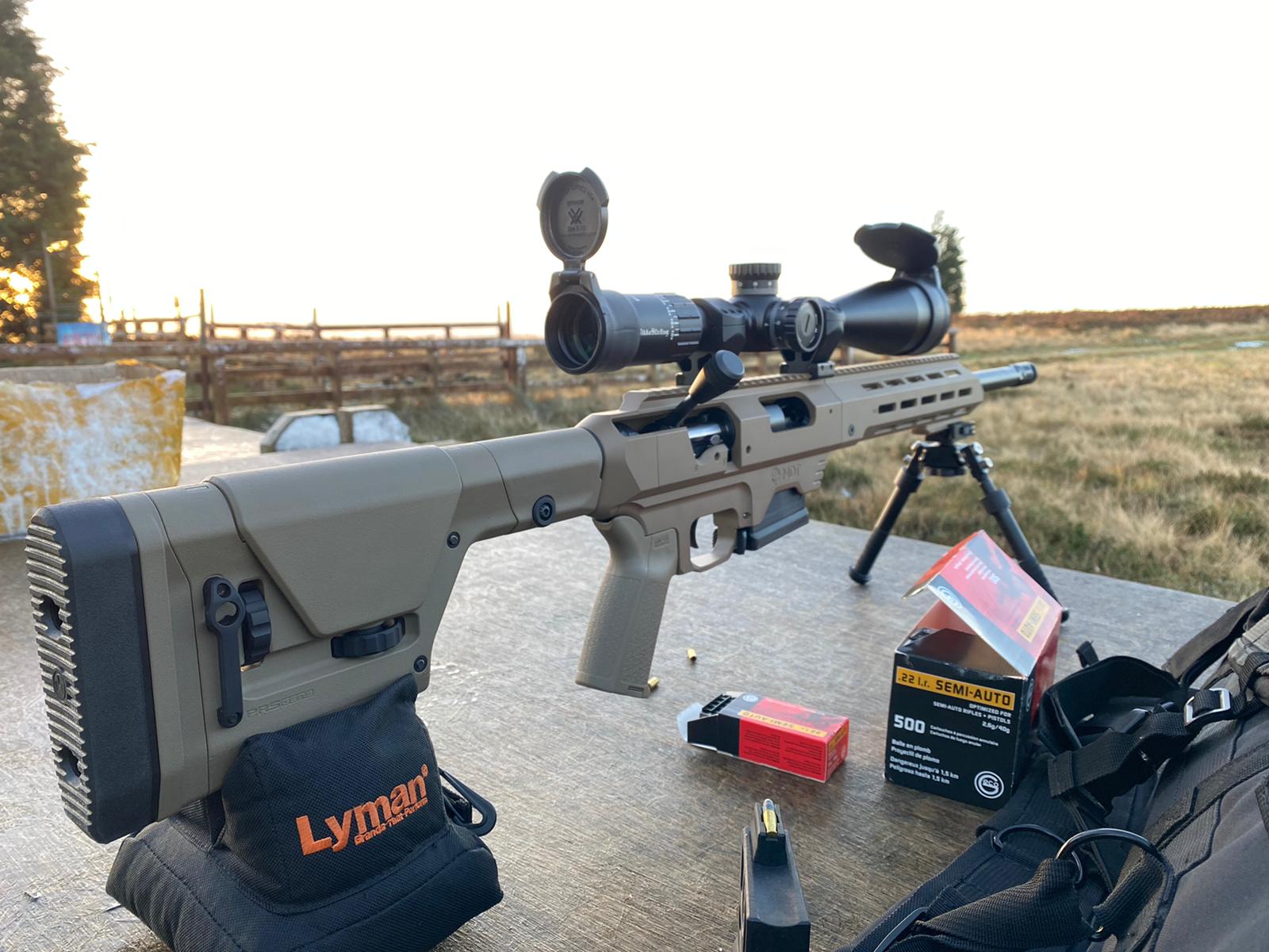

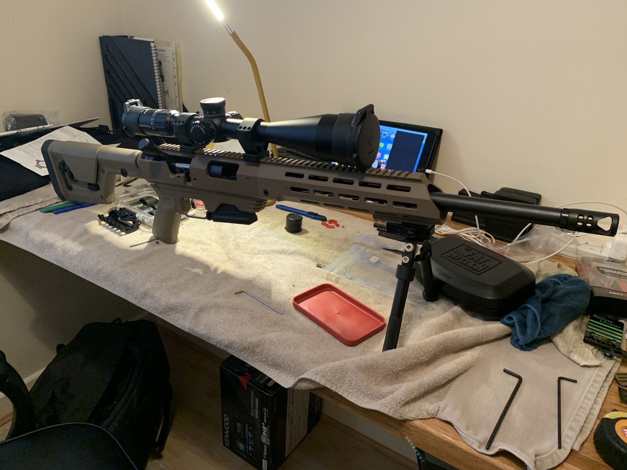

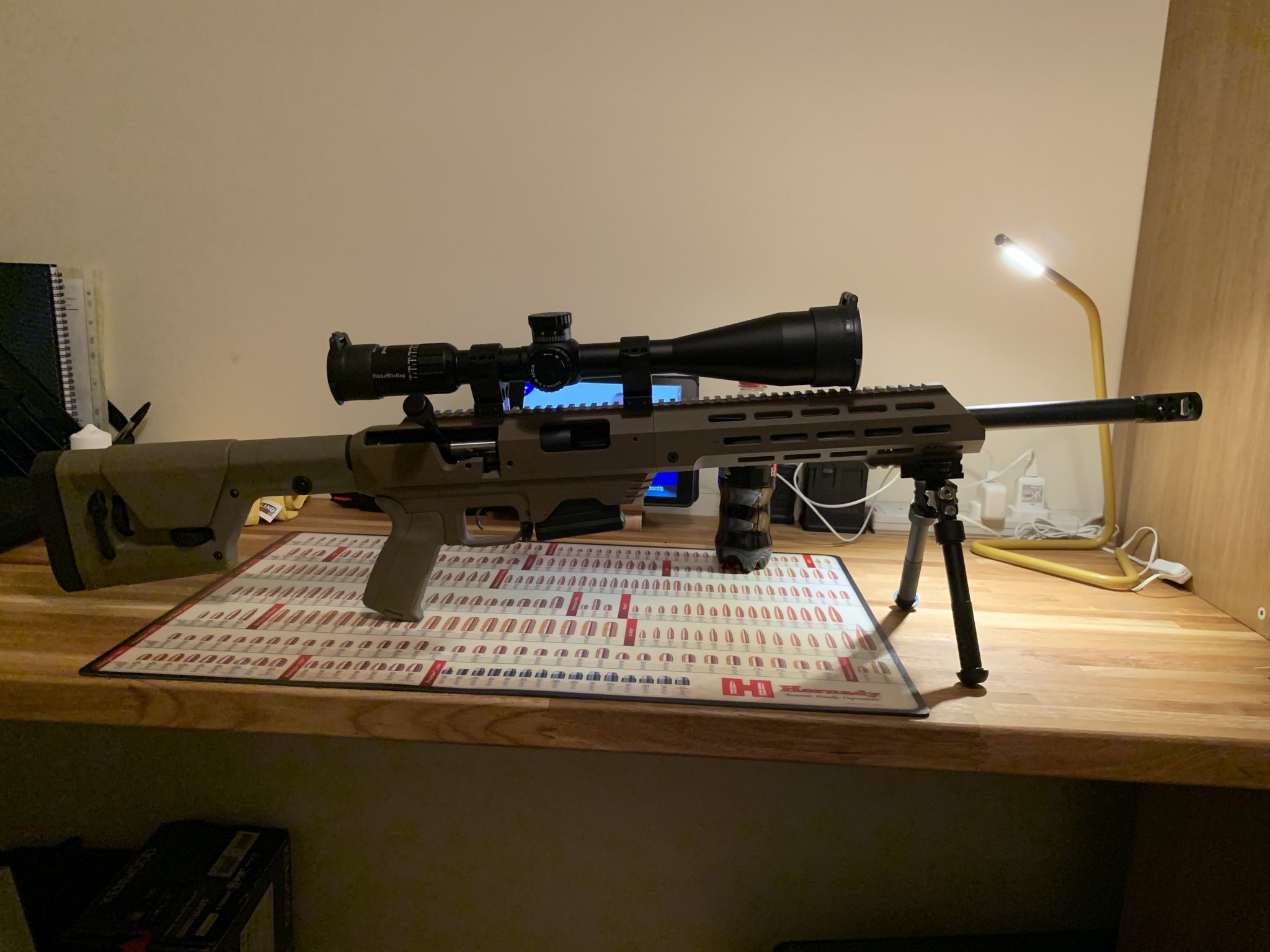

Just thought I’d update this thread,I finished this build today and it’s turned out great

Looks good! How did you deal with the side bolt release?
I ended up just removing it and making a bung from firm sponge that sits in the back,I may have the bolt release machined in but to be fair it works perfectly and bung isn’t noticeable
I had a few issues to get round the recoil lug on the bergara was 1mm or so too wide and the bolt handle fowled on on the chassis when sliding forwards and backwards but my mate machined them both and now it all works flawlessly and looks great
