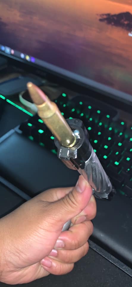

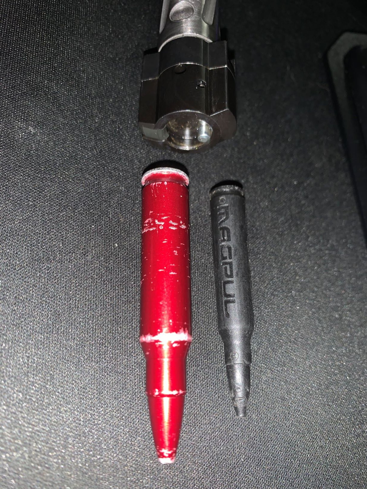

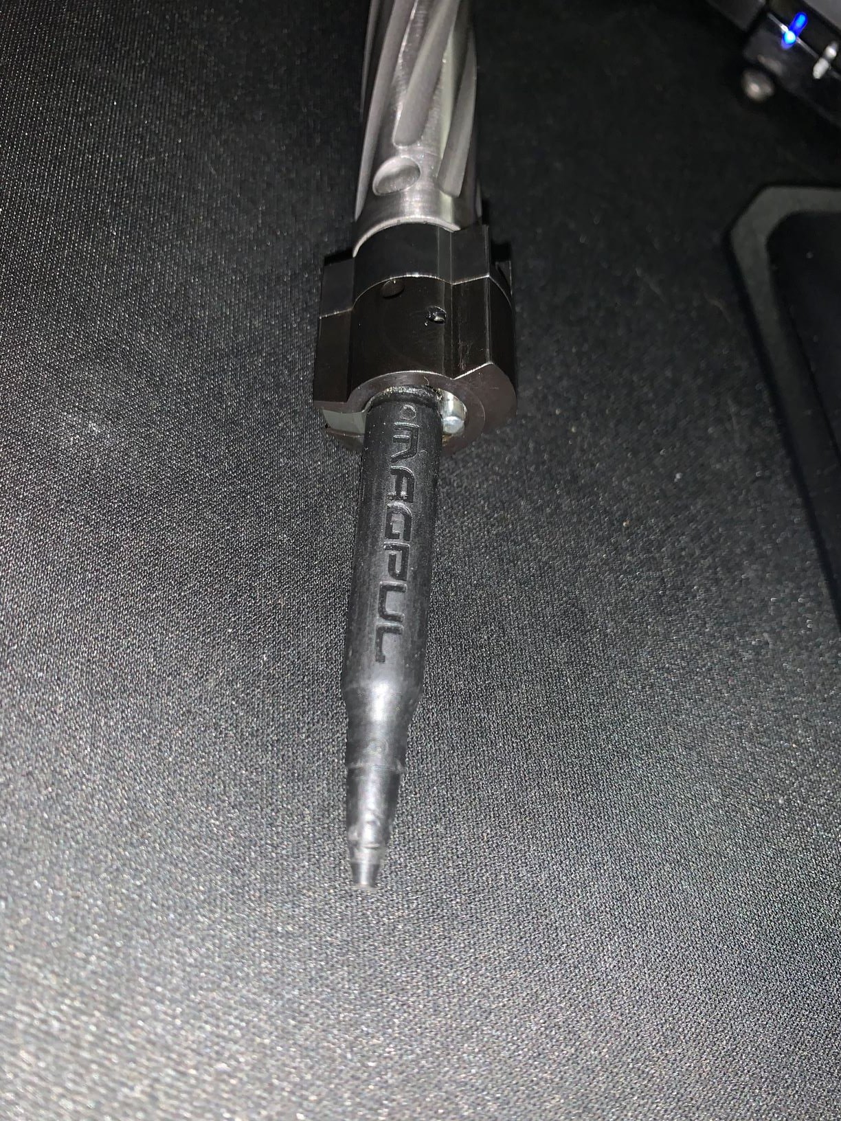

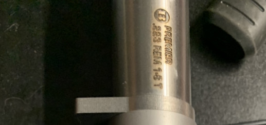

I thought I had the same issue with my new .223 premier barreled action from brownells but it looks like bergara sent me a .473 bolt head instead of a .384
Casing for 223 seats next to ejector and not on it.
