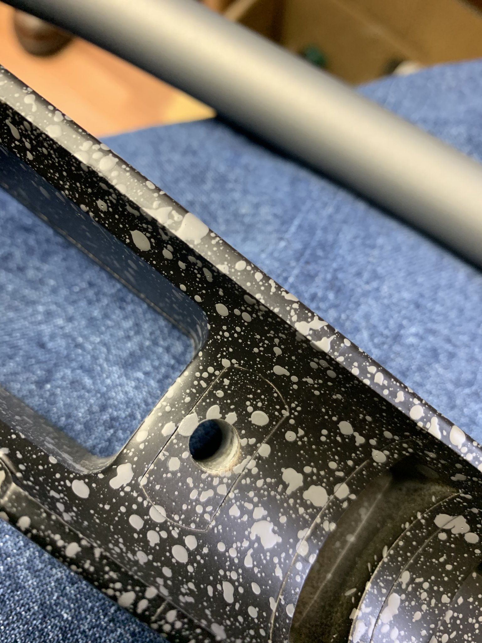

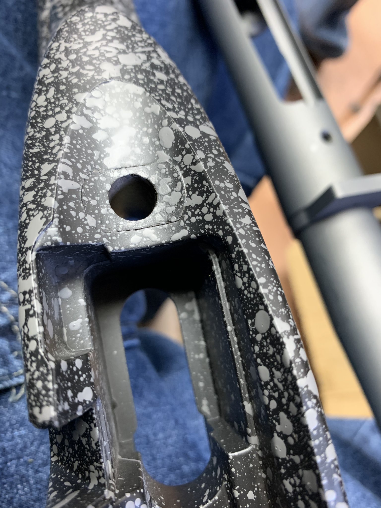

Just got myself a HMR pro in 6.5
Any reason why Bergara would paint the bedding blocks/interior of the stock?
All I can figure is laziness, it would take seconds to mask it off.

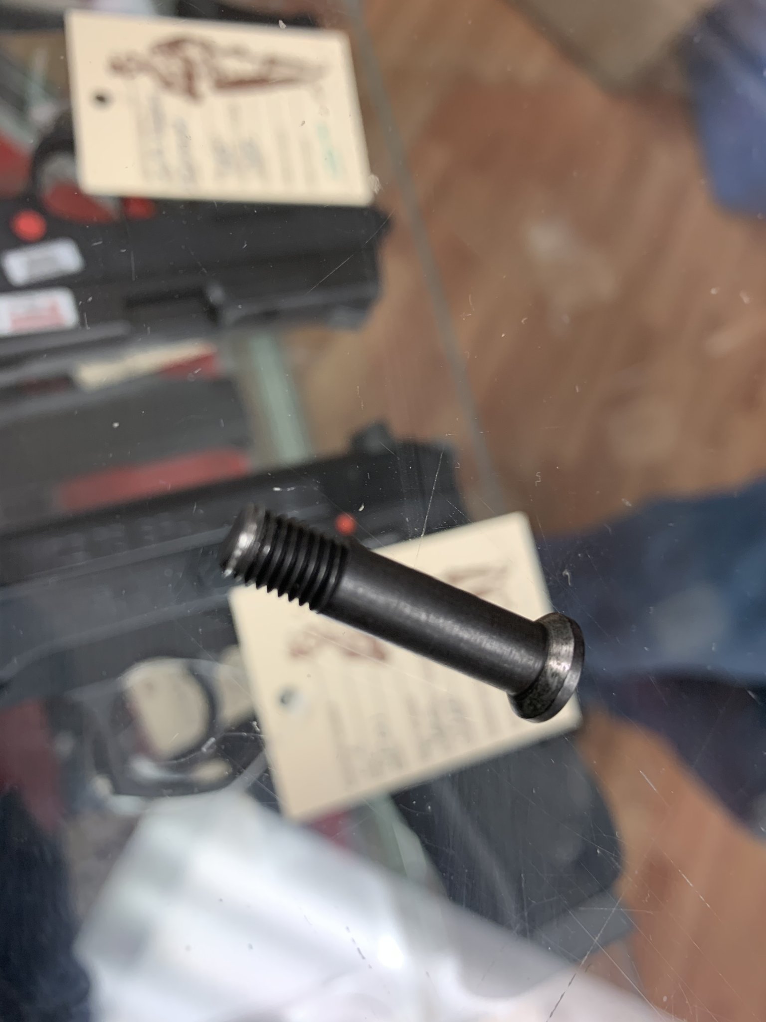

The speckled paint causes the receiver to rock due to being uneven and it was so thick that the front action screw was in just under a thread and a half causing it to pull the threads when they assembled it.
Also the recoil lug channel/recess is so sloppy it’s pretty much not offering any support fore and aft.
Not sure what I was expecting but I didn’t think I was buying a project.

I personally know 2 FFLs that received a pro this year where the barrel wasn’t even tight. They happened within a month of each other so I’m not sure what was happening at the factory. I’ve only had hands on experience with the regular HMRs. I do agree that for the money a pro cost they should have sprung for the masking tape and extra 30 seconds of labor.

Disappointing, especially considering Bergara is only one of a few factory rifles that we think of as better than the average quality.

I had a somewhat similar issue with my B14 HMR .300WM. During the initial range trips I thought the scope mount had worked loose. Upon getting home and looking it over it was the screws though the bottom metal that were loose. when I took it apart the paint had rubbed off around the screw holes from firing and strangest of all there was a puddle of oil around each screw hole.
After cleaning everything up and torquing the screws that one time I have never had a problem again.
