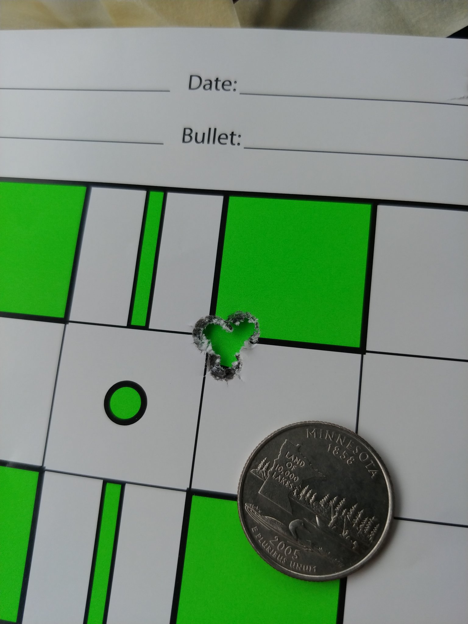

I picked up a 'pre-owned' Bergara LRP right before Christmas and have only had an hour at the range with it, but it seems to like the
Hornady 140 ELD Match... I got a box of 147gr to try when it warms up. (photo is best 3 @ 100 yards).
