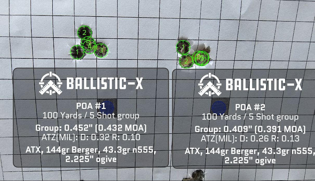

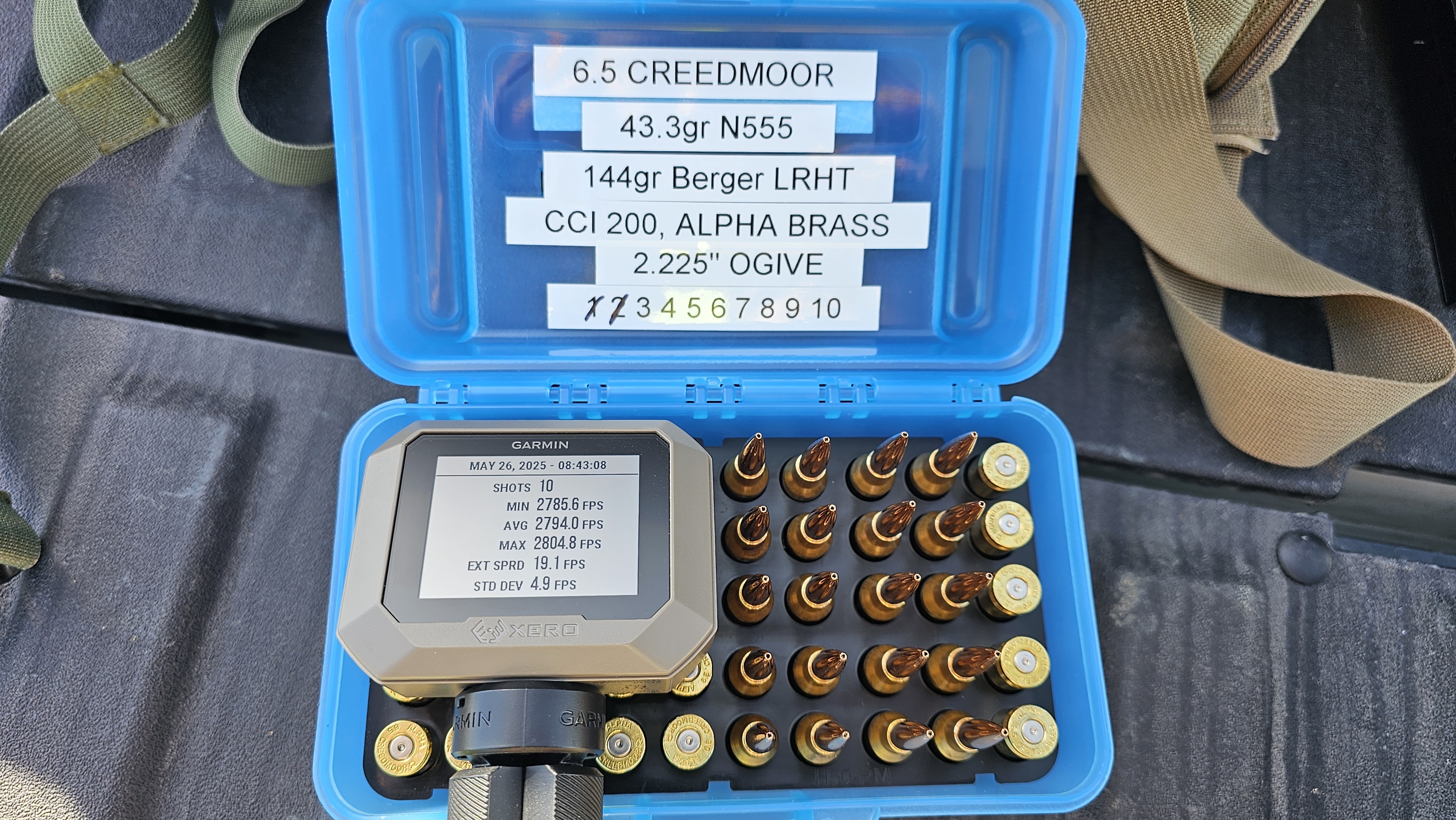

I decided to mess with the 144gr LRHT and settled on this load for my 24" 6.5 Creedmoor AI ATX. They seemed to jump well between 0.010"-0.020". 2.800" COAL worked pretty well too. I was thinking about trying H4350 as well.
43.3gr N555

Triple nickel is shooting very well in my 25 creed my next favorite is RL 16 but it’s dirty. Never had the luck with h4350. I should be getting my 260ai barrel this week, would love to try the 144 bergers but they are out of stock everywhere I know to look. Nice shooting
