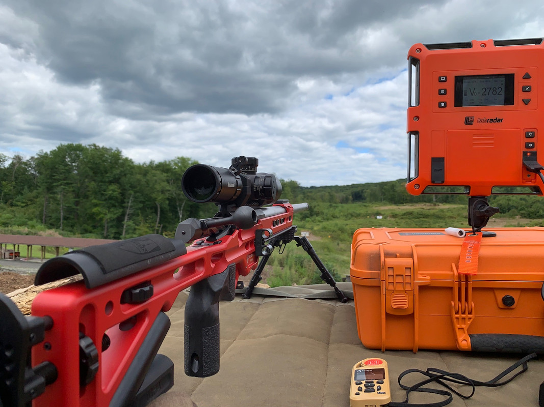

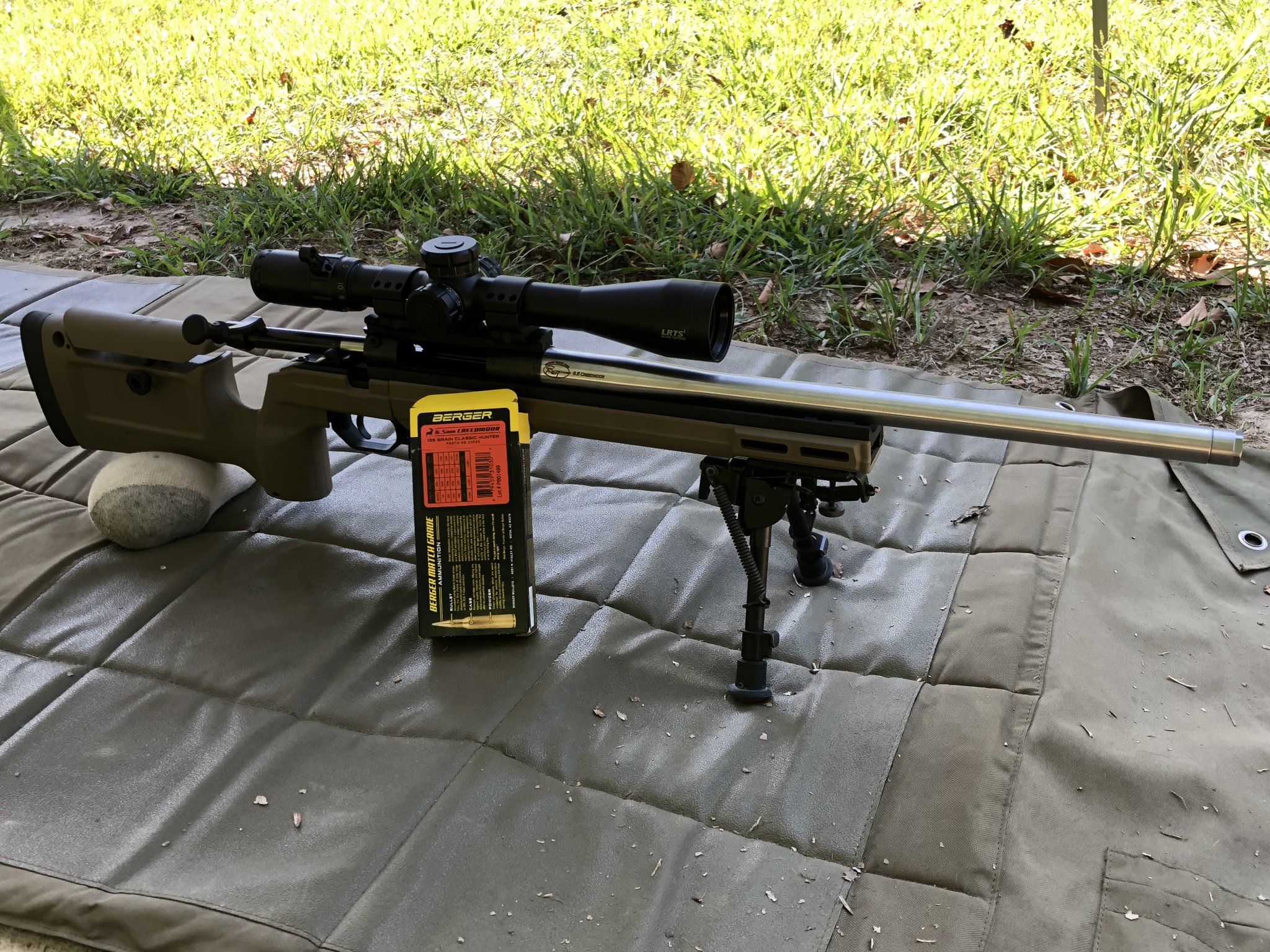

I just stumbled across this thread and thought I could add to it. I bought a few boxes of the 135 Classic Hunter, and a few boxes of the 140 Hybrids for some testing in two of my rifles.
Was a pretty nice day.
76 Degrees
60% RH
DA of 2573
Dewpoint of 64
Barometric was 28.78

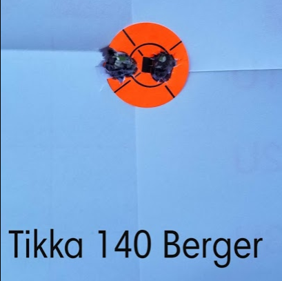

I shot the 140s out of a Tikka with a Criterion Pre-Fit that is finished at 26 inches with a PVA Brake.
Velocity averaged 2843 out of 9 shots. SD was 7, ES was 24.

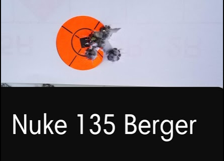

The 135s I shot out of my Nucleus, also a Criterion barrel at 26" but with a Rugged Surge on the end.
Velocity averaged 2818 out of 10 shots. SD was 19 and ES was 68. I did have one round that flew at 2765 which was much lower than the rest. If you remove this round, the average was 2824, SD of 5 and ES of 15. Groups were both easily sub MOA.

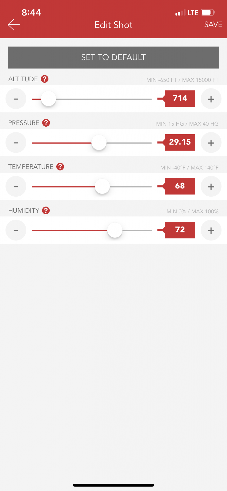

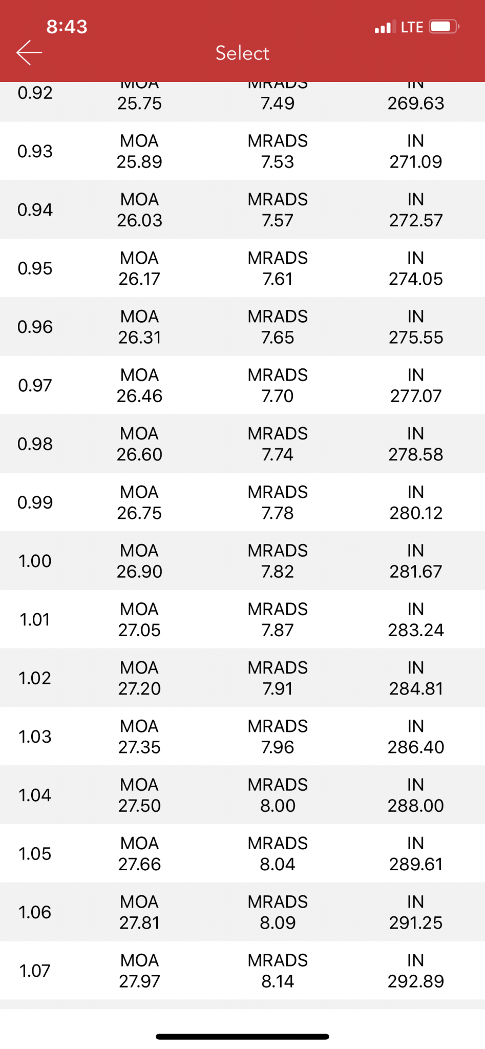

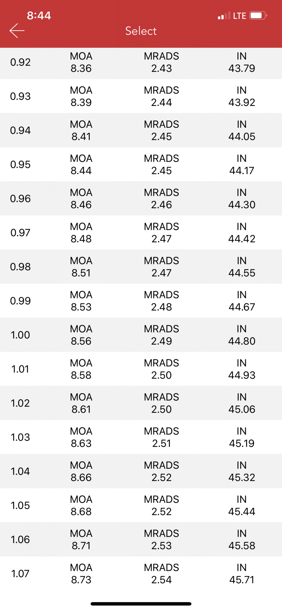

Sweetnset up. I'm guessing those re the 140ELDm s? On the 4DOF do you mind sending photos of axial form factor truing screen? Is it anything like the app ?any feedback on that would be greatly appreciated
I’m shooting the Berger 140 Hybrid factory load. I had to set AFF at 1.05 to get the right drops for 995 yrds.
Oh right on. Can you ou a screen shot of where you manipulate the AFF please. I in no means question your AFF to achieve Impacts at distance I am curious to see what the difference in a standard 5700 Kestrel and 4 DOF look like . I'm trying to use snipers hide members and their resources as an inside look prior to purchasing
I bought a couple cases of the 135 classic hunter to break in my new GAP hunting rifle. First six shots ended up like this. First 3 shot group on the right, second group on the left. 100 yards. Chrono’d 2720, my barrel is a 20” Bartlein #3 8 twist with Ultra7 6.5 on the end.
Copy all on your DOPE . I like using the 4 DOF App and seeing from others if the Kestrel version is worth it and how it looks inside
You can type it in on the 4dof web app and export it to excel.
Also, all I can say is that I don't see any of the issues of BC needing to change at different distances or varying slightly to true to a range. 4DOF with a correct 100 yard zero and it goes out to distance on every range I've been too. Only issue with 4DOF is i wish it had a scope calibration field instead of changing the drop and wind at once.

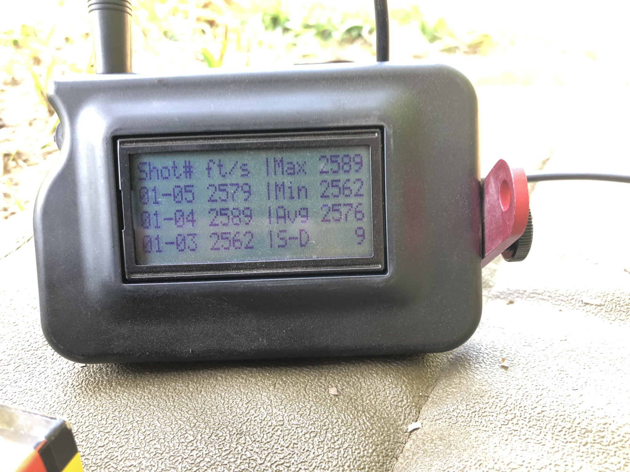

Shots 16-20 from a brand new PVA 18” Medium Palma 1:8 barrel with 135gr Classic Hunter @ 100yd.
As an intermittent, intermediate hobbyist with maybe 200 rounds downrange YTD, saying I’m pleased with this ammo (especially at the price point) is an understatement.
ETA: velocity is shots 21-25 via Magnetospeed V2
