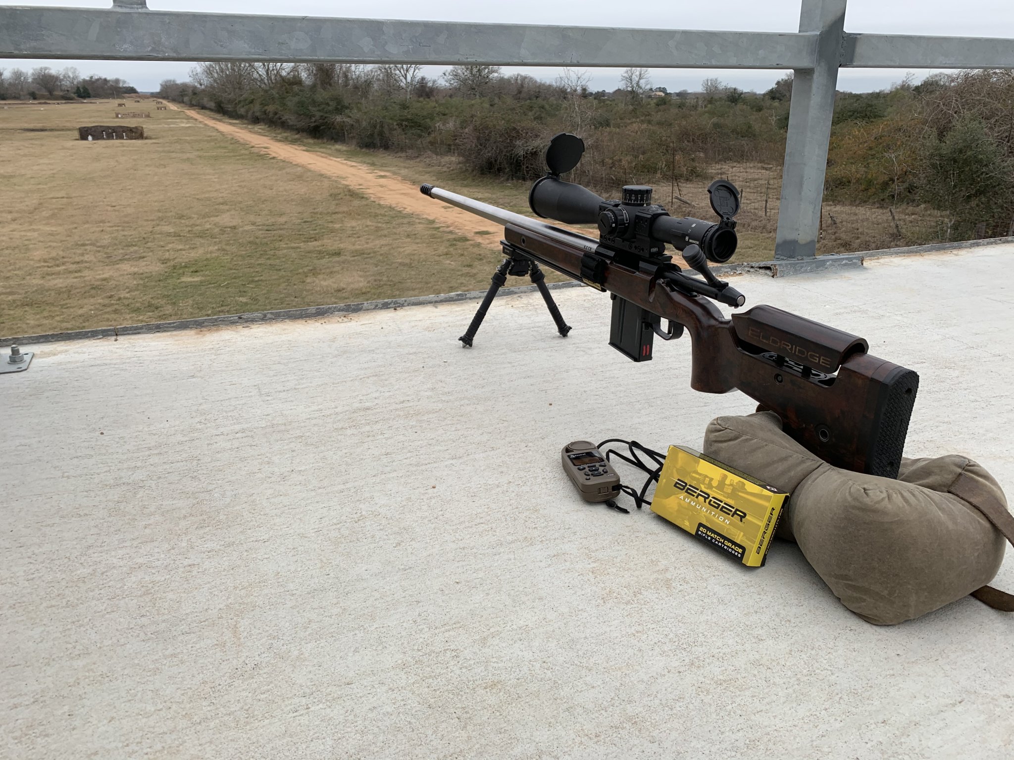

    I picked some of this up a few weeks ago. Running 6.5creed, hawk hill 26" mtu, 420rnds thru. Mv off MS was 2828, Sd of 9.4. Put the CDM in my Kestrel and ran from 300 to 1100. CDM was spot on all the way out.
    Lapua brass ,SRP, Berger hybrid 140 for 26.50 per 20 rnds. Hard to even handload for that price. Used them in a club match a few days later. Absolutely spot on every stage.
    Excellent ammunition. My only concern is in my padt experience with handloaded hybrids as the throat wore they became inconsistent at all distances.
    Returned to 140 ELDs and never had that problem. This was observed over the life of 3 barrels. Other than that, imo these are fantastic performers.

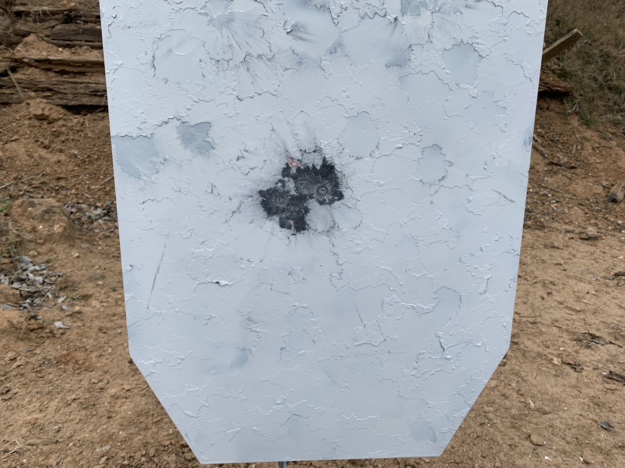

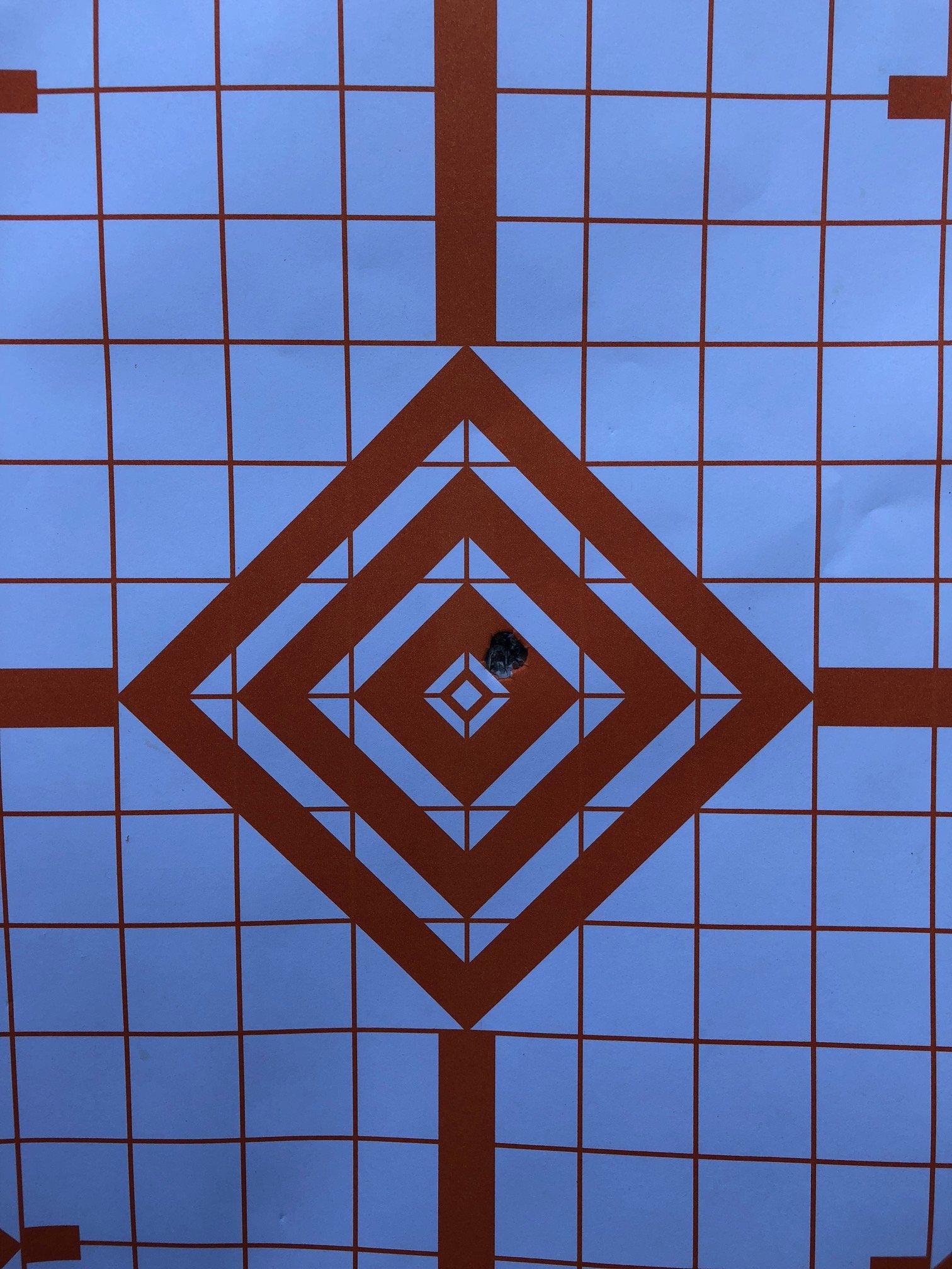

    Zeroed a new 6.5 creed barrel and shot a couple groups at 100. All sub 1/2 moa. Ran it out to 1000 yesterday and shot a ridiculous 5 shot group. Hard to believe that factory ammo can be this good. I’m definitely shooting all the club matches with it this year.
