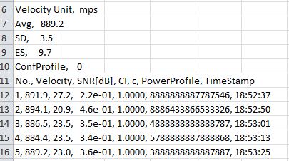

Did some load testing.
Lapua small primer pocket brass hold better pressure than large.
Shot 136gr Scenar-L with VVN160 from my 21" Krieger.
Primers flew from couple of case and damaged my Tikka ejector.
Had to remove these and strip the ammo.
This load works fine with the small primer pocket brass.
Accuracy was phenomenal and speed, but harmfull for the gun as used with large primer pocket brass.
