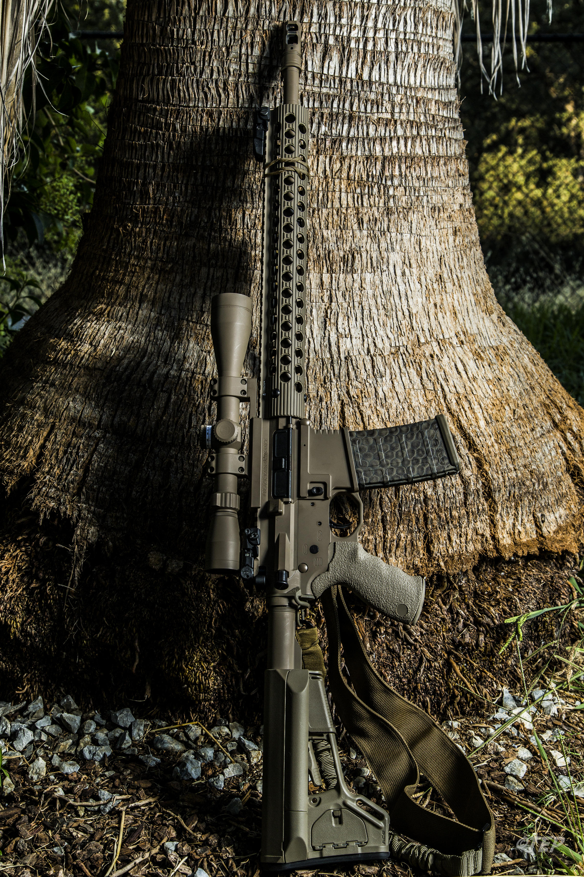

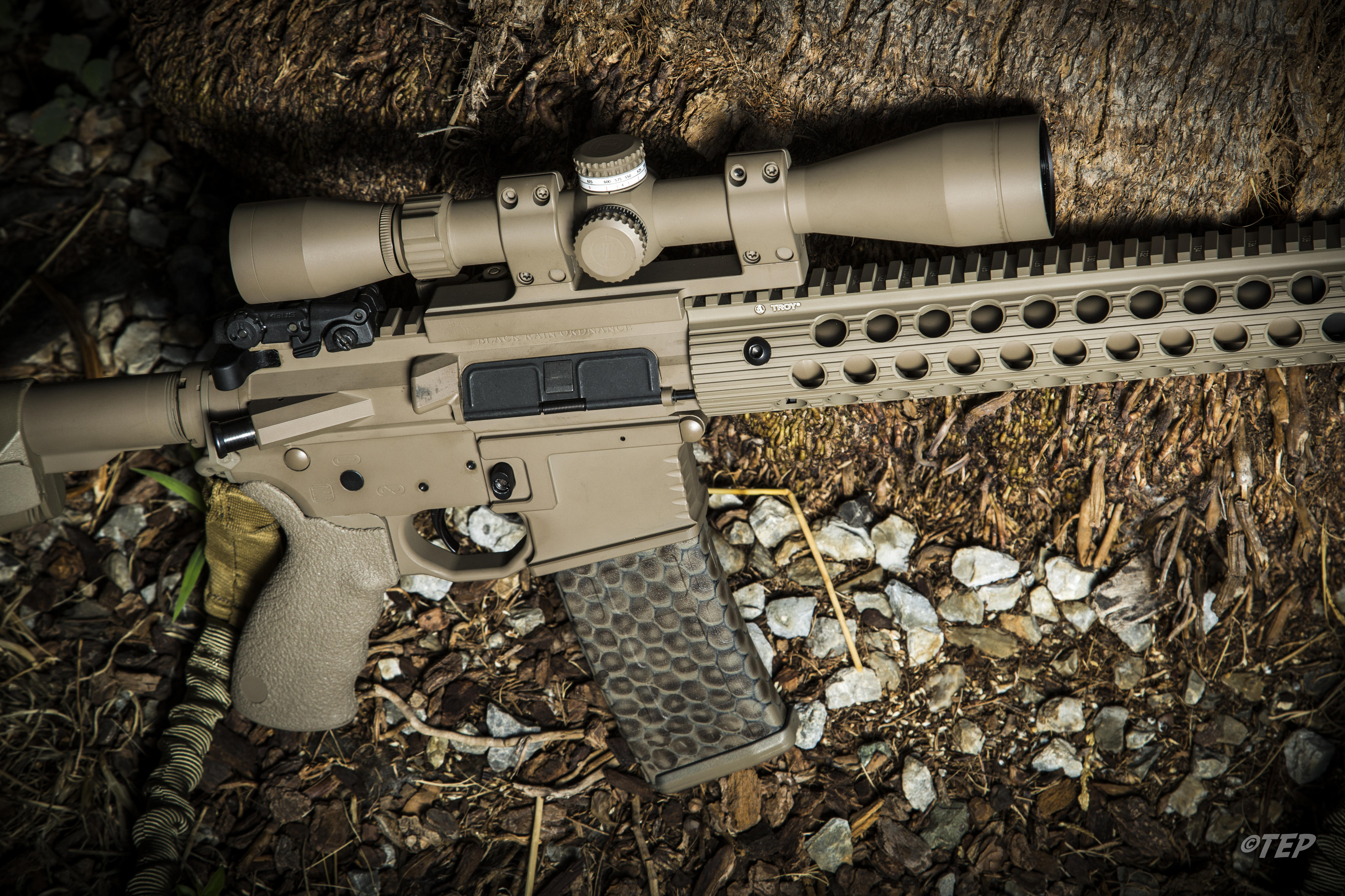

Leupold Mark AR 3x9 TMR w/Firedot. $500ish, I think. Been excellent on mine so far, 5-yds to 600yds
