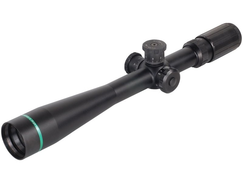

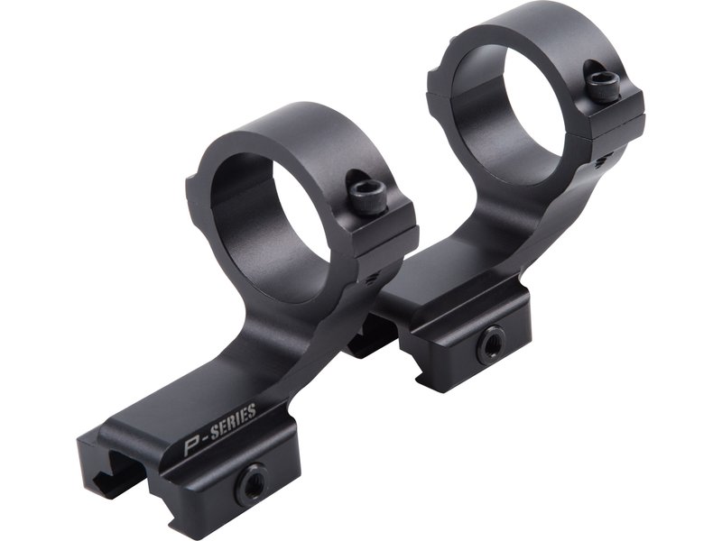

Nikon P Series 30 mm rings mounts Picatinny type $44.99/pr 413176.jpg
All of this and it's still within your $1200 budget (List prices total $1104.97)
