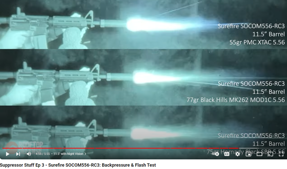

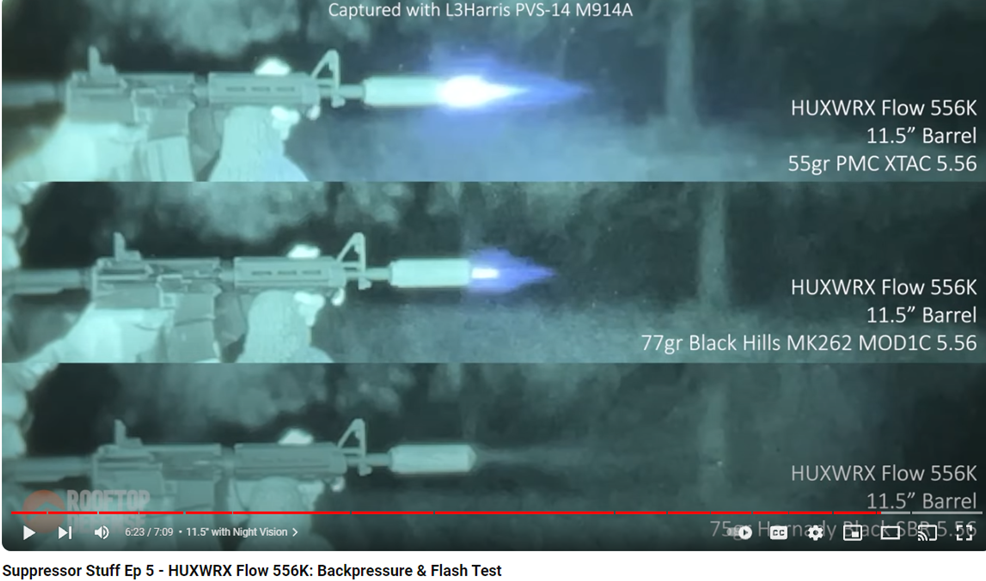

This channel has an interesting way of testing suppressor backpressure: slap it on a 249 and see how much it increases the rate of fire. Worth a watch.
OMG, what a freaking flamethrower!!! Barley better than the RC2 at night. Come on Surefire, it is 2024, you really can't figure out a way to integrate better flash hiding? Sadly people will buy it without doing any research because it sure Surefire on the side of it.
I have been reading a lot of good things about the Liberty Precision Machine Torch for flash hiding and low pressure. If I didn't have my Sand Man S this would be on my short list. CAT performs well but good luck proving you have all their components on if you get a baffle strike (hard pass for me).
I know that one of the Surefire muzzle devices causes a bigger then normal flash (maybe the closed tine flash hider). I use the comp and do not have that flash issue but I have only shot two 77 grain ammos out of it. My 556 flow burps fire every six or seven rounds. As long as we are talking about bright things at night, the Hux heats up really quick and you can see the glow with both nods and thermal after just a mag or so.

No runout issues on the Flow 762 or older HD 762Ti that I have. Both are Titanium and zero runout issues, checked with alignment rod and they've been perfect on all my rifles. Just because something is an additive process doesn't mean it can't be machined after the fact. No knowledge who does or does not in fact machine the bore after printing, just stating. I think there's a lot of internet gossip that gets blown out of proportion. I've done precision testing on a bolt gun and both were just as good in terms of precision as well as return to zero after removing and re-attaching the suppressor as a standard baffle can. That's a sample size of one so...

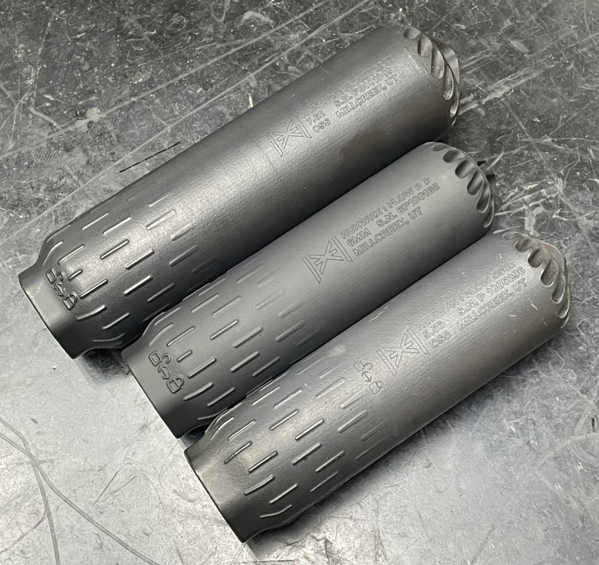

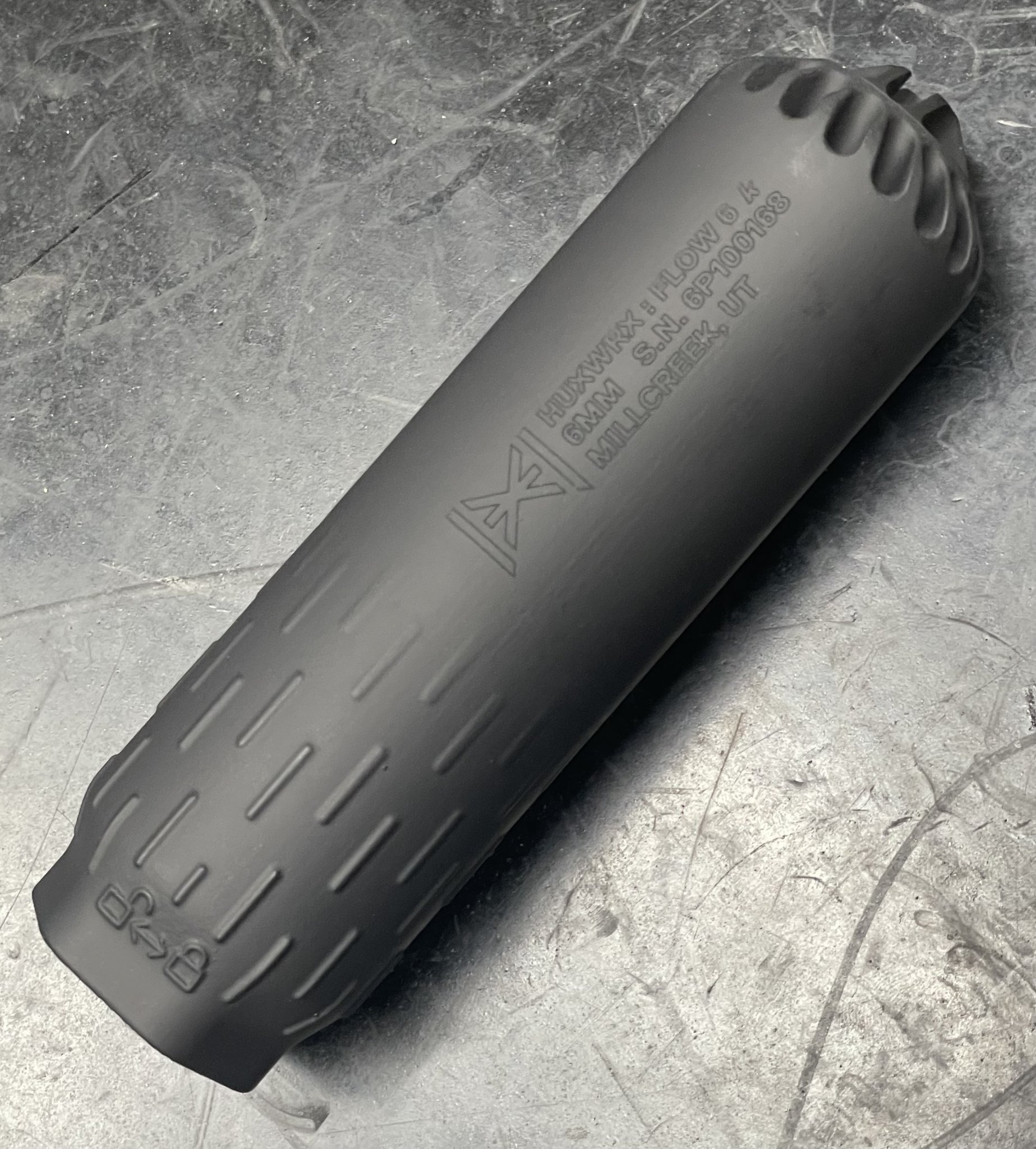

Would you mind comparing the Hux 6k to the flow 762 on a 6mm arc gas gun? Curious if the FRP and any other performance is substantially different enough to warrant getting the 6k over the Flow 762.
I will and I am not being snarky.
The 762 will suppress 30 cal, 6mm, 5.56
The 6 can will suppress 6 and 5.56
The 5.56 will suppress 5.56
Behind the gun, they all sound the same to the shooter. I think you would need a sound meter to notice any difference. I have done nothing to see if groups are more accurate when you match a caliber to a specific suppressor.
Agree. Have all 3. I can’t tell between 6 and 762 on an 18” 6arc gun. Just a size difference between 556 and 762. At this point, I just wouldn’t buy anything but a Flow 762 for anything. There is zero practical reason. I’m sure a machine can measure some difference, but human ears can’t.
