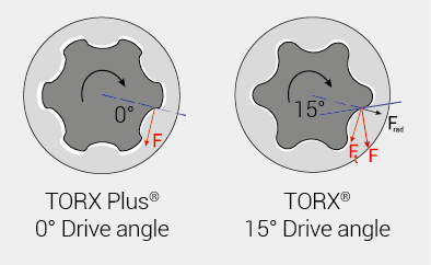

Keep in mind that there are 2 versions of TORX screw drive. The original TORX and TORX Plus.
TORX PLUS® DRIVE SYSTEM
