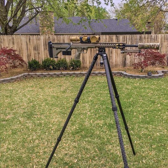

I stand at 5'11" and use the TVC-33 as pictured.
