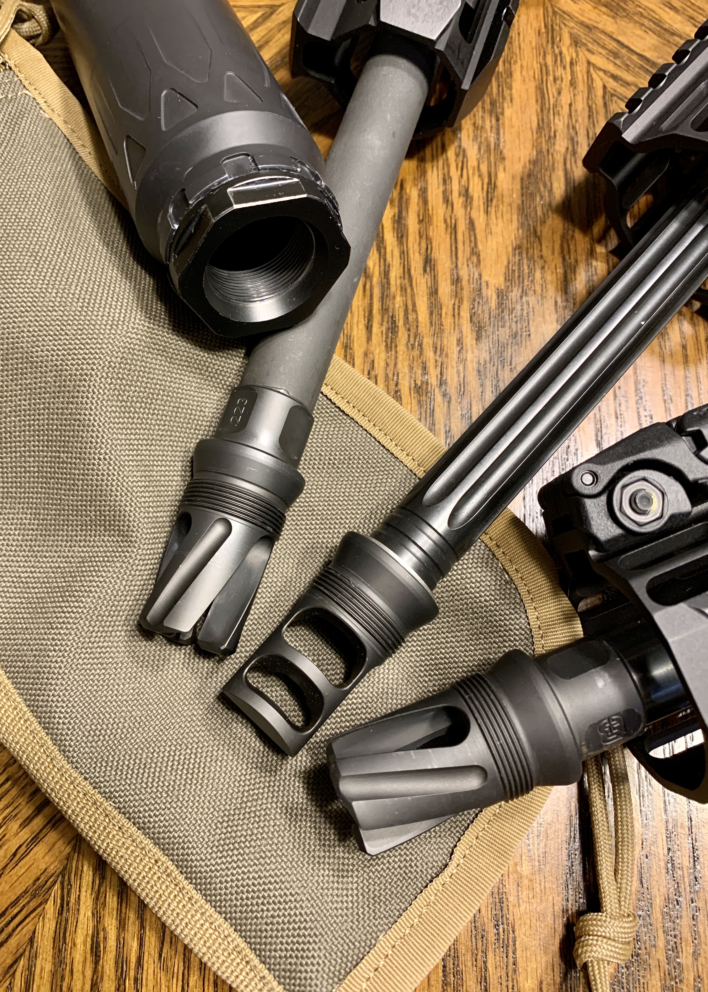

Here's my 300 BLK setup: 8" barrel, 7.3" handguard, Q Cherry Bomb, Wolfpack Armory Low Profile Plan B HUB adapter. I'm not really a fan of the Cherry Bomb wrench flats being on the muzzle but I got it second hand and just wanted something to hang the supressor on. It's ran 100% suppressed, as God intended for this cartridge.

Reactions: TonyAngel
Pics:
A shooting friend of mine is running that setup with his Cobalt Kinetics suppressor. When I first looked at it, I thought it was a direct thread setup. It is indeed compact.

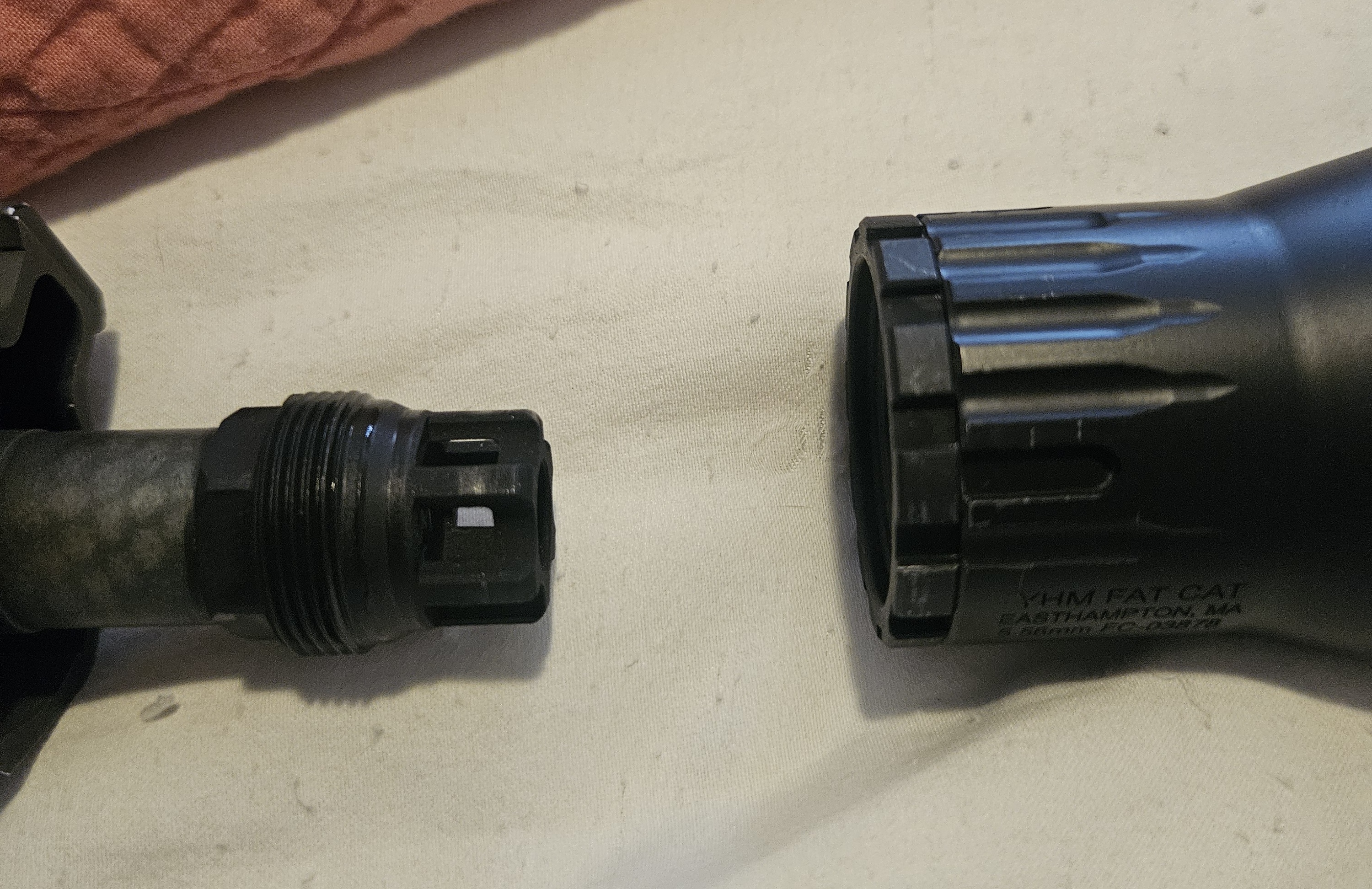

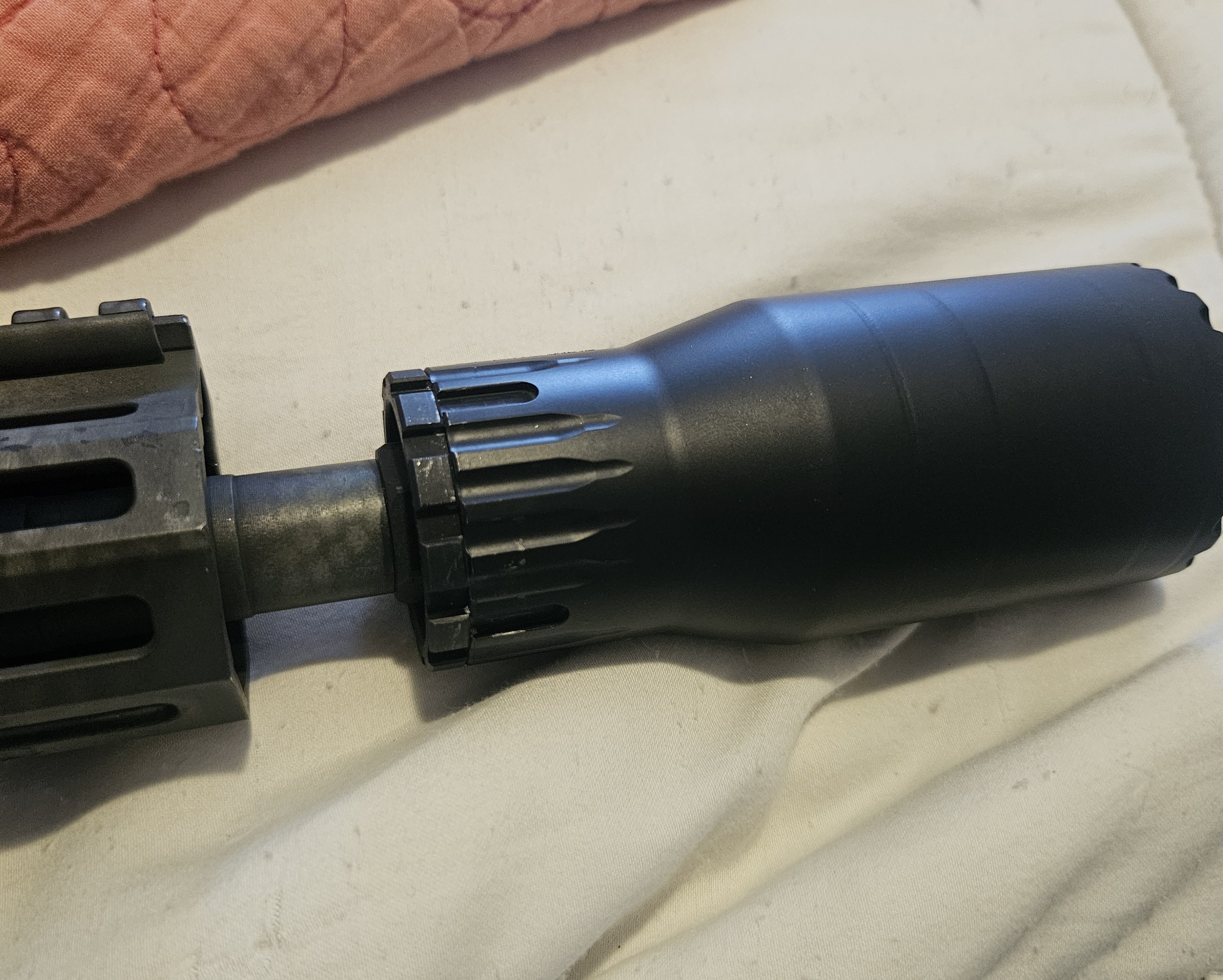

This is the SRX setup that came with my Fatcat.
