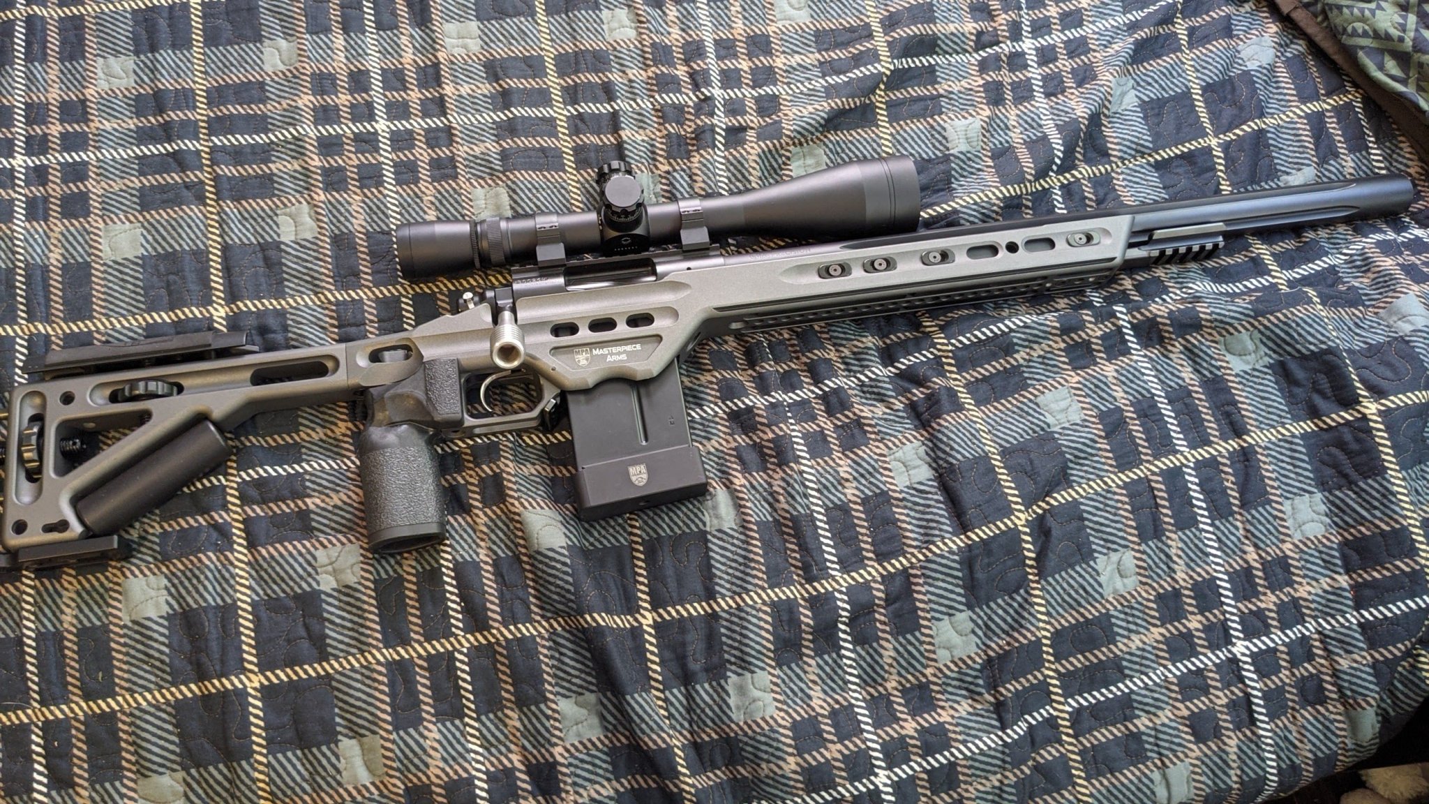

Nice rifle. H4895 and 8208 have given me very accurate loads in the 308.. Usually you look for a powder 5hat that fills the case to about the case wall shoulder juncture and leaves a small amount of air space with the bullet seated and gives near book maximum velocity. the last 2 308 rifles I worked up loads for friends were an x bolt and mannlicher schoenauer and in less than 12 shots had 5/8s and 3/4 inch hundred yard groups. Both light shorter hunting rifles. Sierra 150gr gamekings.
