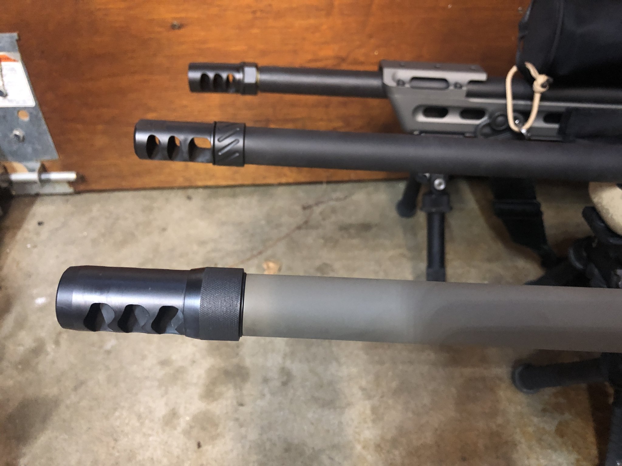

For mid calibers like a 6.5ish, here is my take on a couple of the popular self-timers as a pro-cons list they are all good.
Front to back:
419 Hellfire
Heathen
APA Little Bastard
* Used on a couple hunting guns running CF Proof Barrels - lower weight not much practical purpose for matches.. It is good looking and as a nice leveling flat
** Need to use a wrench to install inner centering mount, can come loose as the brake installs with reverse threads to the adapter, if you don't use a bit of locker on the inner threads or don't over tighten the outer knurled nut. But that adapter can double as a thread protector or Can mount. Also has a leveling water-line in the front.
*** Uses a tool but always seem to stay tight without much effort
Reactions: Sheldon N
