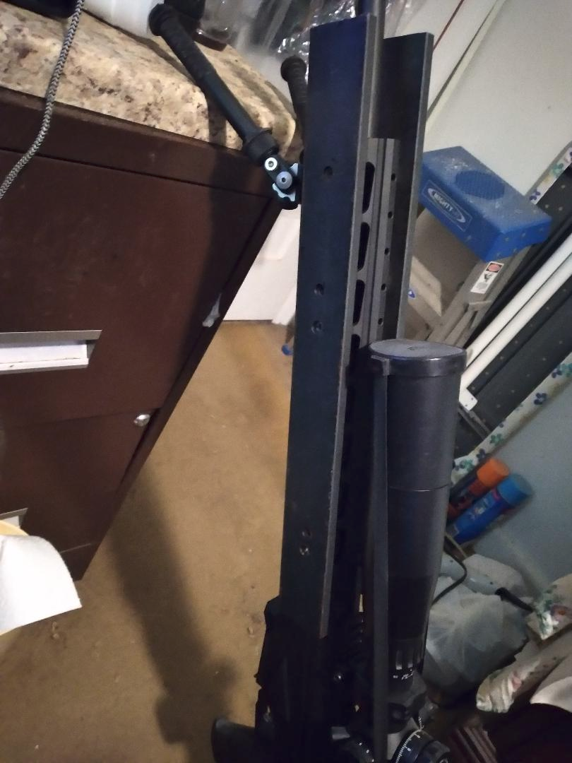

they say a picture tells a story to me its just ugly but it functions nice
also another good thing so far even in summer time the plates are attached to the barrel shroud have not impeded air flow enough to keep the barrel from cooling . just another option if you wanna add weight to a gun good luck which ever idea you go with .
