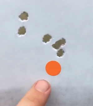

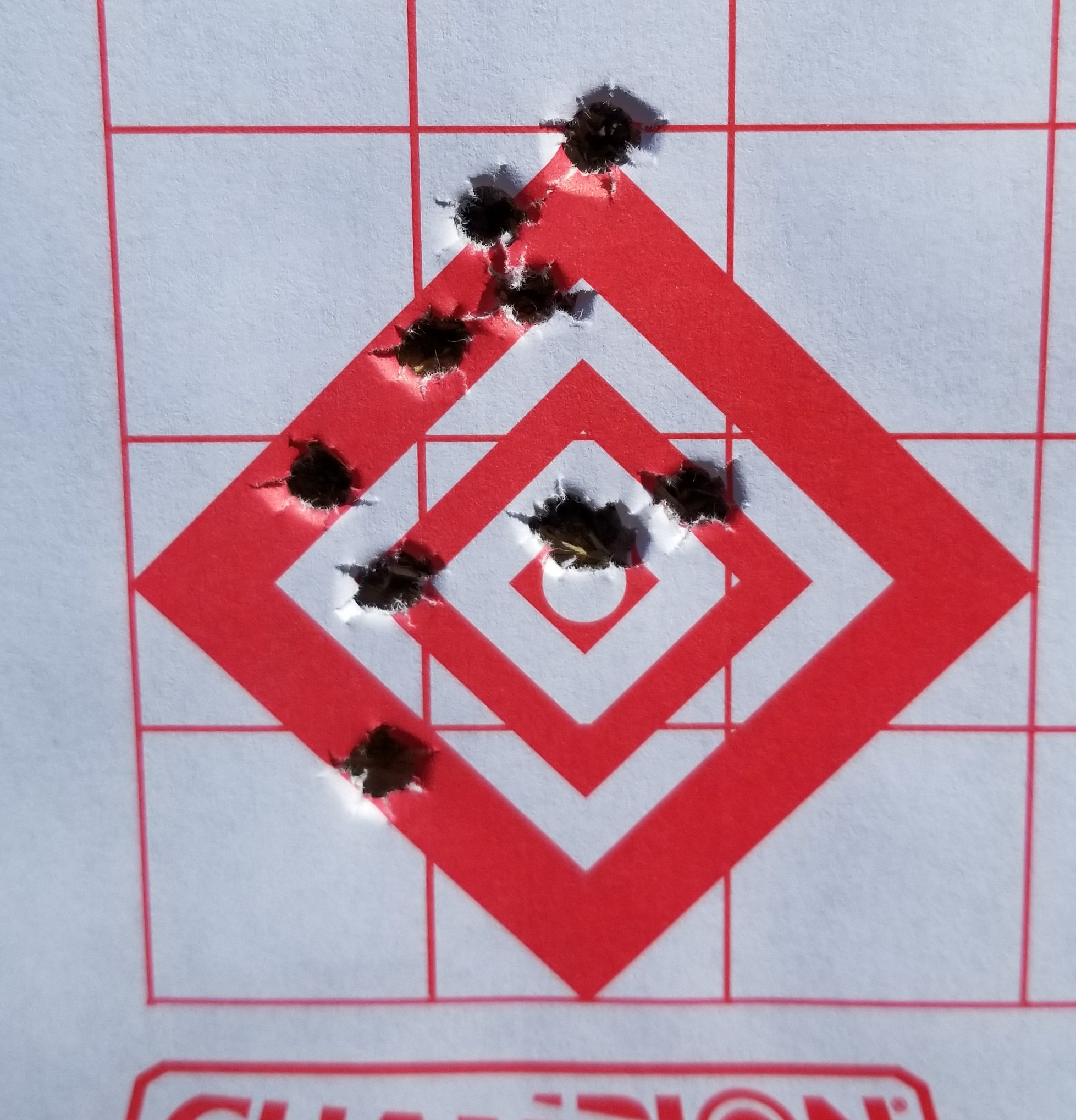

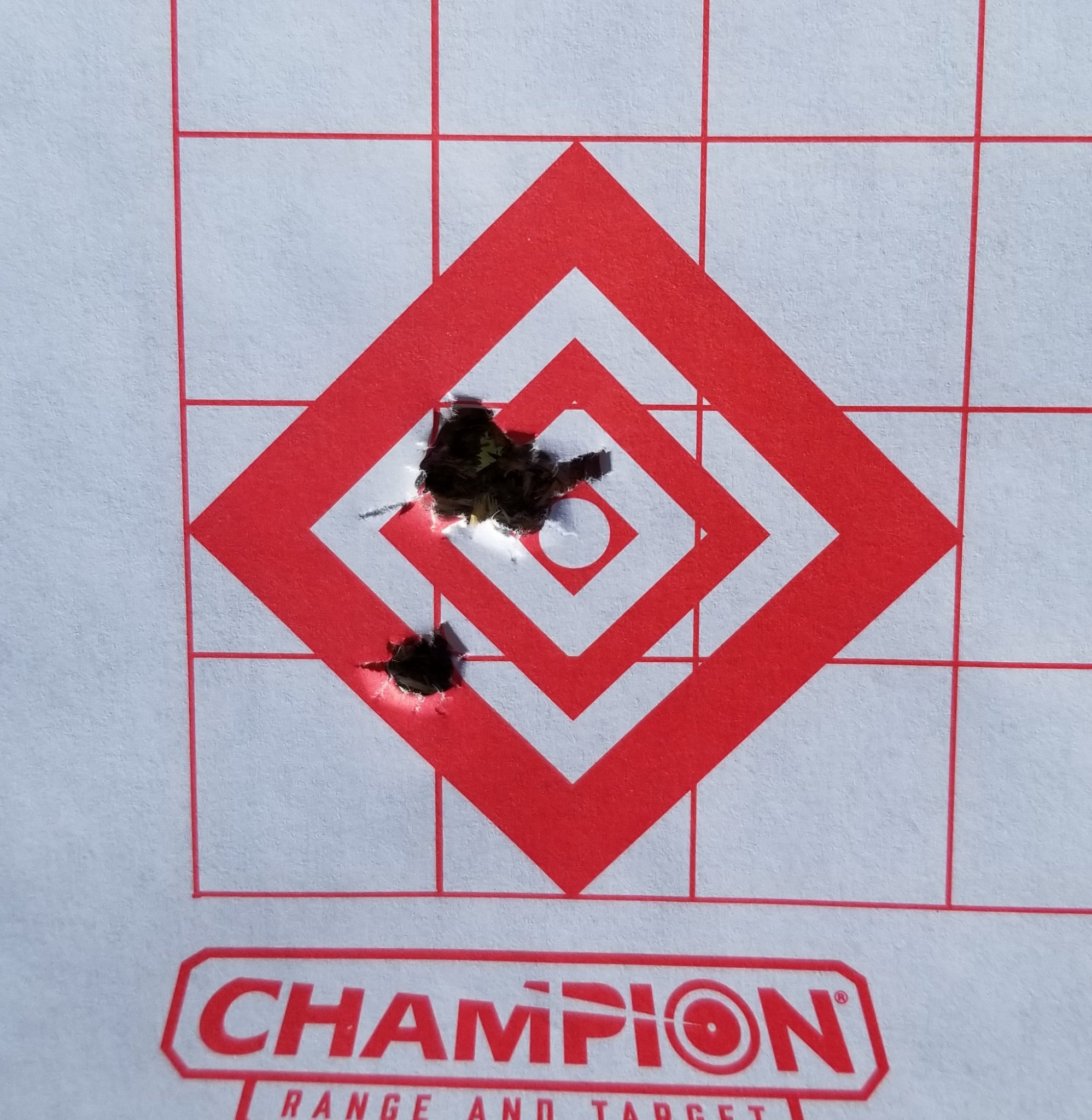

I'm newer to this game and I strive to be student of my efforts - I shoot, I think about what I'm doing, I read, I ask questions, I watch youtube videos, I go shoot some more. I've been shooting my T3x varmint 223 for several months and have finally had a realization that my cheap .223 ammo is part of my problem. I know many of you will chuckle or roll your eyes, but I've been feeding my rifle Wolf Gold and Remington .223, both in 55gr. My groups look something like this at 100 yards with no wind.

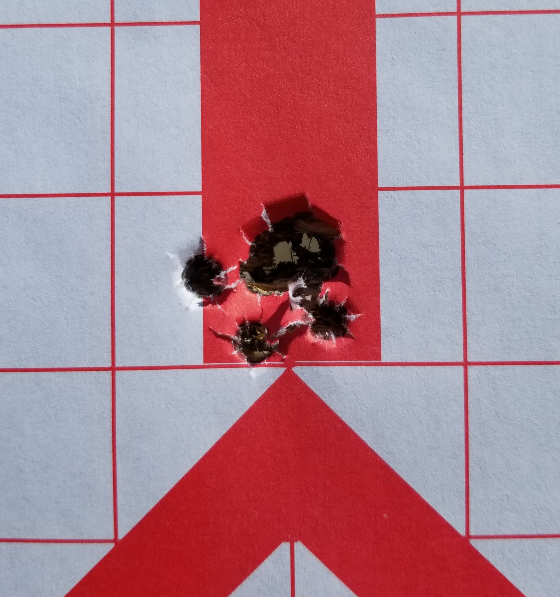

I thought I was having accuracy issues and the student in me was trying to figure out what I was doing wrong after each shot due to the lack of consistency. That frustration has driven me to do a lot of reading and researching on proper technique. On my last trip to the range, I took my new T3x varmint in 6.5 CR and after shooting the target shown above, shot the 2 below with some not-so-expensive S&B 140gr rounds. The first is 6 shots, the second is 10 shots. After seeing these groups, I concluded that I probably wasn't having an accuracy issue with my .223, rather a precision issue due to my cheap/crappy ammo.
All of this is to say that I'm open to suggestions for "better" .223 ammo. I've got some AR's, so burning through my cheap .223 ammo will not be an issue.
I am open to feedback and discussion, and I see my options including the following:
1. Keep shooting this ammo. Maybe some of you will look at the top target and tell me I can do better with Wolf Gold. If that is the case, I'm open to hearing that.
2. Find a "better" mid-priced 223 round, preferably in the sub $.75/round range. As demonstrated by the 6.5CR targets, I feel like I can do better with "better" .223 ammo, but I'm not sure I need to get the ultra top shelf stuff at this point.
3. Admit to myself that I was going to reload eventually and purchase a setup for that (if I did this, I'd like to reload for 9mm, .223, and 6.5CR on the same machine). I already have progressive reloaders for 12ga/20ga/28ga, so I'm not new to reloading, I just haven't done it for metallic cartridges before.

The 223 factory ammo is short to the shoulder, probably. 007 or more in your chamber. It is magazine length, long jump to your lands and 55gr is not getting much out of your bolt gun of how it is intended to preform.
Save that brass bump it back. 002 for the bolt gun choose a premium bullet and load carefully from books.
You can stay well within your price point.
Read up on load development on the hide and enjoy that firearm.
I reload 55g for my gassers and it is not hard to outperform cheap ammo for slightly less in the case of the ar.

Guessing that is a 1:8t? If so, consider something above 65gr, even a 77 gr. You are spinning the heck out of that 55 if it is a 1:8.

I run the 55g bullets in ar's because they are cheap, I can hunt with them at 50-100yd for head shots, plink and shoot groups for a 200 yd play day.
I use flat base bullets for short ranges on purpose.
That being said they suck past 200yd for precision from bad bc no boat tail and blow in the wind out past that to a point you will soon be able to outshoot them, I can.
Advise on the hide is 62-75g will take you much farther I will default you to many on the hide with more experience than I for that.
I'm loading for 308 and 6.5 for longer distances since our 556s are carbine and sbr length.
One box of factory good 75g stuff will show you what I'm getting at and when you load your own it will be better yet. In the bolt gun.

You wont get much better than that out of wolf gold. The brass is not very consistent, I have about 2k pieces that I reamed out the crimp and loaded a couple times. Some of the necks cracked on the first and second firing. After the first firing a lot of them were feeling a little loose in the primer pocket, after the second most all of them do, and are headed for the trash can.
I think slapping a 200 yard limit on a 55 is a little short. No, they aren't great in the wind. For 200 in the wind they aren't bad. With light or consistent wind they do ok for 5-600.

The flat base is a detriment at any distance, but that is also probably somewhat negligible at under 200yd. At 100yd, my .223/5.56 55gr bullet is the Hornady bulk FMJ-BT W/C.
For plinking, I use PPU/Prvi-Partizan .223 55gr FMJ, and the brass has worked well, even for my 75gr match loads. For me, bullet choices don't go by type of action, but by barrel length and twist. My AR's and bolt guns have 1:8" to 1:9" twists, and either 24" or 16" barrels. I use the Hornady 75gr HPBT-Match bullet in the long guns, and 55gr FMJ-BT in the short guns (all AR's for now).
One exception, a 16" 1:7" AR, that I'll be trying out with IMI 77gr Razor Core.
The Mossberg MVP .223 has a 20" 1:9" barrel, and I use factory Federal Fusion MSR 62gr in that.

Option 3 is what you want. All factory 223 is neutered for AR use anyways, once you hot rod it for a bolt gun you'll swear its a different cartridge entirely at longer distances.

I agree to reload for the best you can get for your rifle but if you dont want to go down that rabbit hole I wold try the norma tac ammo. You can get the 55gr for the same 29 cents per shot usually as the wolf gold but it shoots way best for me in every rifle Ive run it through. 55gr will start to get a bit anemic past 500 yards. You can get the 77 grain ammo for closer to a buck per shot but I cant speak to how well it shoots. The 55 gr is my go to factory option for cheap ammo though.

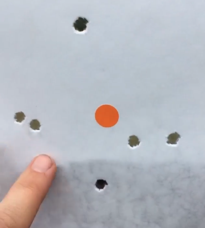

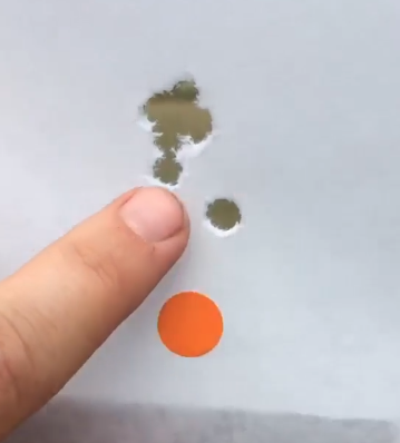

Here are quick screen shots from a snapchat vid I made when running some factory options through my new 223 just to see what affordable option it likes. 1/2" orange dots.
A random 53gr hand load first putting it on paper for the test and then a two verifying shots to ensure I adjusted my zero the correct direction.
Norma tac 55gr- stilll not immune to fliers and/or pulled shots
Federal American Eagle 55- absolute crap as always
Wolf Gold 55- not the worst but far from the best
Grab an assortment of ammo and shoot some groups to see what it prefers.

That Norma Tac looks like good stuff. Thank you for pointing that out to me. I found a case of it with free shipping for $280.
I would be misleading everyone if I said I was never going to reload metallic cartridges. However, I am wildly intimidated by it. I reload shotgun shells, and the idea of choosing 7/8 oz, a pink wad, 18 grains of Titewad, and an STS hull with a Remington primer is so stupidly simple to me. The final crimp is based on "yeah, that looks good." The idea of having to anneal, tumble, de-prime (before or after tumbling?), lube, resize, etc. AND pick one of the bullet weights and styles that varies from 50gr to 80+ grains is daunting. I am not against getting a Dillon 550 or 750, but there is a lot of "stuff" that goes with this endeavor. It also seems like everyone has their own pet recipe or recommendation on what works best.
As I continue to read, learn, and shoot, should I be keeping all of my Wolf, Remington, and WWB brass? Some of it has dents from being ejected from and AR-15.

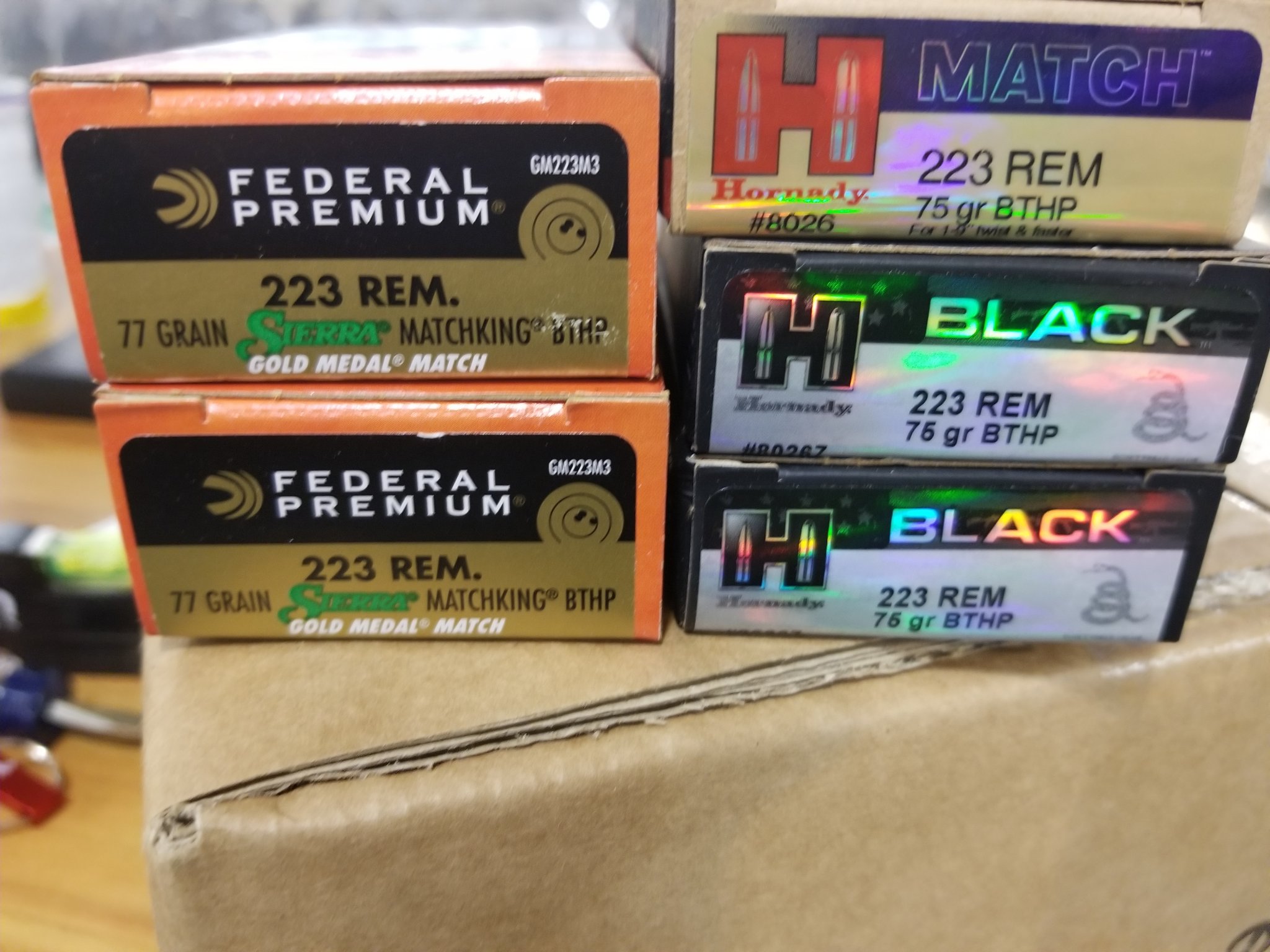

The UPS fairy dropped off some ammo today, including some 75gr Hornady.

I load my AR 50 and 53 gr VMax ammo on a 550 with H335 or CFE223. I get really good results with it for my AR. I load all my precision ammo on an old RockChucker that I paid $50 for almost 30 years ago.
The 75gr bthp is accurate, but the ELDM blows it away past 600 yards. See if you can find any of the 73 gr ELDM factory ammo.

I've found the 73eld hornady factory loads to do very well out of my 700-223. They are still loaded pretty short but I'm getting a decent velocity and an OK sd number and have had fair results on plates at 850 (shooter error plays into that quite a bit). You'll find that the 73eld has a very good bc considering it's 4 grains lighter than the 77smk but has a slightly better BC.
Reactions: 260284
Codiekfx400
Major Hide Member
Belligerents
Jan 29, 2018
1,253
492
89
Thank you again to everyone for all of the thoughts and input on this subject.
BE careful buying the Norma Tac the old black box stuff that @spife7980 is using is good stuff. But the new Norma Tac is just Federal AE in a Norma box.

I load the Hornady bulk 55gr FMJ-BT over 26.0gr of Varget, and Hornady 75gr HPBT-Match over 23.5gr to 23.7gr of Varget (it's a more or less generic load for 24" barrels, bolt and semi, 1:8" and 1:9" twist. at 23.7gr it was fired side by side in 600yd F T/R competition in both rifles.). I will also be trying it in the 16" 1:7" AR.

Thanks for the heads up. I googled reviews of it last night and everyone (that recently used it) agreed that it was horrible from a precision standpoint.
I've always had good luck with the Norma Match 77gr. It may be slightly above your budget, but it is still short of $1 per round:
drew_235
Belligerents
May 22, 2019
276
99
34
Minnesota
Same or fewer $ as spent to get ammo in that picture above, OP could have had a load developed, gotten exactly the same load later, would be done and shooting tight groups at distance.
With or without purchasing a reloading press? If you don't count the cost of a tumbler, press, does, and other durable goods, I'd totally agree.
Otherwise, it seemed like a good stopgap to keep me plinking while I chase down everything I need. Maybe I'm just wet behind the ears, but that was my thought process.
