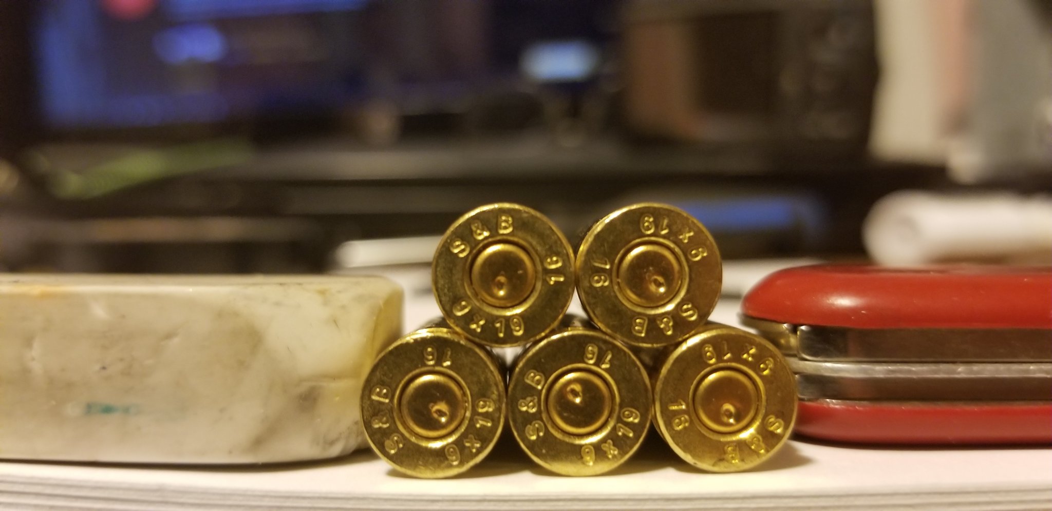

Bought some S&B 9mm and out of 1 box I had 5 no ignitions and a squib. The no ignitions were solid primer strikes and I have fired thousands of rounds from the same gun before and several hundred afterwards with no issue. The squib stuck in the barrel is the bigger issue. I called and emailed S&B twice with no response, very poor customer service. Here is a pic of the ammo and primer strikes. I know some will say how they have never had an issue with S&B, well up till now, neither did I.

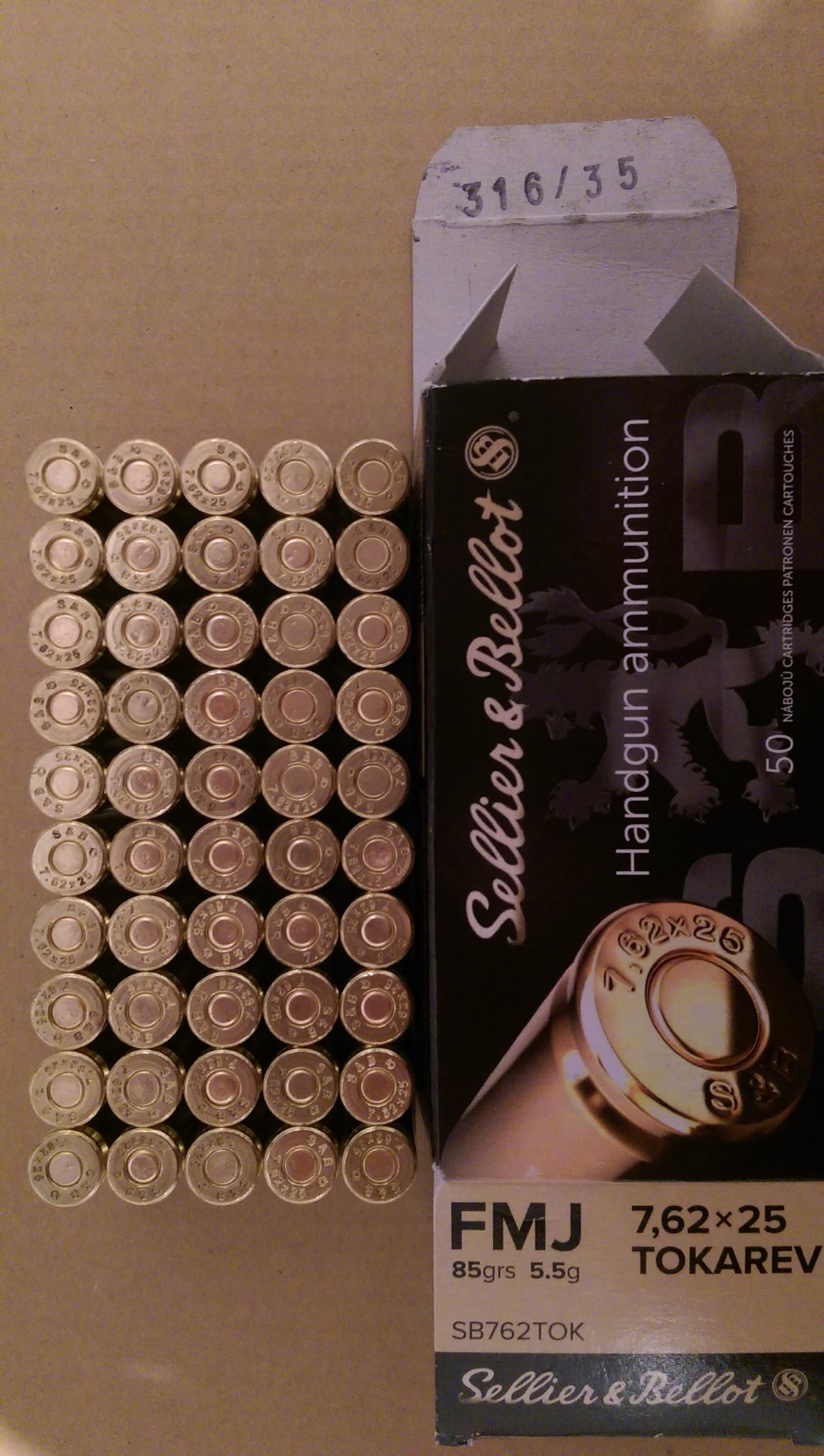

I bought some S&B tokarev ammo, The primers were odd, some were fine some were flat like they bottomed out before they were fully seated and the priming ram flattened them and many primers had multiple little dents on them.
Sent a email with pictures to S&B, nothing. Seems quality control is somewhat lacking.

Whatever, by the looks of the rds that did not fire, your firing pin not even remotely centered up. I'd try firing them again or in a different gun, most likely go off. Or pull a couple bullets and check for powder.
By the looks of those primer strikes I would be looking more at your pistol then the ammo. Those look terrible.
^^^ This. Those primer strikes are really really light. I see a fair number of unfired rounds left in pistol bays with light primer strikes. Before I got smart (realizing that I had no idea whether such rounds are safe to fire), I'd pick them up and shoot them - all discharged just fine.

I would like to see some primer depth measurements. Before and after.
Ammo stored under who knows what conditions for who knows how long have been known to 'relax' the primer.
Then when fired the primer cup is seated again.
S&b isn’t bad ammo tight primer pockets sure but I’ve only had one or two rounds that went bad one the primer didn’t work and the other split the side wall of the case half way up the body. This was out of thounds of pistol/rifle hundreds.
The off center nature of your primer strike makes it a lighter strike effectively. You aren’t straight on the cup so it can impact ignition.
Make sure your gun is going into battery. Clean the barrel interfaces and the chamber thoroughly and tey again.

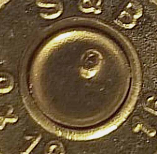

Ok, pulled out the calipers, case length and overall length of the 5 rounds are good, but the primers are all inset (recessed) .0025" to .0045" I have tried to take a good pic of the primer hits. I agree they are not centered, but why would another lot of S&B work, but this lot didn't. Here is the best pics I could take, the primer hits look deeper in person than in these pictures. I went htrough a bunch of older brass and see similar strikes, I will try them in another gun and see what happens.

I've had some of my own reloads go off in the same gun, at the second try. The problem with those was that the primer was not seated quite deep enough. The first strike seated the primer and the second time fired them.
As others have mentioned, your strikes being off center and elongated made me think that there could be something not-quite-right with the pistol too.
Going to contact CZ to see if this is abnormal for one of their guns.
