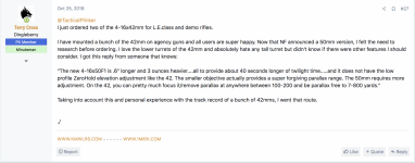

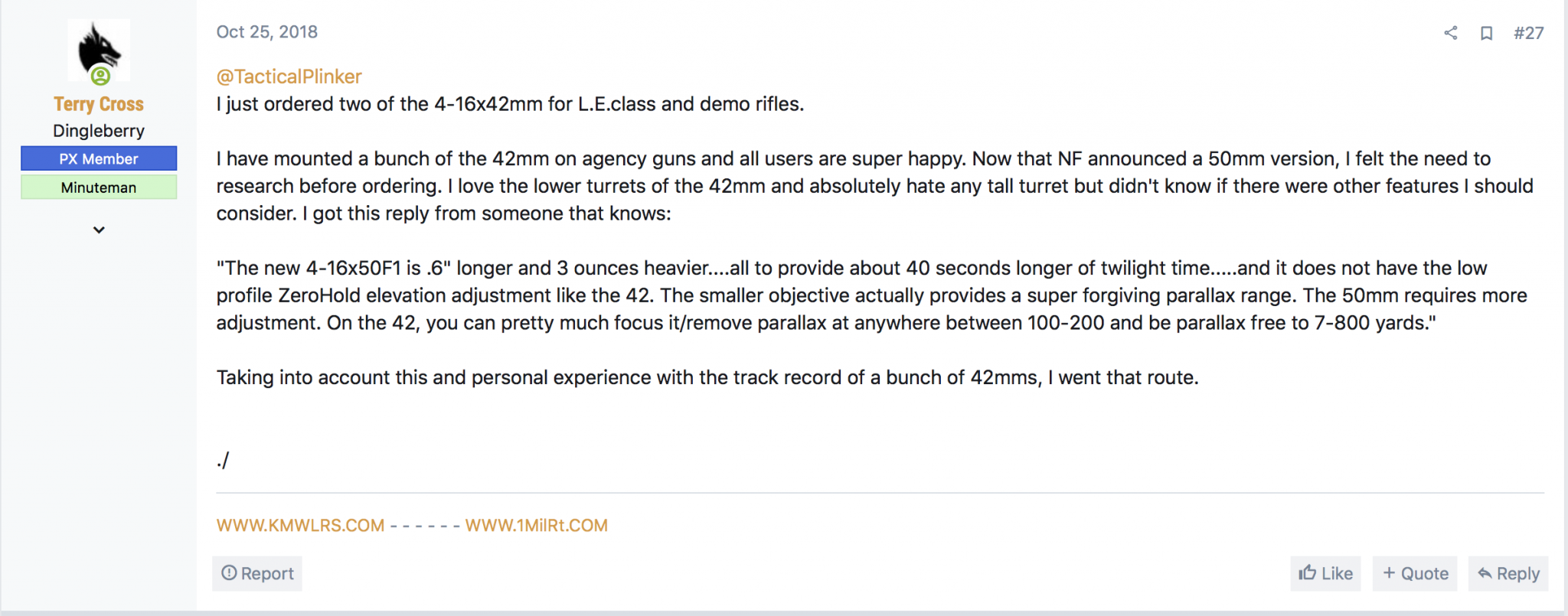

I understand what you saying so lets fast forward to today. If i ordered a brand new Nightforce ACTAR 4-16 by 42mm and a 4-16x50 mm ACTAR what is the extra 8mm objective lens on the 50mm giving me? I may not be using the terms "light gathering" or "twilight utilization" so I apologize but please explain to me what that extra 8mm objective is going to give me?
It appears that in 2018 someone "in the know" told Terry Cross all it gave was a 40 second difference in "twilight utilization".
