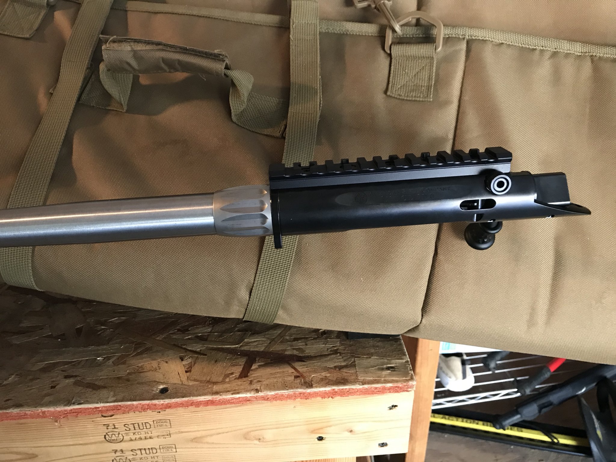

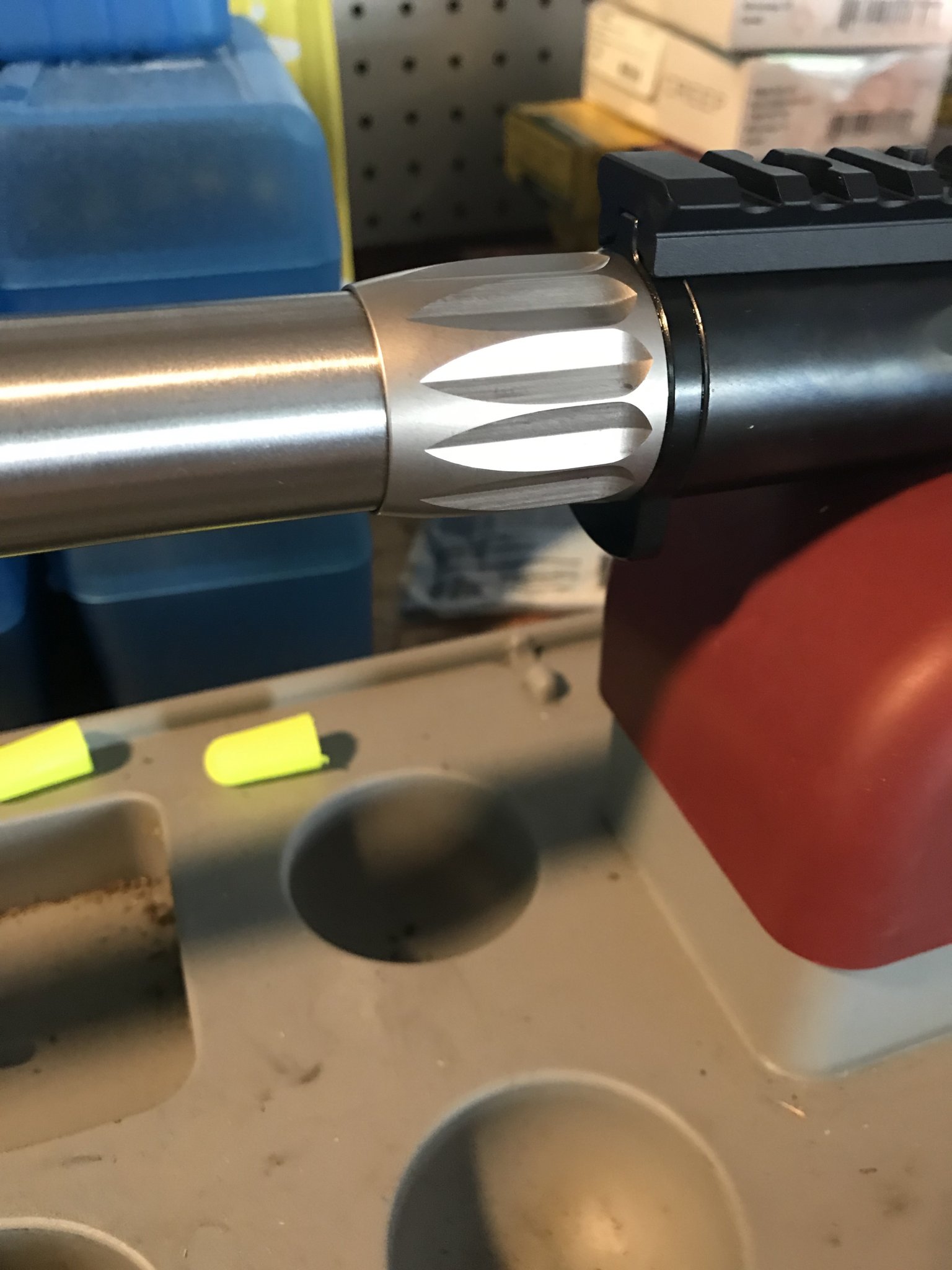

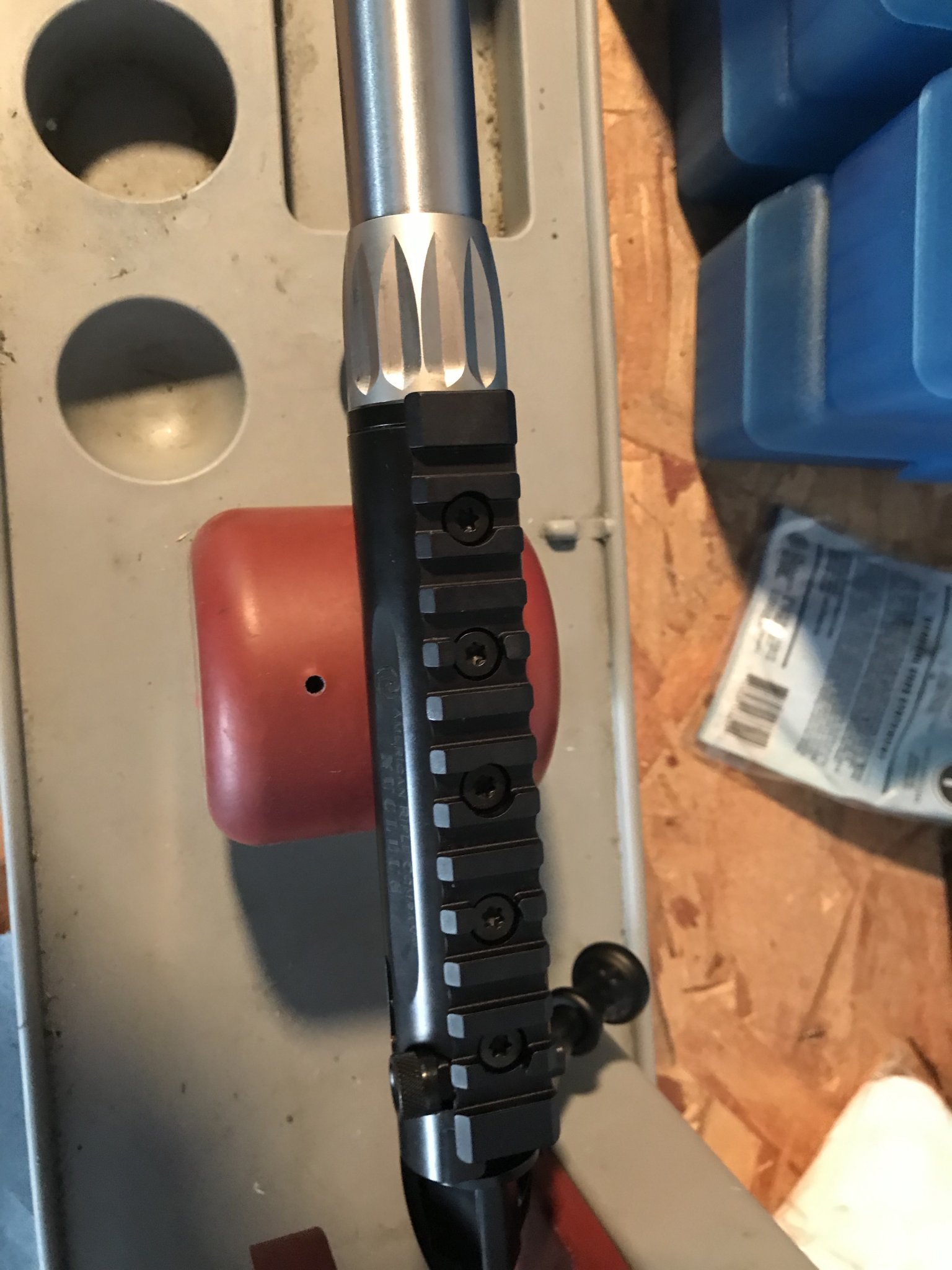

Sure, if you want to share pictures, I'll look. Also wouldn't mind seeing how the barrel nut looks installed. Not a lot of those pictures on line.

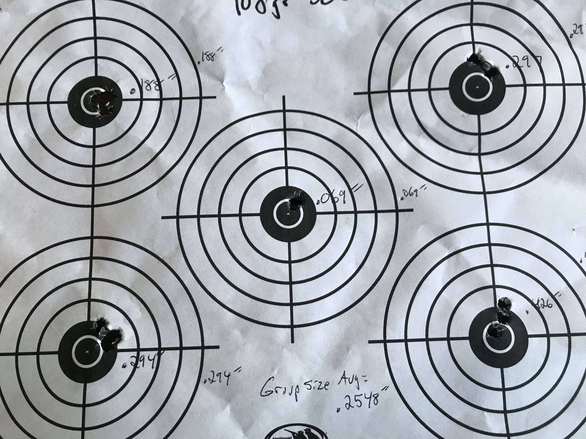

This is the McGowen Barrel with Bighorn Nut in my Nucleus Action. Groups are from this set-up.
I had it in an MPA Chassis and am getting ready to put it in a KRG just to see how I like it. Also changing the trigger from a Triggertech Special to a Diamond just for comparison.
Lastly, the smallest black dot in the targets (inner most of the concentric circles) is 0.408" in diameter.

Nice, thanks for sharing. Feel free to sell me your Triggertech Special at a good price :)

Those are 3 or 5 shot groups???
