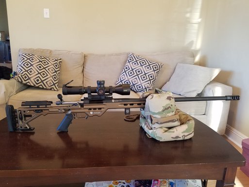

Just got my MPA built TL3 in on Friday, haven't gotten any rounds down range yet, but I will soon. Ordered mine back in November.
I got my TL3 6x47L a couple of weeks ago. I also put it in a MPA chassis.
I'm waiting on the 223 Wylde barrel that will share that TL3 action.
What are the specs on your build?
It's a 6.5CM, 26inch MPA barrel, TriggerTech Special Flat Shoe Trigger set at 1lb 3.9oz, MPA comp chassis, MPA brake, mounted my trusty Badger unimount with my HDMR in it (will upgrade to the XRSII when they are released though)
