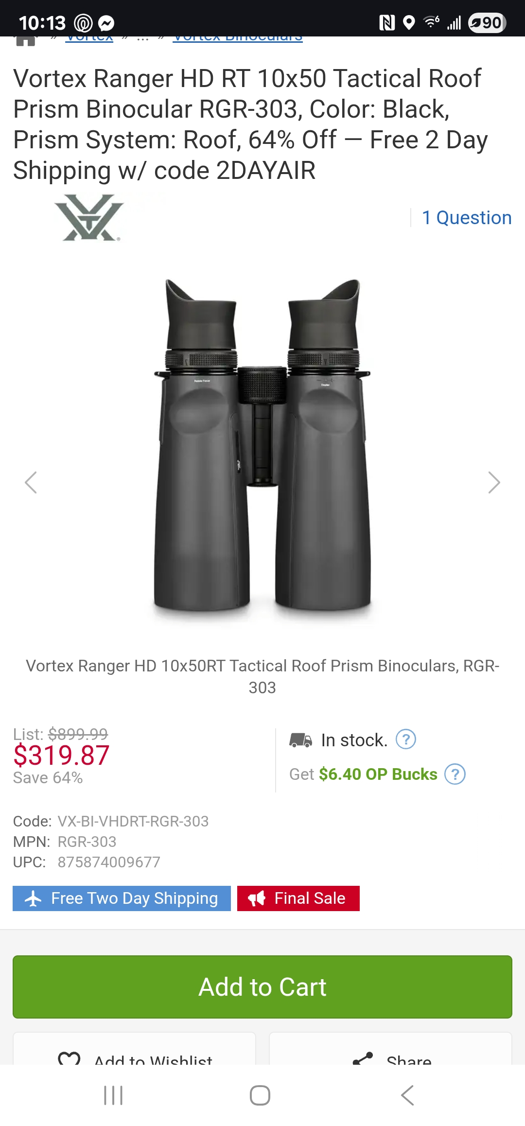

I never knew Vortex made these. Optics planet has them for 320. Also i use the Athlon binos with a retical, I got them off a prize table last year. They have done great for me this season. I like the size better then my Bushnell binos.
