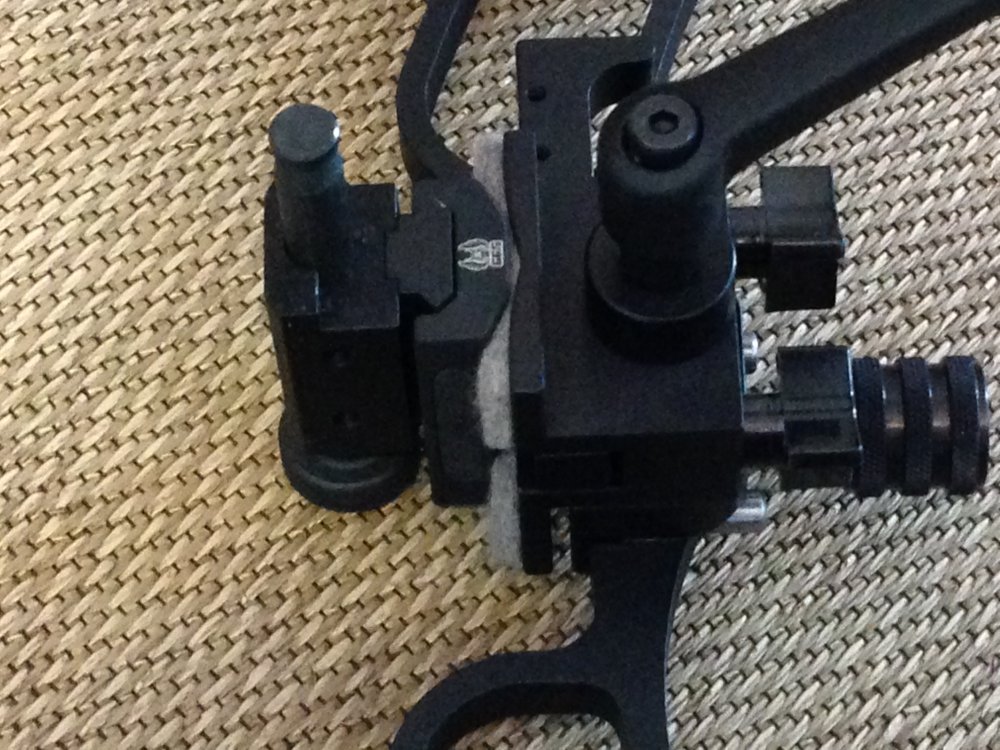

I use a Sinclair on my AIAE MK3 .308 24" plain bbl. Use the Atlas bipod spigot mount, Atlas bipod "AFAR" kit, and pic rail to sling lug adapter. It is kind of Rube Goldberg, but it works. I think that having a "longer wheelbase" is advantageous over a shorter one.
