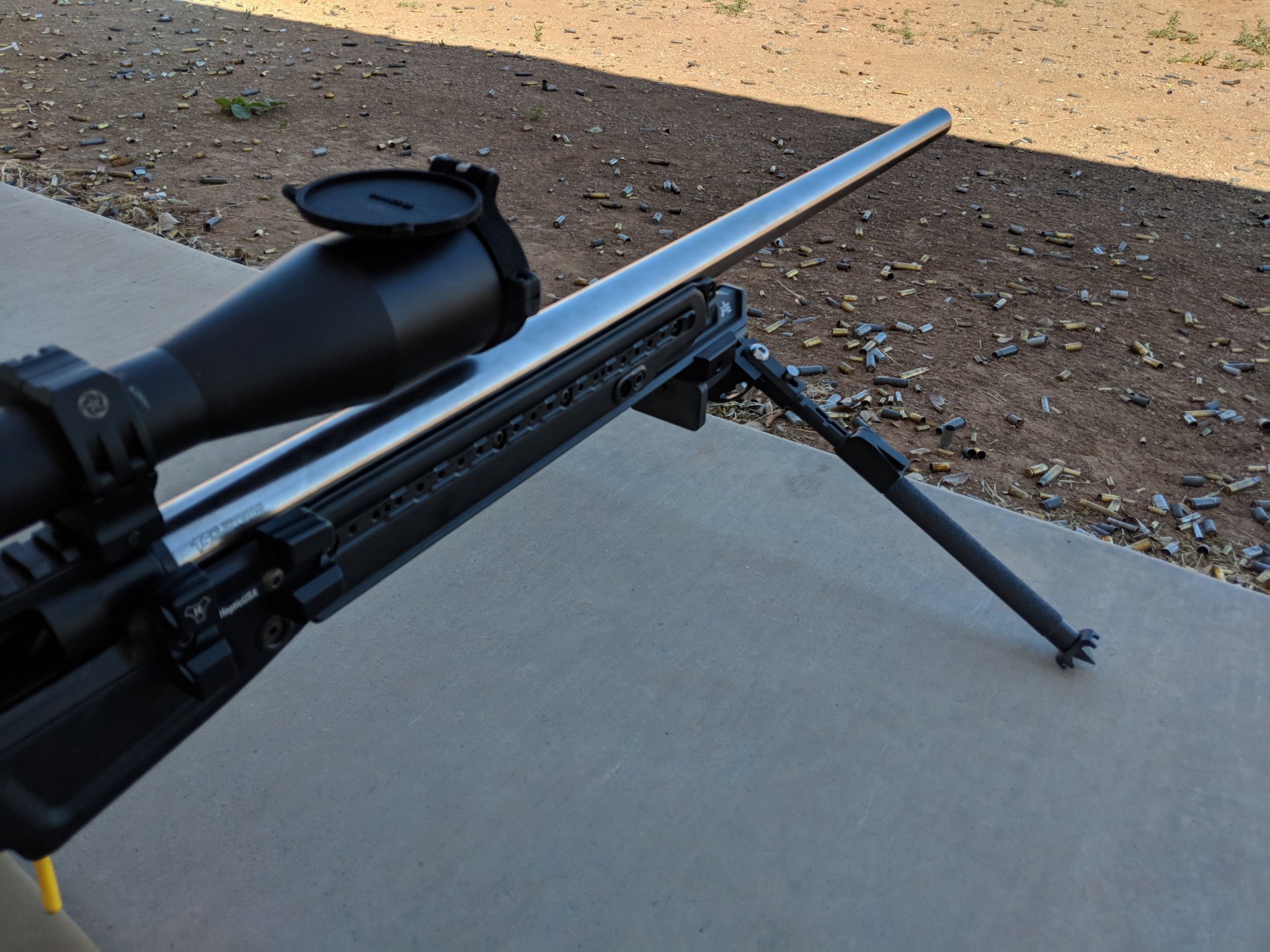

Just to prove that you can shoot good groups off of concrete with a bipod. This was shot today (5 shot group), off the concrete, using a Ckye-pod which has metal claws. It all comes down to employing the fundamentals properly. No needs for aids if the shooter does his part.
Dont like, we all know that's a 2 shot group. /s - but seriously, nice job. That makes me feel a little better, but obviously I am just trying to be as informed as possible. Thanks for the replies everyone.
