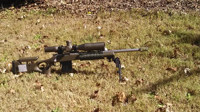

I have my GG&G pretty far foward and even when loading the bipod a good bit I still get a little hop. Im going to move it back towards the action some more and see if that helps. Here is a pic that shows how far forward towards the muzzle it is. It is rock solid steady though until I pull the trigger though but the hop is unacceptable, I have tried it with my atlas and an older harris and same problem but I have to modify the rail a little so it will slide back further. I think I will actually move it back today and see if that helps.
EDIT: just noticed this was in the F class sub forum. I am getting the hop while shooting off a mat in the prone position. Maybe those with more experience can lend a hand.

I also mount my bipod as far forward as possible; longer wheelbase (good term) and it reduces movement at firing and is much more stable.
Muscling the gun is never a good idea, that includes engaging moving targets.
The the bipod should be as far forward as possible, FClass or Tactical. If you move your hips you maintain your NPA, which is a good thing. Steering the rifle by muscling it goes against the fundamentals and will bite you.
Who ever said move it closer is wrong on so many levels, odds are someone got lucky once and decided it was the way to go and is now trying to sell their bad idea to the uninformed.

There is always something, reducing bipod hop has everything to body position and nothing to do with where the bipod is mounted.
Gotta agree here. Rifles want to hop because of recoil, not the location of the bipod. Moving the weight farther back is just going to make it worse. It's also going to make the rifle more twitchy, since there is no "wheelbase" (great term whoever said that) with which to hold the rifle steady. Maybe there's some weird situation in which you want that, but I don't know what that would be.
If nothing else, conceptually more weight up front the more it would want to keep the barrel down. Farther back goes contrary to what seems reasonable.
Anyhow I would love to figure out how shoot a 308 and a Harris bi-pod not hoping when on concrete like shooting ranges.
Not saying you cant make it not hop with body position, certainly I suck. People do it, I can't figure out how.
It's going to be very difficult to prevent a .308 on a Harris bipod from bouncing, especially on concrete. I'm not saying it's impossible but I am saying that I have other things to do. If the goal is to be competitive in F-class, you would be far better served with a different bipod. To be honest the Harris is about as low as you can go for a bipod in F-class. The accuracy requirements of the discipline are such that you are purposefully handicapping yourself by using a Harris bipod.
