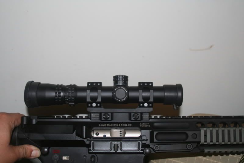

After doing some reading and the fact that I want a 1 piece QD mount I have decided on the bobro QD 30mm mount. Is this the best choice for a mount with the new SS scope and an MWS 308?

The LMT MWS is a .308 variant AR, so sure it would be a good choice.

<div class="ubbcode-block"><div class="ubbcode-header">Originally Posted By: OFIS</div><div class="ubbcode-body">The MWS has a monolithic rail, I would avoid cantilever too, its absolutely unnecessary. </div></div>
winner

By cantilever you mean the QD mount system? I want a QD if I need to transition to iron or my acog I do not want to have to hunt for a tool or wrench. Whats wrong with a QD mount so I understand.

No a cantilever offsets the rings forward of the mount.This is to allow proper eye relief on AR type platforms.If its a bolt gun or a monolithic rail it is not needed.A centered mount will be more rigid.
I can't comment on the Bobro but I'm using an American defense on my MWS with great success.I would prefer a two clamp moubnt for a bigger scope as well.

One last question. I always though cantilever held the weight towards the back of the rifle instead of more forward. The MWS is already front heavy. Seems like moving the attachment point of the scope more rearward would help balance the rifle? Also does anyone make a scope mount, besides sphur, that has 45' slant to the rings so they do not block either your windage or your elevation?

The ADM mounts use verticle rings they do not interfer with the turrets.
I dont think a couple of slots on the rail will make any percievable weight shift.Plus if you look at the mount you posted therear is in the same spot.The ADM just ads a second lever under the front ring.

If your rifle has a monolithic rail cantilever is not needed.If you don't it may be needed depending on the optic.

I have two of those Bobro Engineering mounts. One with 2.5-10x32 Nightforce in it and the other with an Accupoint mounted.
They are very well engineered and of high quality and do not scratch the rail in any way. Both of these mount are used on Larue OBR 556.
