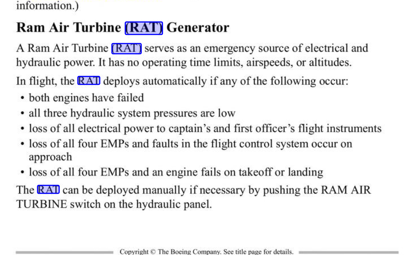

I will concede based on the video that nodopes posted it very well could have had a rat deployed. Still hard to see it but the audio does support it. Now let’s think about what the conditions are required to cause automatic deployment and engagement of the RAT.
Drawing a parallel from my armchair airplane, the technical answer is it deploys when power is lost to both AC buses and airspeed is above 100 knots. It then provides emergency electrical and hydraulic power sufficient to control the airplane and land safely. ChatGPT says they deploy when power from the engines is lost and that’s kind of true but not really. The engines can be producing 100% thrust and it could still deploy because the AC buses aren’t being powered.
It is an interesting theory if it did deploy and why. But I’m still firmly in the speculation camp right now of a flap issue whether mechanical or human. Dual engine failure is highly unlikely. My only other thought is the pitot static system got mucked up and the had bad airspeed indications.

Found this in the FCOM from Boeing on 787
A bit different than my plane. But the 787 is much newer tech so that checks.
The last condition is interesting.
The likelihood of all four EMPs (without full AC power loss) is damn near impossible.
The loss of all hydraulic systems in general is extremely unlikely.
If the RAT did auto dual engine failure is the most likely cause.
