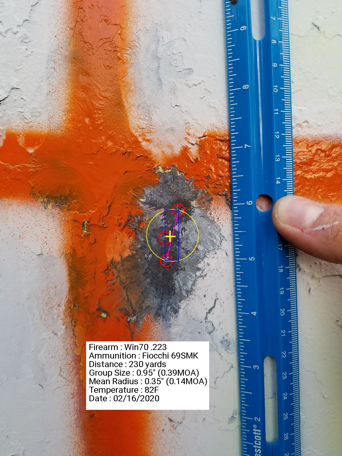

They group right around 3/8" to 3/4" - but, on a slow day - I checked the concentricity of every one of them, and tweeked them so they had no more than .002" TIR. They come in boxes of 50, and I believe I paid $26.95 per box. But, that was a while back. Hope this helps.

Hornady BLACK 75 BTHP

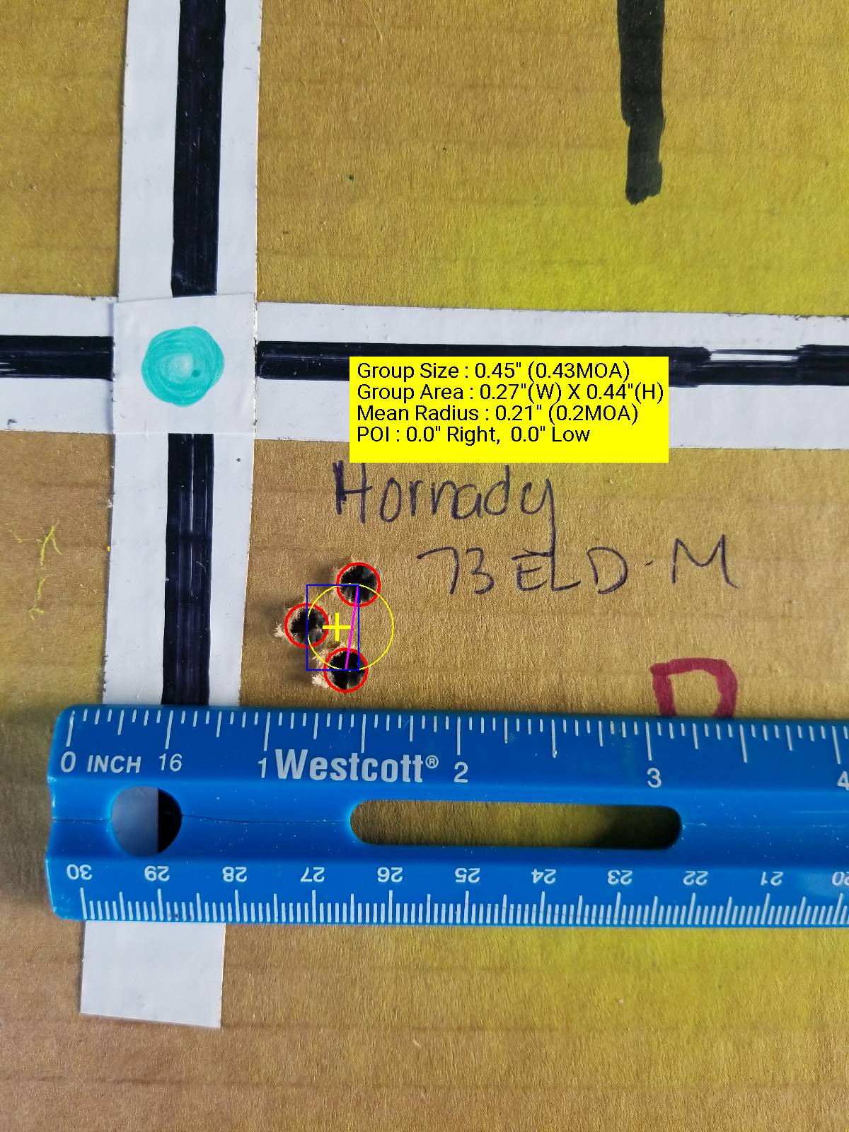

Hornady Match 73 ELDM

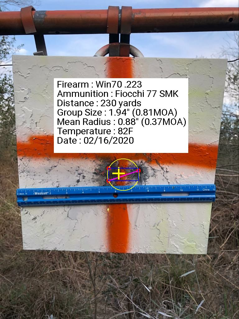

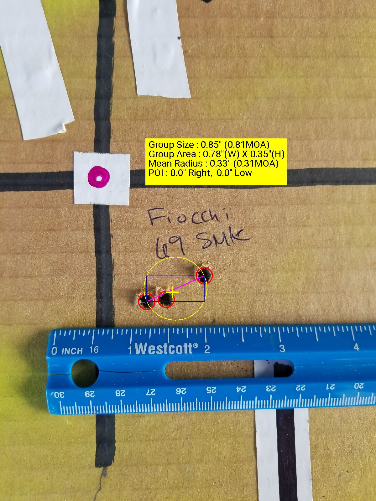

Fiocchi Match 77 SMK

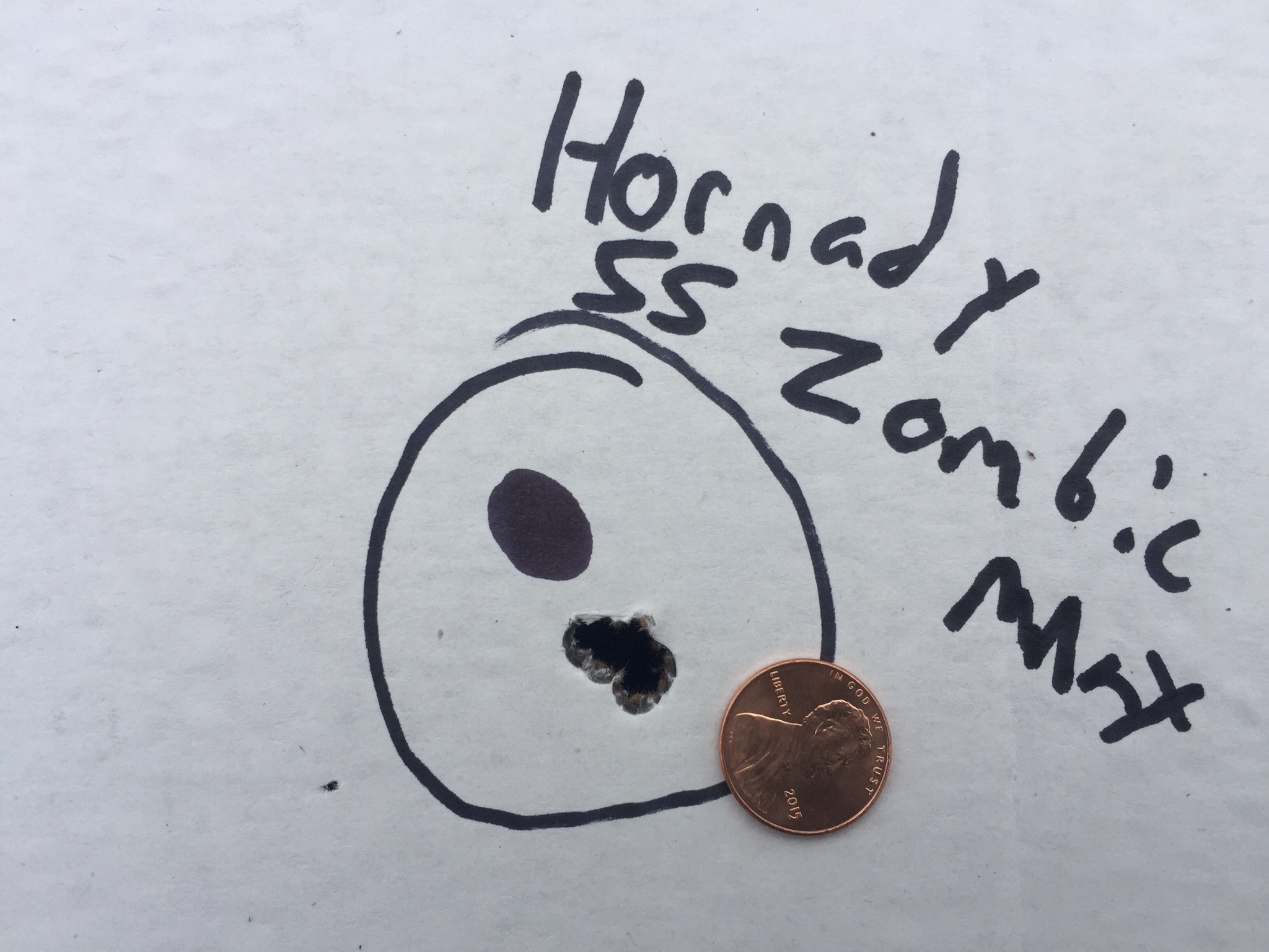

Hornady Superformance in any of their 70+ grain weight range.
I've also used Tulammo with a 77 grain bullet that shoots super accurate out of my gun.
80 SMKs. Finding them is the hard part.

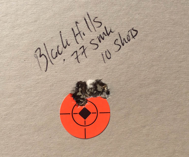

I guess factory ammo really doesn't shoot that well. You haters will love this part, it is a factory savage barrel that I put on after swapping it from a 6.5 CM to a .223. :ROFLMAO::ROFLMAO::ROFLMAO::ROFLMAO::ROFLMAO:
Savage has a good rep for making accurate barrels. My boy has a .308 Axis (in a Boyd's stock) that will shoot like that, (if he does his part) with FGMM and it's not even the heavy barrel version. Of course you have to take your time not to heat it up...
