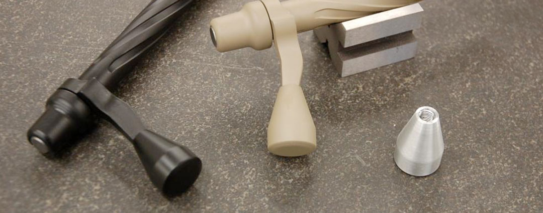

I would have someone TIG weld a threaded stud on the bolt handle.
Remington is noted for its porosity in the handle so threading it is sometimes hit & miss.
Our bolt knob installation process involves the use of an in house machined 52 Rockwell C insert that bridges between the factory handle and the knob.
Over 1000 have been done this way with not a single reported failure.
Turnaround is typically 48 hours.
LongRifles, Inc. - Remember, Men will bet their lives on the work you do.

LRI did my bolt and bolt handle . Unbelievably great customer service, tracking of progress of job and shipped back. It literally only took them 48 hours and it was on its way back to me.
