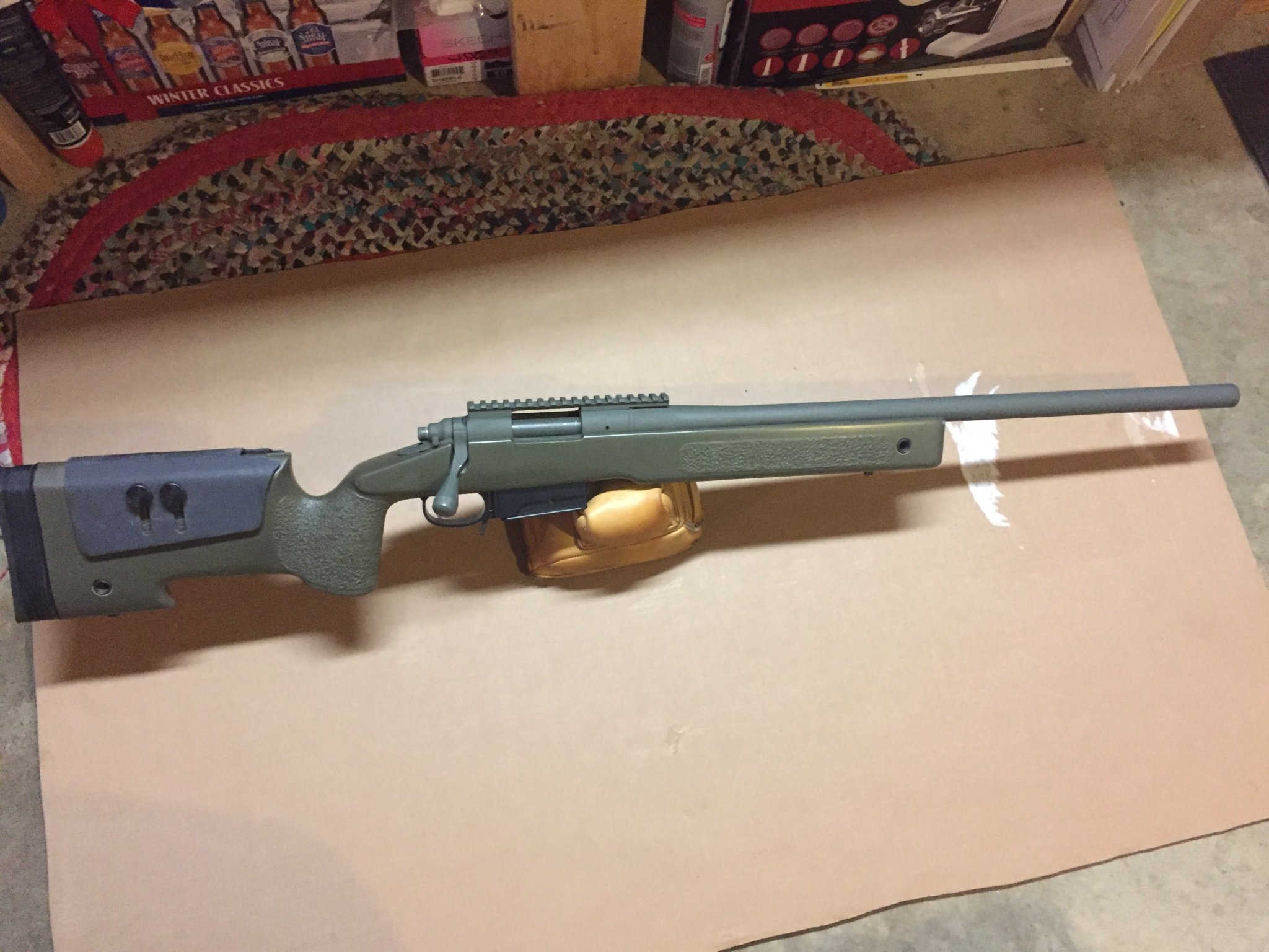

I just picked this Mcmillan up from here. It’s a “no prefix” Action with a Benchmark 24” light Palma Barrel that came off a Police Sniper Rifle in NC. It shot the group in my avatar but it was in a HS PSS stock.

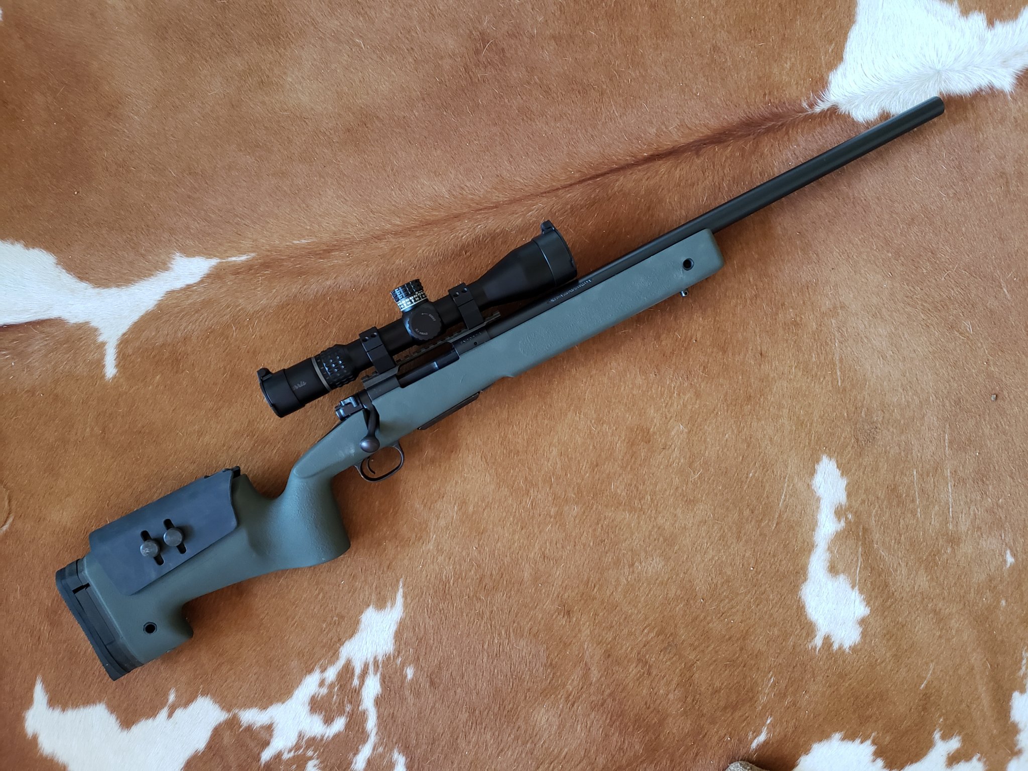

I settled on a new old stock FN SPR A2, which I got for a killer deal in 2017. I put a Burris XTR II 3-15x on it, bedded it, and kryloned the stock green. I shopped sales, and when it was all said and done I had right at $2,500 invested.
Dare I claim that the FN is probably as robust as the M40A3, but it is certainly built tough and aside from the factory magazines I'd say that it is. The Burris is obviously nowhere near the optic that a S&B is, but is pretty stinking durable/repeatable for the price. I've not experienced any problems with it, and it's made several trips across the ranch in the Ranger.

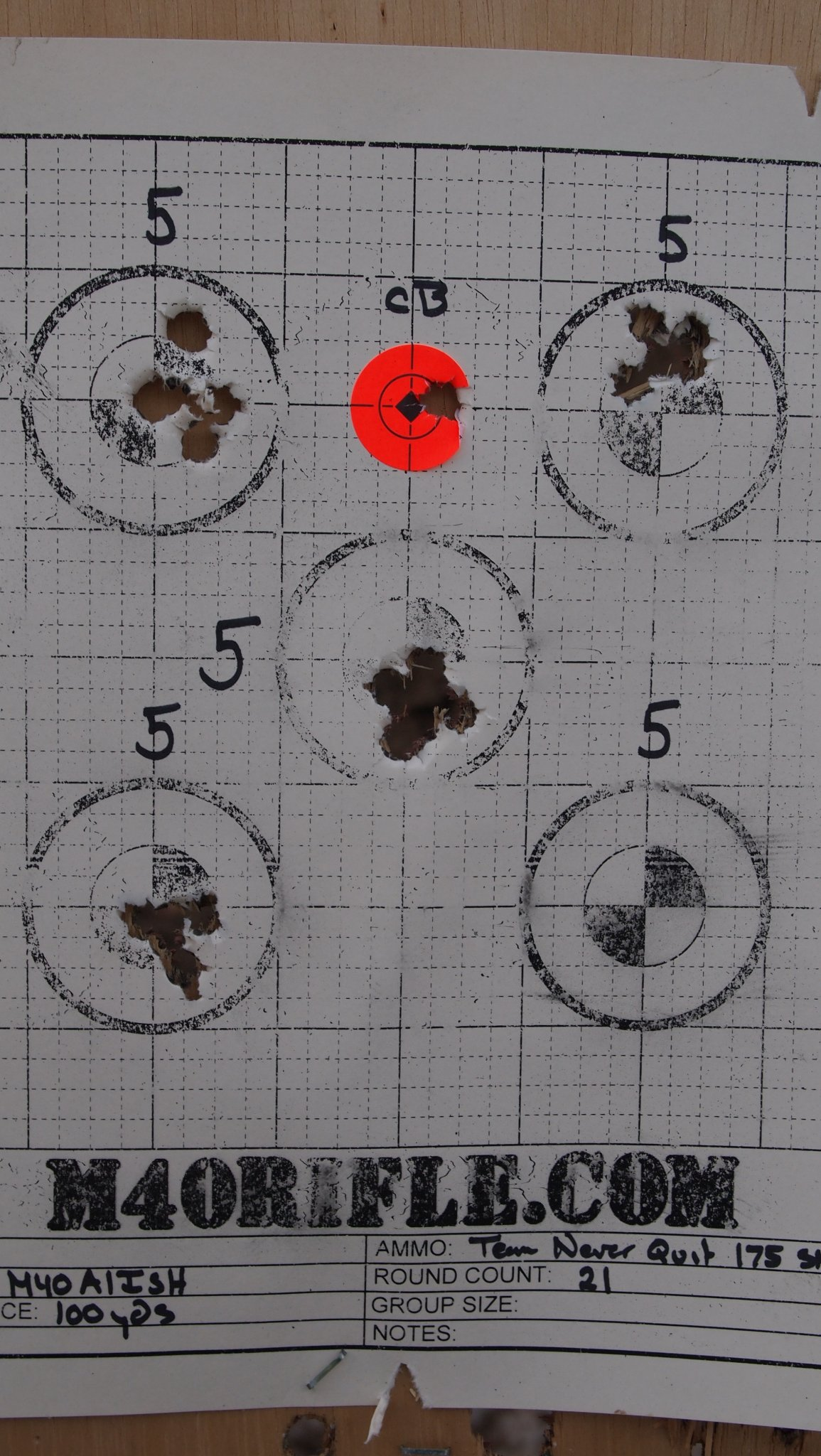

Accuracy is not on par with a full-on custom build. I'm getting 3/4 MOA with mine with handloads, and just under the MOA guarantee with factory FGMM. That is on average, not a cherry picked group. I know that a custom would cut those groups in half, but it's not worth the extra thousands of dollars to *me.

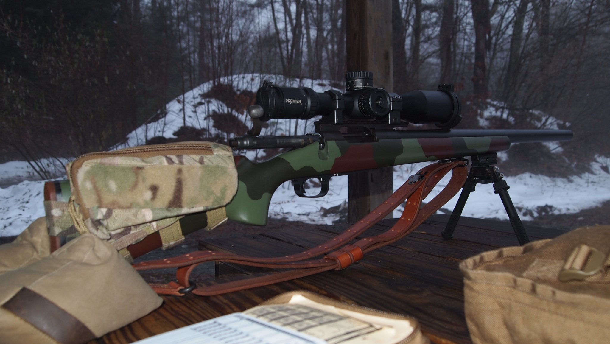

My favorite M40 "like" rifle.....
and its shoots okay despite not following any recipe....

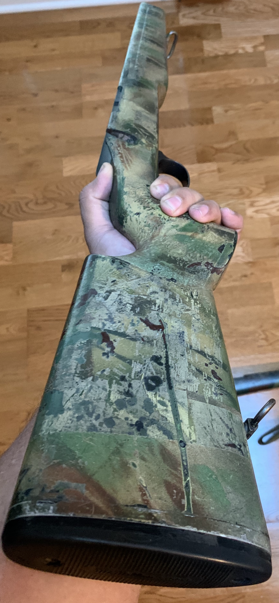

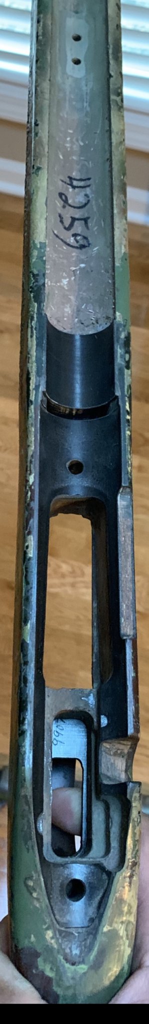

Yup the dumpster, another mans garbage is another mans treasure. I got the same story about this stock. The a1 came from the school house and the barreled action was bedded into this stock. Everything is identical to a a1 minus the stock. I was told only 2 rifles were built with this particular stock.
