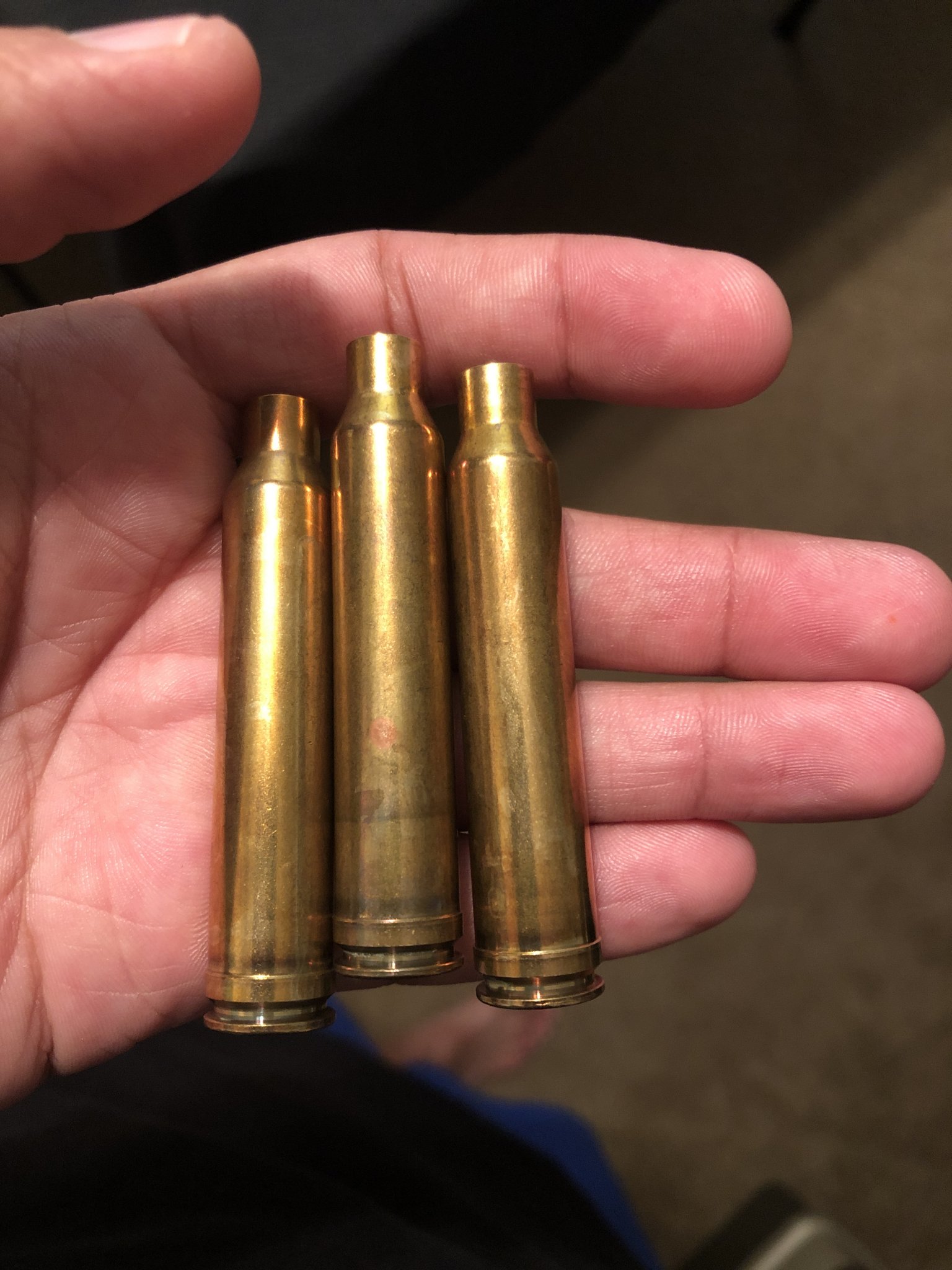

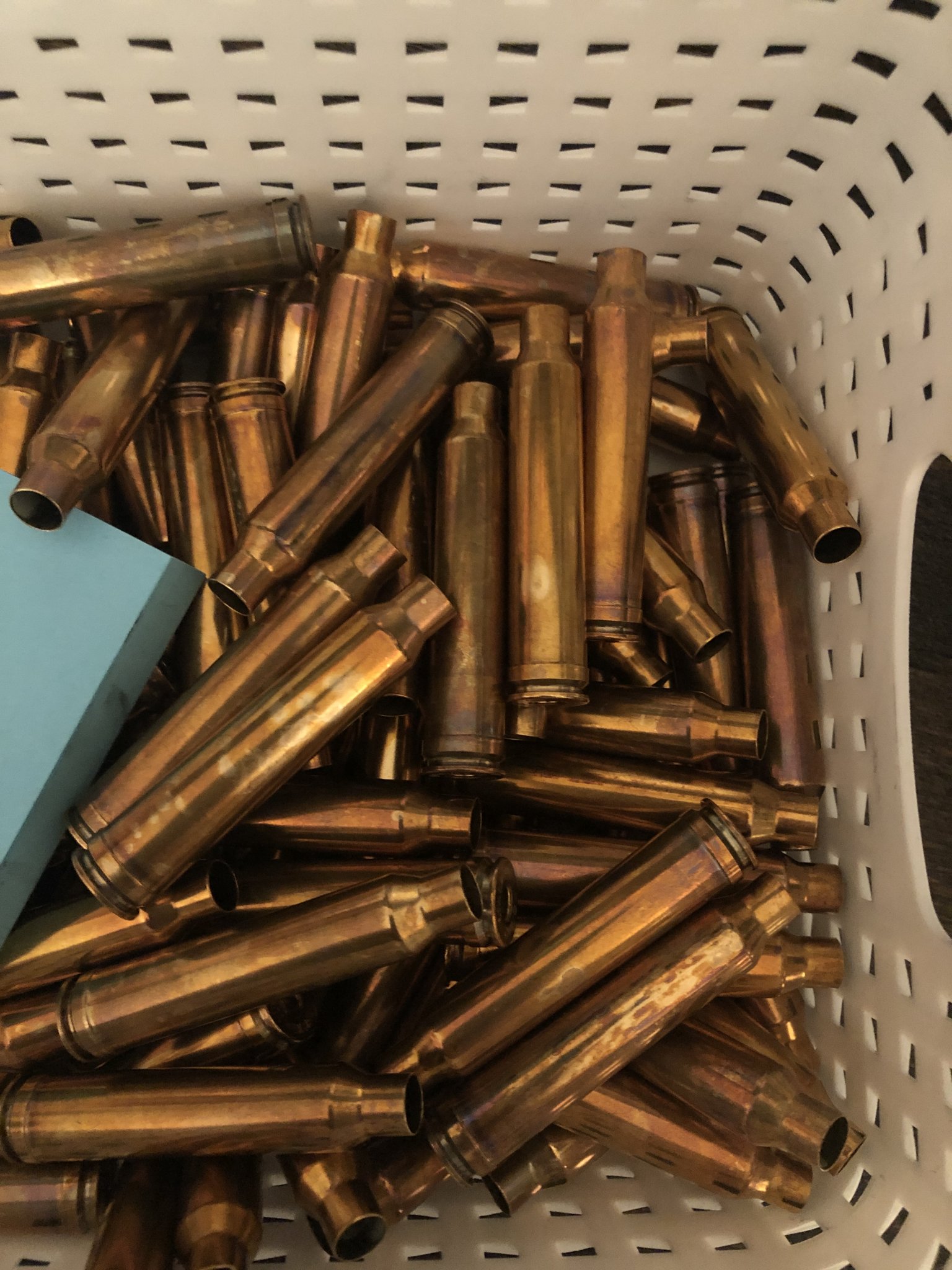

Jacoby4465 Private Full Member Minuteman Supporter Apr 6, 2013 40 1 Florida Feb 2, 2021 #1 Feb 2, 2021 #1 I set temp at 280 in oven let the brass dry in there for 30 mins i did stick the brass in as it was preheating. I feel like I messed the brass up cause of how it turned out and cause of the element heating up!?!? Any advice?

TheOfficeT-Rex Small N, small x̄ Full Member Minuteman May 19, 2019 1,526 1,516 Feb 2, 2021 #2 Feb 2, 2021 #2 What makes you think you messed up the brass?
Tokay444 Black Rifles Matter. Full Member Minuteman Jun 24, 2019 5,205 7,145 Feb 2, 2021 #3 Feb 2, 2021 #3 Your oven can’t get hot enough to do any actual change to the crystalline structure.
Jacoby4465 Private Full Member Minuteman Supporter Apr 6, 2013 40 1 Florida Feb 2, 2021 #4 Feb 2, 2021 #4 They came out all off colored and down by the head some have developed a line Attachments image.jpg 447.1 KB · Views: 35 image.jpg 364.7 KB · Views: 34
TheOfficeT-Rex Small N, small x̄ Full Member Minuteman May 19, 2019 1,526 1,516 Feb 2, 2021 #5 Feb 2, 2021 #5 The discolouration is from shit in your water, or a lack of good rinse. That line looks like the end of the scuff from the sizing die. You can check the inside for a ring with an unwound paper clip. I highly doubt that you ruined it. Reactions: camocorvette
Jacoby4465 Private Full Member Minuteman Supporter Apr 6, 2013 40 1 Florida Feb 2, 2021 #6 Feb 2, 2021 #6 Thanks everyone
L lightman Sergeant Full Member Minuteman May 18, 2009 1,460 746 67 England, ar Feb 2, 2021 #7 Feb 2, 2021 #7 I use the oven in the Winter time but I set it under 200º. That temp will discolor brass that was tumbled with wash-n-wax. They come out looking dull.
