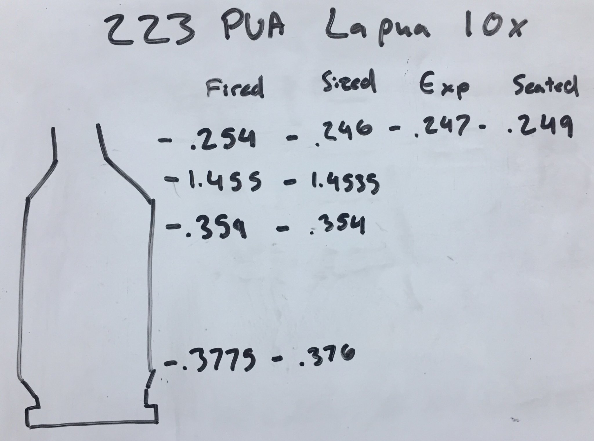

The comparator is just a datum, aka a hole that when the brass cases angled shoulder is inserted will always settle into the same location on the shoulder each time, which enables you to measure the exact same plane and its difference from the base of the case exactly. This lets you know how much you are shortening the case exactly.
That’s one measurement, probably the most important, but I also get the neck, shoulder and base diameters. For each step of my processing. It lets you see what’s actually happening and where.
So I’m sizing my brass from 1.455 on the shoulder to 1.4535 so I’m going .0015” of an inch. Between .001-.002 is generally good enough but the vid above goes into how an extra thou could be your preference.
The main thing is that you are sizing it down minimally to create just enough clearance for smooth consistent operation. It’s not screwing the die all the way down to size it as much as possible for .010 of brass movement, that’s over working it and will inevitably lead to premature failure.

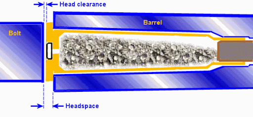

This is for a rimmed cartridge instead of a belted but it illustrates the point, the gap cause because the case has extra space around it. When it fills that gap it stretches.
