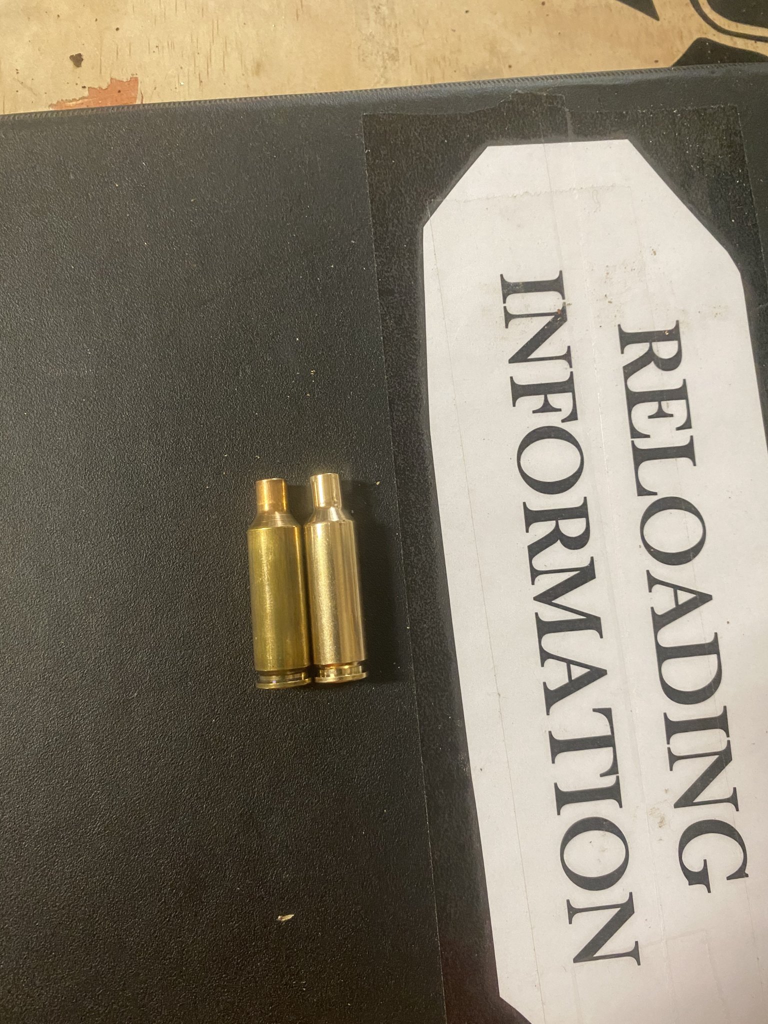

So I use Brass Juice to clean my brass and it looks brand new but after about a month sitting in the case it starts turning greenish. Anybody have any suggestions? I read somebody a couple years ago said they put some type of wax wash and there to help clean it and it helps the tarnishing , my other buddy said just clean it before you need it. any suggestions would be greatly appreciated, Thanks Jimmy

It’s hard to see the green on the one on the left through the picture but the one on the right I just cleaned and it looks great the one on the left has a greenish tint to it
