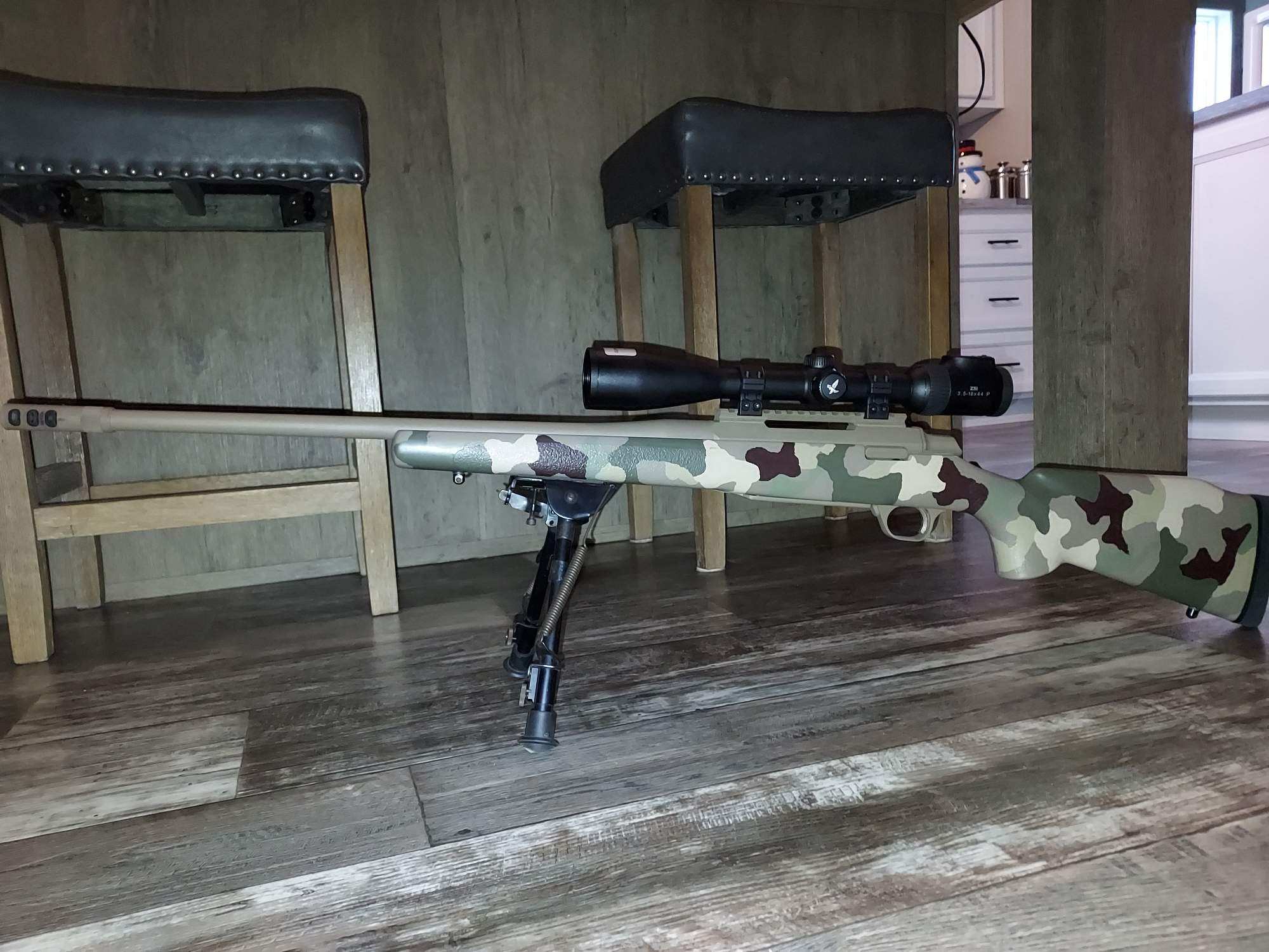

A friend of mine re-worked his A-Bolt not too long ago. He found a brake that works with the Browning BOSS threads and put it in a McMillan stock.

Your friend's A-Bolt is pretty close to what I had in mind. Do you know what brake he used? This one has the BOSS-CR on it.
He said it's a Hawkins Precision. Their website doesn't advertise one to fit, so I don't know if they threaded it for him, or if the gunsmith did.
