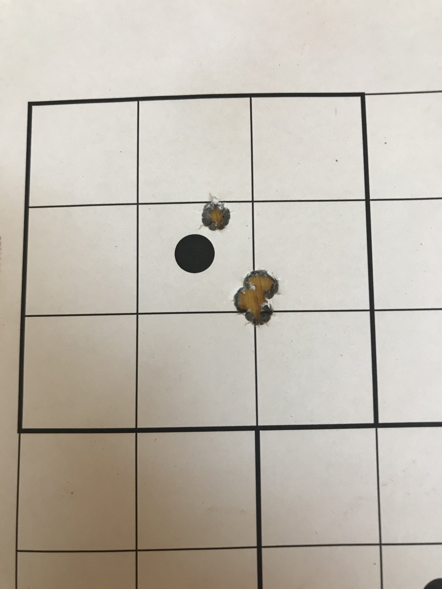

So this spring I bought a browning X-bolt pro long range in 6mm creedmoor. Put a leupold LRP scope on it. I was excited for this purchase.
I bought a few boxes of ammo, federal gold and hornady match. Didnt get great result. Started reloading it, and also not great results. I found 1 reload that would shoot sub moa. Everything else was 1.5-2 inches. So I run 400-500 rounds through it trying to find something decent other than the 1 reload with is only a target bullet (Sierra matchkings).
I finally get fed up, and talk to my local custom rifle builder/gunsmith. He says to call browning. So I call the saskatchewan warranty rep for browning. He agrees that this is not performance outbof a $2500 gun. He emails browning in Missouri (I think). The reply: these groups are within spec, and unfortunately they can't do anything about it. Needless to say, Browning is now on my blacklist.
Anyone else having issues like this?

The one reload is 110gr matchkings, with rl16. It shoots about .75". Ive tried nosler rdf & accubond, Berger hybrid & elite hunter, hornady eldx and eldm, sierra matchking. A few others too
Have you checked your stock over? Is there contact at all with the barrel? Maybe the recoil lug isn't in contact with the stock or the torque settings on the action screws are off.

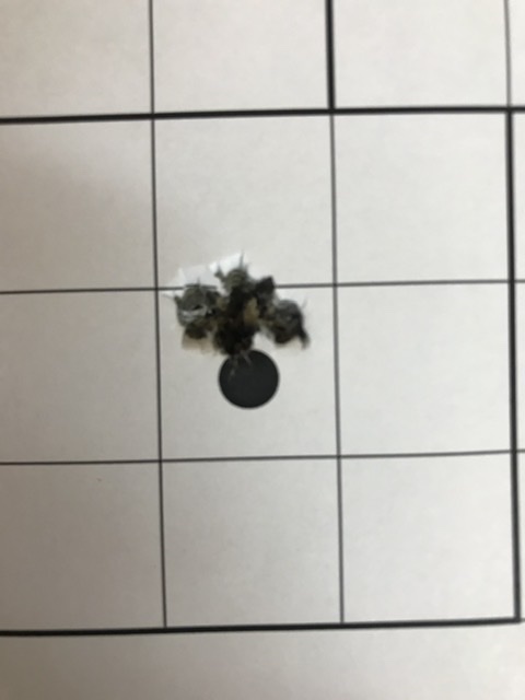

They are a hunting rifle typically these aren’t made for .25 groups but I am a little surprised you couldn’t get it down to .75 at least. Just worked up a load for my 6.5 the other day pretty happy with it 5 shots 100y. *Inconsistent neck tension, jerked the trigger, cat jumped on my head or whatever everyone is explaining fliers with these days*
I recently bouht a 6.5 PRC Browning X-Bolt Pro and sold my .300 Win mag Browning A-Bolt Stainless Stalker.
My 6.5 PRC X-Bolt Pro soots 1.2 MOA with 140 r. Hornady ELDM (match) ammo, (FACTORY ammo!)
Those were 3 shot groups B/C the thin, fluted barrel gets hot too fast.

Yes, I've checked my stock. Everything fits nice. The stock and action are all well fit and smooth. Everything about the gun is good except for how it shoots, which is ultimately the only the thing that matters. My Tikka t1x 22lr shoots as good of groups at 100 yards. I would expect this out of a $500 savage axis, or similar gun, but not a gun that is marketed as "pro long range"
