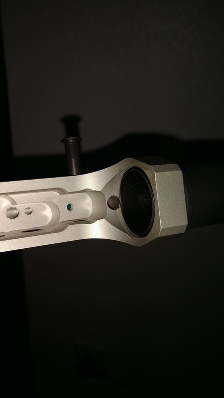

I've recently put a rifle length buffer tube on an AR i'm building out. It's the first time I'm using a rifle-length buffer tube on an AR, and what the heck? The threads BARELY allow me to screw it on far enough to keep the buffer detent in place, I swear if I wiggle the detent hard enough it may pop out. Any one you guys know of a rifle style buffer tube that will hold it a bit more...... positively? Y'know, with threads that will go on and hold down the detent a little better?

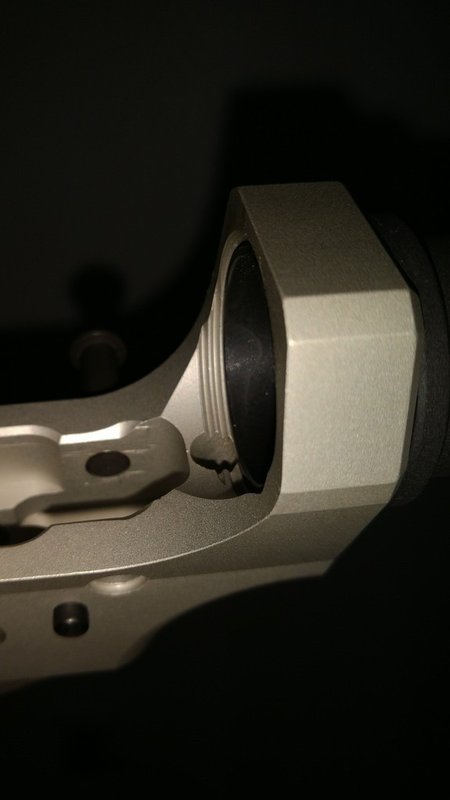

Okay here are some pics, unfortunately my friend is also building an AR so I gave him my detent and spring so that's no longer in the receiver for these pics, but you can see the relationship between the tube and receiver here:
Let me ask a dumb question... You do have the tube screwed directly into the receiver? You aren't using an end plate like you would on a carbine RE?? If the answers are yes/no you have a problem. It would be easy enough to try another tube or measure yours and reach out to someone here for comparison. I am almost willing to bet the receiver spec is the problem. The tube would have to turn another full rotation to be where it needs to stop.

Do you have another AR handy to compare with? Swap tube to another retriever? By the looks of the pictures the whole is to far forward. I agree with above, I think your receiver is the issue.

After looking at a couple of mine i think your reciever is probably okay. At least by the location of the hole. What if the reciever is to thick/deep/long in the extension.
