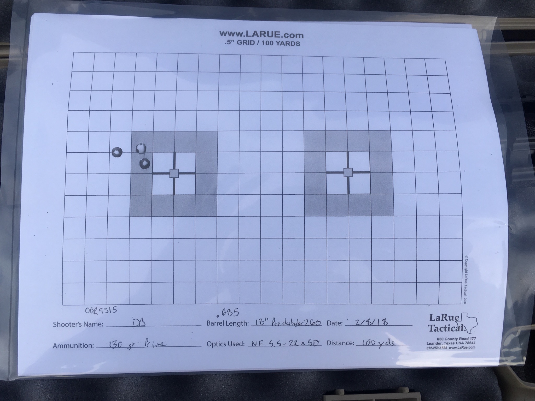

I just ordered a Larue PredatOBR in 260. I was wondering what grain “store bought” ammo someone could recommend as a good starting point. I’m extremely new to this game, but was thinking to try 130-143 grain ammo from Hornady, Prime and Gorilla and see what it likes. Once I receive the rifle that is....
I’m not claiming to be an expert, but ordering a 260 reamer with freebore specified that allows you to touch the lands inside a magazine isn’t all that hard... I did it, and it’s been working great for several years. I shoot 140 RDF’s, but I set it up for Bergers and added just a touch of extra room in the mag to make sure they would always feed well, or Incase anything pointier came out later I wanted to try.
Is your twist an 8, 8.5 or 9"?? Mine is an 8.5" and I use 140's. An 8" will work with anything, but it prefers the heavies. a 9" will work with 130 and lighter. CAn't help with the factory ammo recommendation as it has been almost 30 yrs since I bought any.
