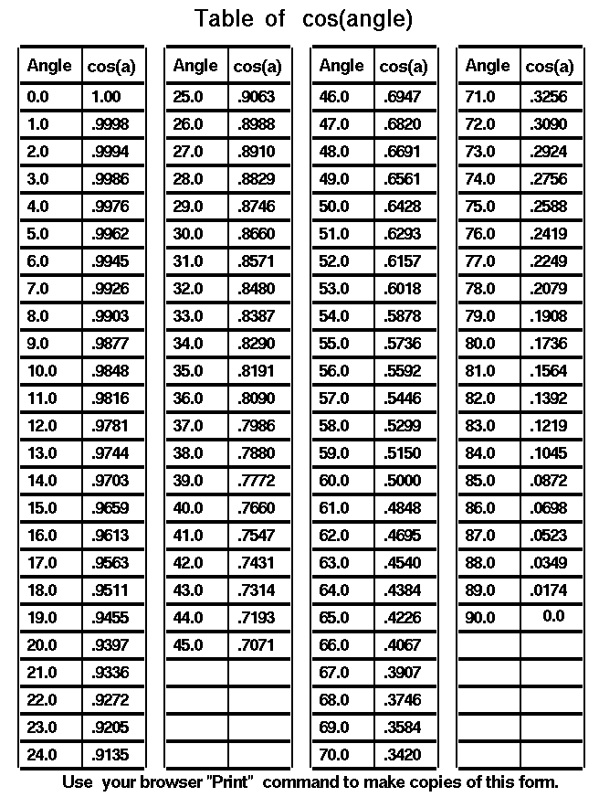

Use the cosign -- it is ultra simple..
for a rifle do not get to wrapped up in the axel. all you need are a few numbers.. hell you can even round them.. like 10°,15°, 20°, 25° and 40° is like hanging out a window. Sure you can add more but remember all yo are doing is calculating gravity distance (GD) vrs Line of Sight (LOS). So if the range is really short the difference between GD and LOS is often so small even extreme angles have little effect. For longer distance you be really surprised how far up a hill or down a cannon you need to be to make up 20°+.. If thats the case don't forget wind is still LOS.
edited to add: My bow at only 300FPS does indeed need to account for cosign values even at very short ranges.. Think of it is a time to gravity exposure issue more than distance.
I remember that 10° is about 2% less GD, 15° -4% 20° -6%, then 25° -10% of the LOS.. that way I do not have to even remember the cosign, set my PLRF to report GD or use a calculator..
GD= LOS distance x cos(a)

Diver160651, I am familiar with the cosine method, but at steep angles and greater distance it can be off, but lets face it, this problem is really nothing more than academic. An 800 yard shoot at a 60 degree angle in the wild is as rare as hens teeth, but it's fun to problem solve this stuff. I still don't know if I'm doing the problem correctly because my answers are not as accurate as the ones in the article.
In reality, very a long range ultra high angle shot like you said is mostly academic. To shoot 60* at 800 GD, you’ll need 4,155’ of vertical, lol, you’d have to strap yourself to El Cap! Remember the the angle of repose, the steepest angle before soil and rock falls for most hills is on average about 30-35*. Sure with some cliffs 45.. over the longer average slope. Sure, if your talking 800 LoS at 60* the numbers are halved. Either way it’s hard as hell to physically shoot a gun much past 30 accurately without some weird shooter offset.
