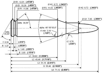

I don't know when we started talking about headspace, but your length of loads has nothing to do with it.
Headspace is all about how the brass fits the chamber. To little, the bolt won't close. Too much....KABOOM! It's a factory/SAAMMI spec. Unless you change barrels or bolts, don't worry about it.
.308 data specs attached.
