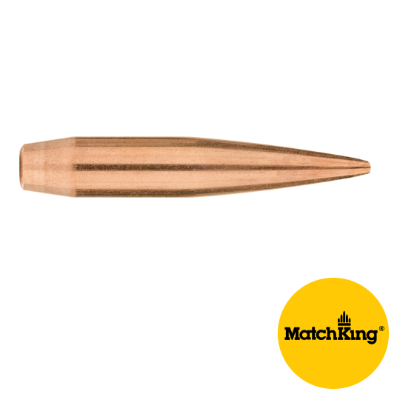

Thank you everyone for your inputs! I tried hard to find a bullet which:
  • Gives a stability factor of > 1.5 in my configuration
  • Is >= 230 grains to keep the advantages of these heavy bullets with high BC
  • Is available in France (hardest part)
These criteria narrow it down to a single bullet: the Sierra MatchKing #2251.
I ordered some, I'll post an update next week when I try it. If it doesn't work, I'll have to go to 220 grains bullets but the choice is extremely limited (almost non-existent actually) where I live, so... not ideal. Then that would be 185 grains next... but that's not at all what I originally wanted for this rifle.
Hopefully Sierra #2251s will work!

But that bullet needs a 1-8” barrel
Yes, but all the stability calculators I tried give a result saying it should be fine (stable) given the muzzle velocity I'll have. Maybe Sierra mentions the 1:8 twist rate for other calibers with lower muzzle velocities which would not be enough to stabilize the bullet.
I just hope it will work, if not, I'll go for 220s if I can find some.

According to this it’s 1.775” long
Indeed, I found this page a few minutes ago... then I found a french gunshop website stating it was 1.620in (specifically the 2251s) like QuickLOAD. This is very confusing, I can't understand how different sources can have different lengths for the exact same bullet reference (#2251). I guess I'll have to wait 2 more days to find out the truth when I receive the box... but yeah, this smells a bit bad for me...

NO it won't be fine !. Minimum recommended twist rate 1:8.75 ,You're on the low end of marginal at best . :(
Well... anyway, I received the box by mail just now and QuickLOAD and all the french websites screwed me: the bullet is 1.735in on average (not 1.620in), so all hope is lost on this bullet.
