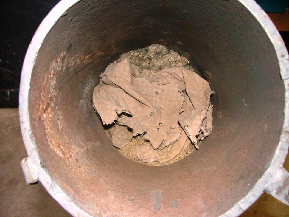

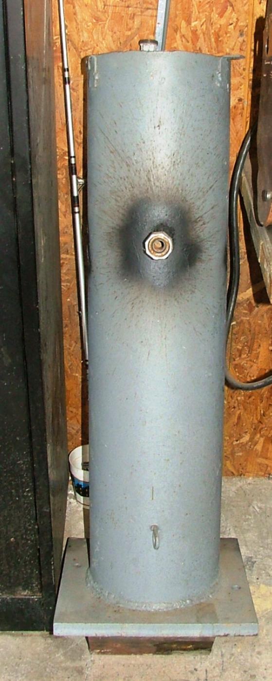

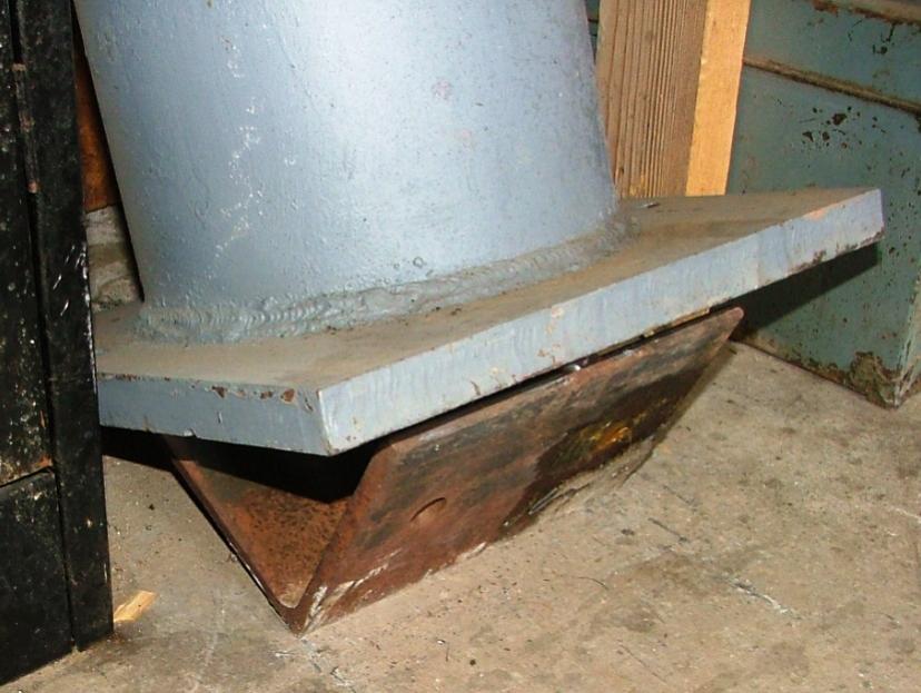

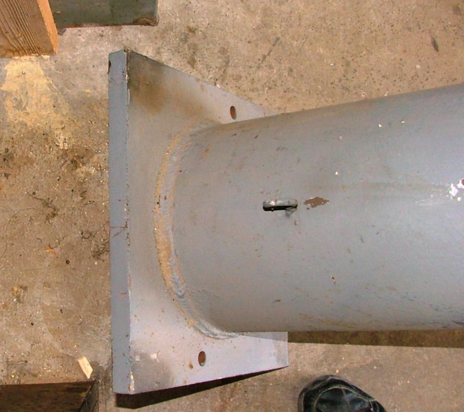

I built my trap out of high pressure oil field pipe with a 7/16" thick wall. The base is one inch thick AR-500 plate. The pipe is 48" long. The two are welded together with two layers of weld. The bottom of the steel plate has a pyramid shaped wedge welded to it to provide a 45 degree angle to the pipe. This allows a straight shot into the trap.v It also allows easy storage of the trap as a fulcrum point.

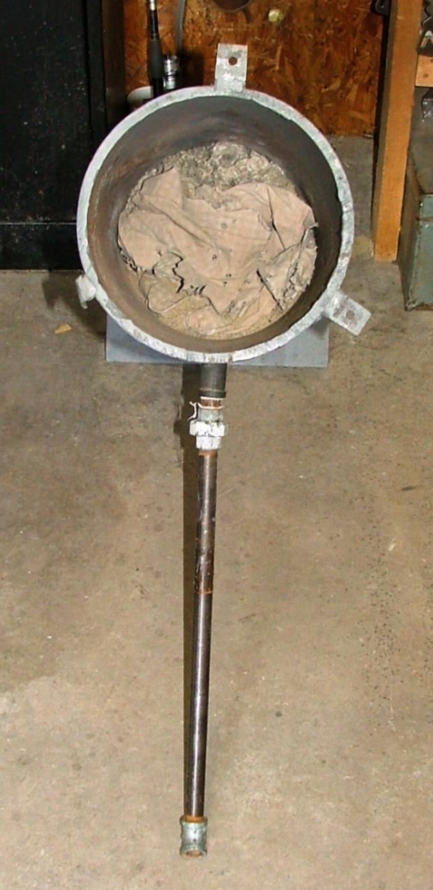

The "tube" is filled with 200 pounds of wet sand. Wet rags are on top of the sand.
This trap has stopped every caliber I have fired into it.
When done the mono-pod unscrews and the whole thing folds back onto the wall.
