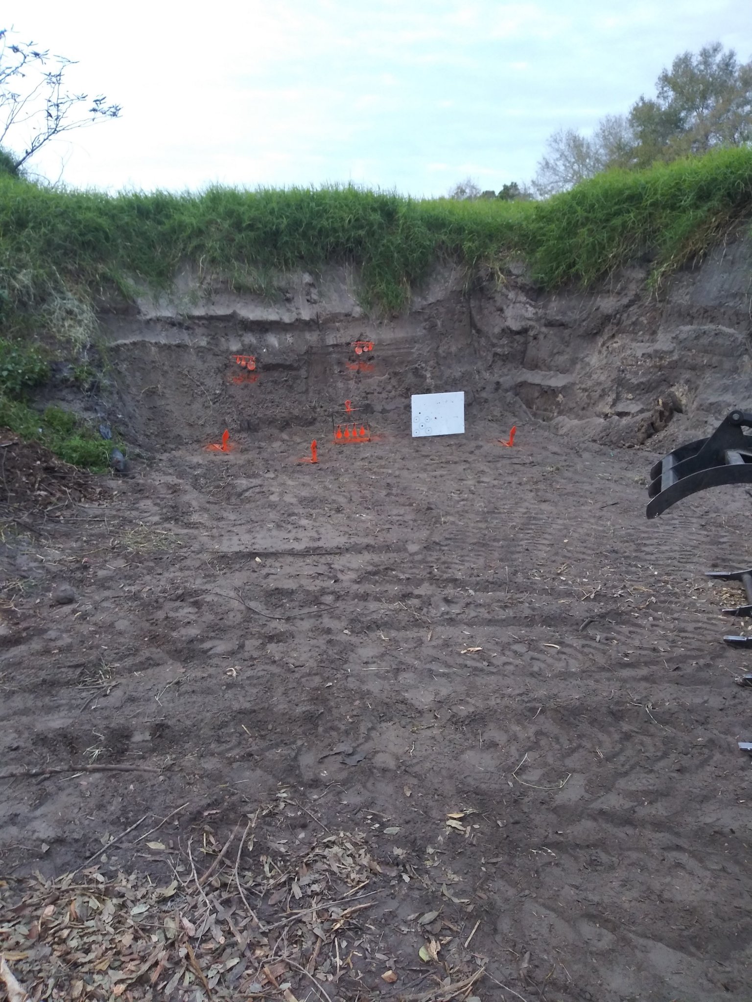

This is piled up pool dirt.
Pool companies need a free place to dump

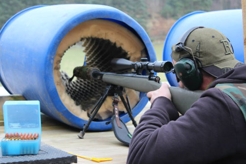

As far as keeping muzzle blast noise to a minimum without a suppressor, I have seen a home range where the owner set up a short tunnel of old tires in front of his shooting bench. Just make sure to have the tire tunnel close enough to the bench so that the muzzle sticks inside.
Seen people use corrugated drain tube for same thing.

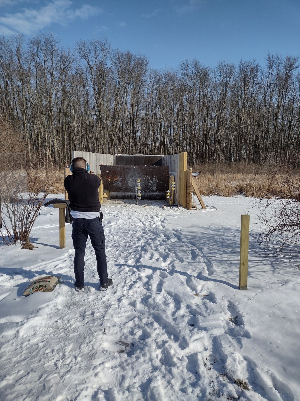

This is what I setup this past summer.
Wasn't cheap, but works year round, enjoyable to build.
The tiltable center plate is 3/8" AR500. Fragmented rounds are directed down to a 1/4" AR500 then into a bed of sand.
Barely visible to the left of the shooter is piece of 3/8" acrylic if a spectator or coach want's to observe the shooter.
Always wear eyes and ears, the acrylic stations also work where people talk to each and are perpendicular to the backstop.
Can't fix lapse in judgement
Under that white stuff is a poured concrete sidewalk, so even in swampy wintry conditions, nobody stands in mud.
I'll finish the shooting tables in the spring. My daughter is a LEO, so I figured the more we shoot, the better off she will be.
